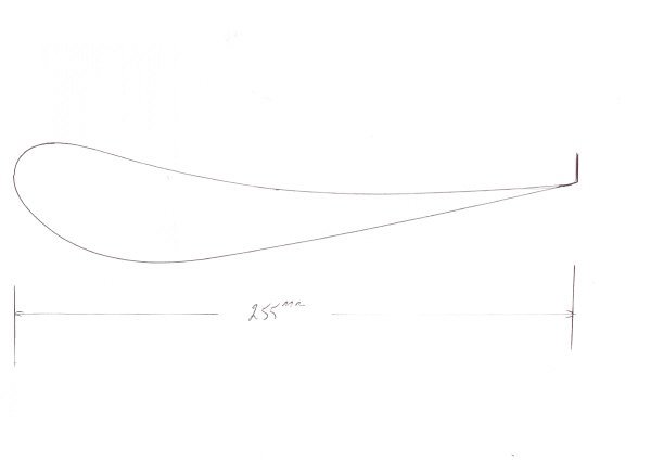

To keep this DIY I'm pretty limited as to what main profiles are available. The profile below is different to the one in McBeath's book and to the Eppler 423 but I'm thinking it may work well with the second elements that are available to me. Without the Gurney of course. -

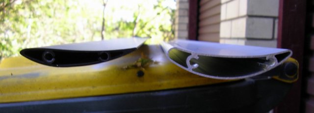

Moving right along, pic below of the two second elements that I have, which one would be best? Had a look at the Eppler 423 Cary, yes. -
