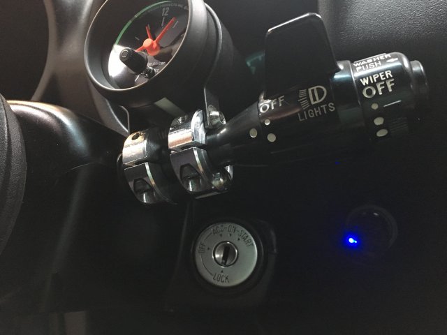

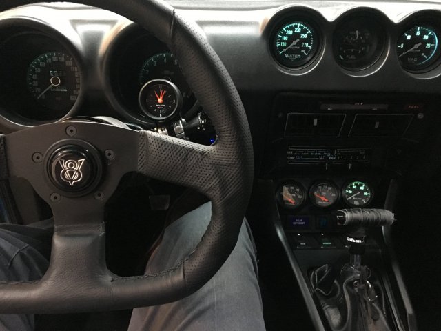

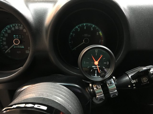

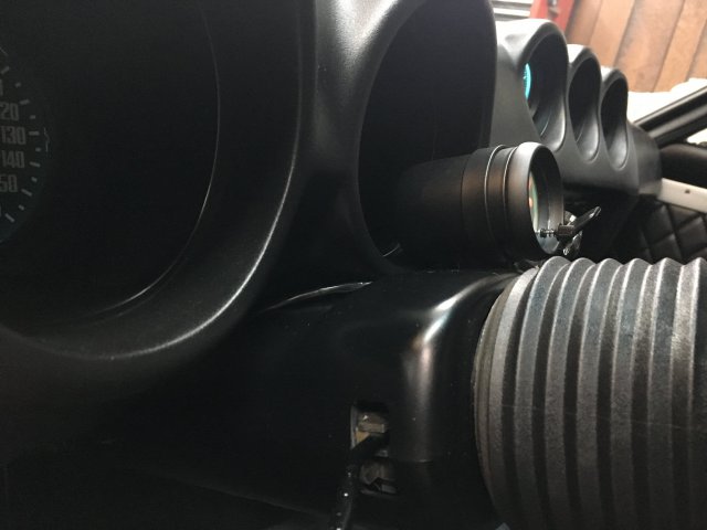

  4. I wanted to add one more gauge and didn’t want to add pillar pods. This option works great and does not require cutting or drilling into factory parts.

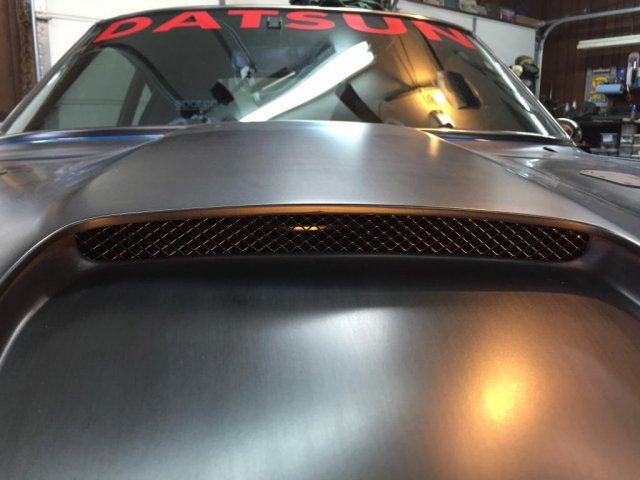

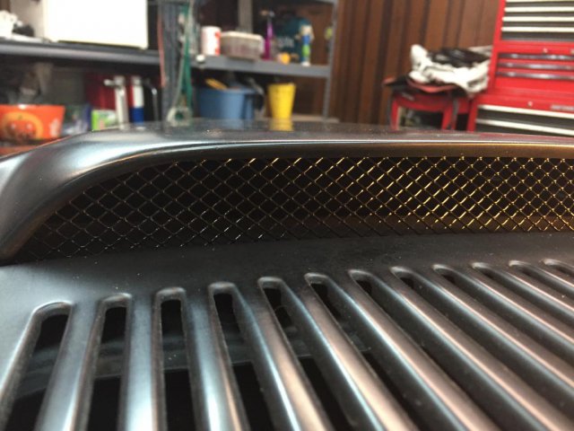

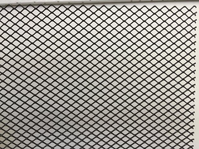

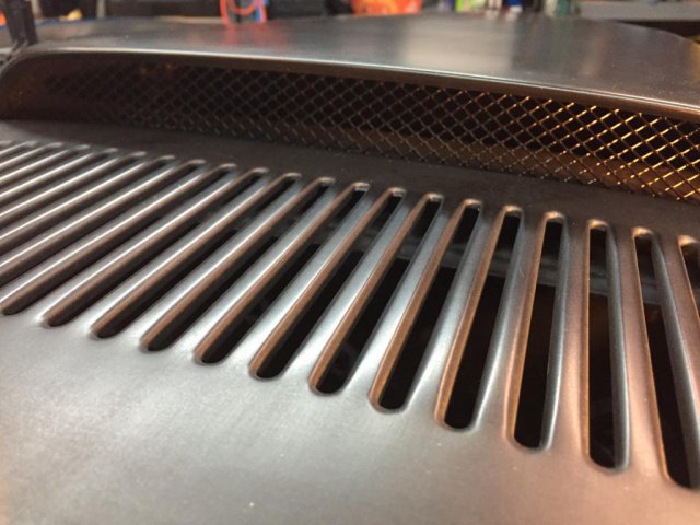

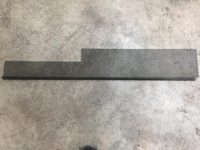

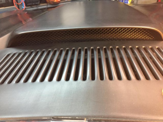

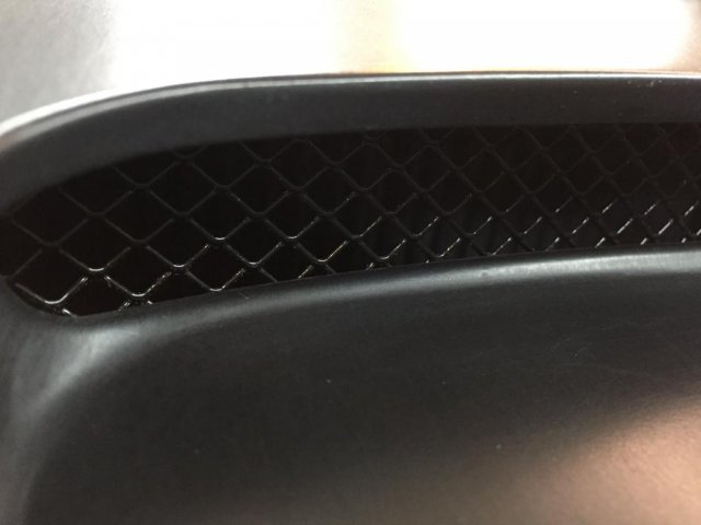

  12. Posting to let everyone know of a very cheap option for grill screen or any opening you want to dress up or keep debris out. I used a gutter screen from Lowes to make a mini grill for the front opening in my hood. The screen is soft enough to easily shape and strong enough to be functional. It is even powder coated gloss black. Details in the attached pictures. Two pieces would make a nice grill. One above the bumper and one below. Note: The picture of the full piece is missing the piece I used for the hood.

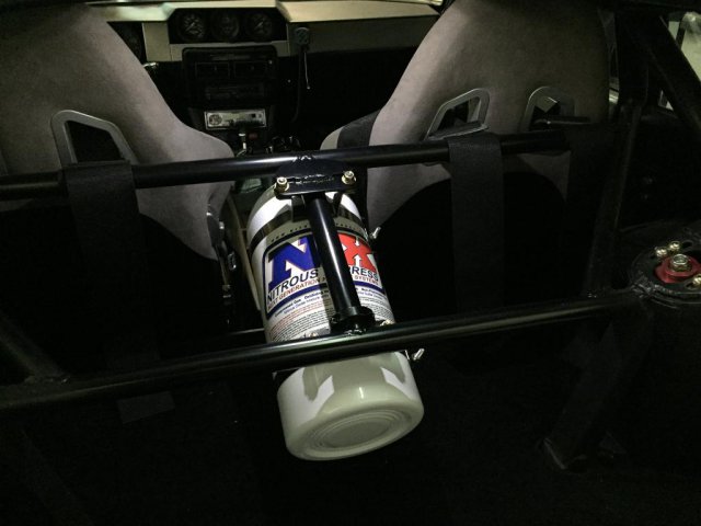

  19. Allows for easy access to bottle valve and visibility of the gauge. Make sure you run the blowoff (vent) tube through the floorboard.

  24. An Auto Meter Direct-Fit Dash Gauge Panel 15021 can be used to add 3 - 2-1/16" gauges where the current radio resides. Trim (sand) the sides to match the angle on the center console and you are set.
