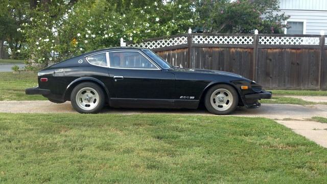

  8. Car looks GREAT! I would drop mine alittle more like your's if the roads were nicer around here.

  11. They are 15x10 4.5 backspace with 225x50 tires
  12. i was out for a drive and decided to take a couple crappy cell phone pics.
