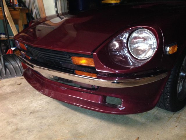

Bumper received in good quality well packaged in double box Chrome looks very good , Manufacured recently Fits very well on 1978 280z Box is marked long motor, maybe someone knows if that is the same product that others are selling I made my own brackets from 2 inch plate steel that i bought at the hardware store for 7 dollars two 4.5 inch L brackets and two 9 inch straight brackets

MSA has recently listed 240 z chrome bumpers with no rubber( euro style) for $399 and there sale gives free shipping I have ordered and will be installing on 1978 280z I will let you know how they fit.

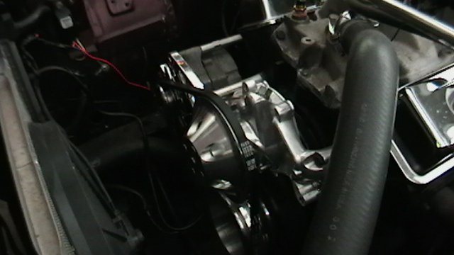

I had the stock chevy system and it was out of alignment, this set is perfect and very quiet. The water pump and pulleys came from skip white performance, Aluminum polished high po water pump $89 and the pulleys about $30 each plus they sell HEI dist. High output units complete with cap and coil for $39 ! The mid mount bracket for the alternator came from billet industries they where the only one i can find that make the mid mount passenger side.
