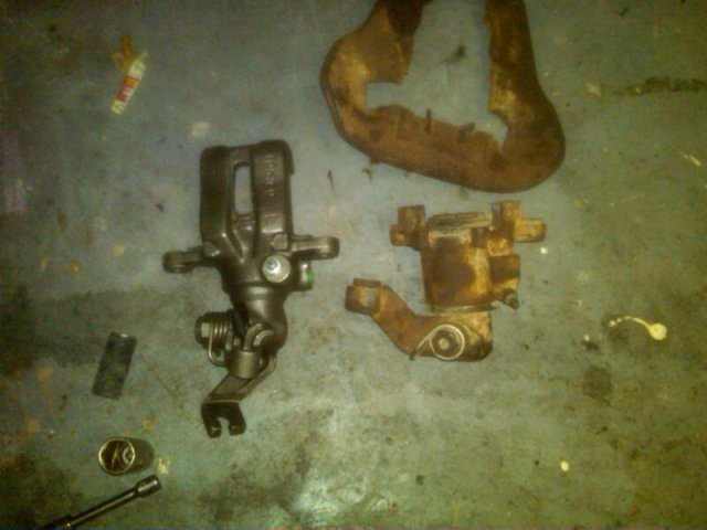

	  Stuck doing 280zx disc conversionBen's Z replied to Ben's Z's topic in Brakes, Wheels, Suspension and Chassis Ok so Cardone has a part number with the bracket. I think I am going to order a 1983 right rear caliper with bracket, because for the swap the right rear 83 caliper goes on the left side of my 77. Is the mounting bracket going to work though? Essentially I need a left rear mounting bracket only.
	  Stuck doing 280zx disc conversionBen's Z replied to Ben's Z's topic in Brakes, Wheels, Suspension and Chassis I know they are for 280zx that is why I bought them. Any ideas why I would have the correct brakes on the passenger side but not the drivers side on my '83 parts car?
	I have read countless threads about this swap... I bought 1983 A1 Cardone reman calipers left and right with Beck Arnley pads, caliper part #'s 19-566 & 19-567. I have a 1983 turbo parts car I was going to use the mounting brackets for. I took off both side and the drivers side had this huge steel bracket. The mounting bracket itself appears to be part of the rear hub assembly. The parts car on the right side has what appears to be the correct caliper bracket I need. I am using Z race products hub brackets. Here is the picture I took of the left Cardone caliper, the caliper I pulled off my parts car and that large steel bracket. What am I doing wrong, and what do I need to do to fix this.

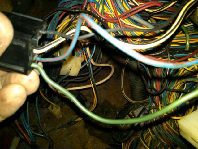

	I have a 77 280z, it should have a relay already right? So do I even need that green relay and the plug?
	Yes I am talking about any and all wires that go behind that black panel into the car by the passenger kick panel.
	Looking at that I must be over on the ignition side of things. I am dealing with items underneath the passenger dash where the rubber grommet passes through the firewall.
	How many wires go to the plug for that green relay up under the passenger side of the dash? Some of the wires do go through the firewall, other go to the main harness and disappear. Here is a picture of the plug and the wires. This went to the green relay. I already snipped a larger wire that "Y'ed" off to somewhere else from another green wire.
	No these are on the passenger side intermingled with the green relay for the EFI. Here is how I started. I unplugged the 3 plugs going into the ECU by the drivers kick panel. I then broke all the clips loose on the driver side wheel well and disconnected all the injectors and marked their corresponding locations. I unbolted 2 or 3 ground wires to the manifold, two round plugs going somewhere down towards the front of the engine and some other what I believe are cold start/emissions plugs. I then worked my way over underneath the hood latch on the fire wall to some relay or something over behind the front right strut tower. Those lead to the hole in the inner fender to the hole in the firewall, and that is where I am at. I also disconnected some wires off of the starter.
	It is as though this part of the harness with what I believe has 3 wires in intertwined with the rest of the body harness. Basically I want to know if it is ok to start snipping other wires besides those to pull the wires through to the engine bay through the inner fender.
	I am trying and have spent the last 2 hours of my life trying to get the green efi relay harness through this cluster f*ck of wiring on the passenger side of this 83 turbo... I cannot for the life me get this harness out through this mess of other wiring. I feel like taking my hedge clippers to the other wiring. I have pulled off the fender, I took out the blower motor housing, there are just so many wires. There are all of these other white thicker wires going through the hole in the fire wall. What do I need to do?
