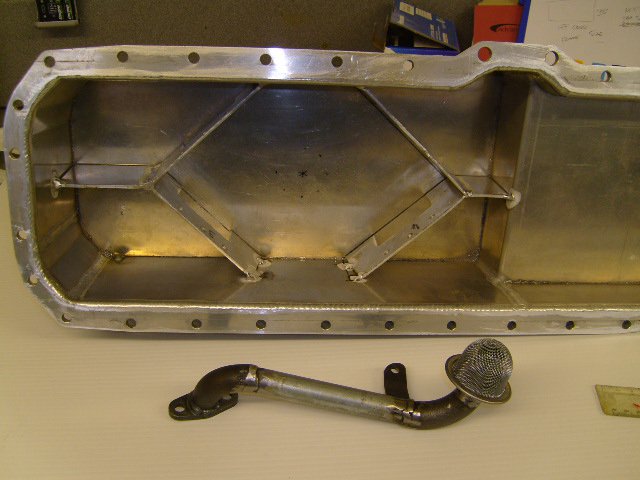

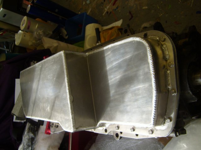

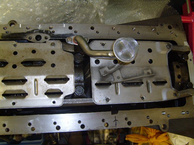

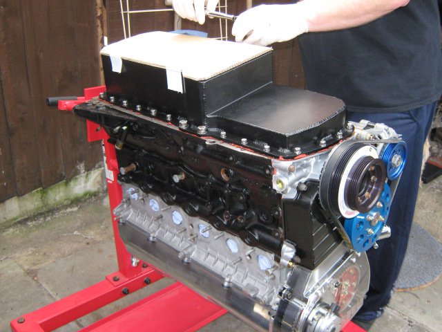

  3. When you had your original sump can you remember the amount of oil used to fill ?
  4. Thats what i thought so was asking other members that are using the Thargard sump. Dave
  5. Hello i have a Thargard sump in my RB26 240z what amount of oil will it take ? as am very close to starting up. Thanks Dave

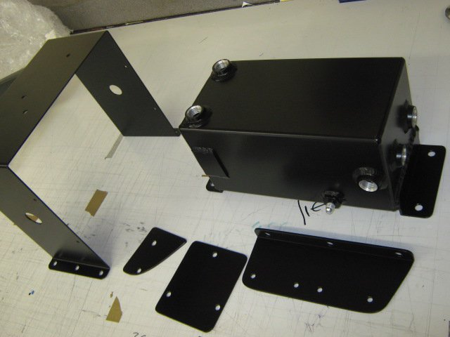

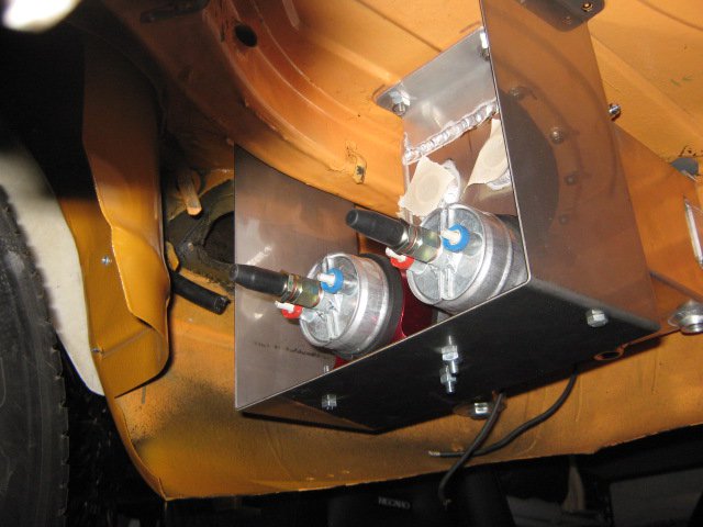

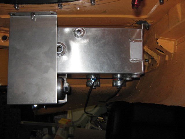

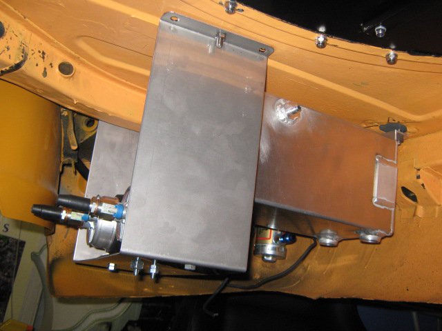

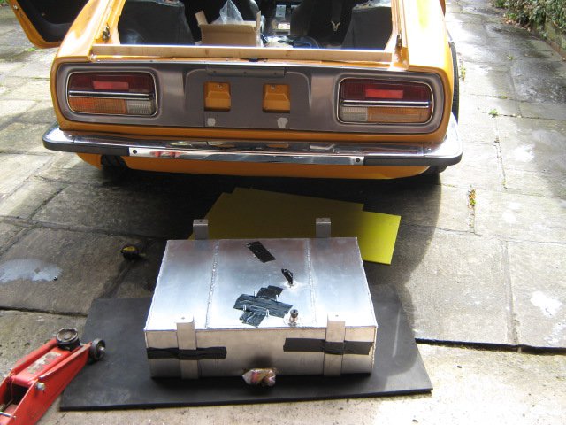

  6. Surge tank looking good just one point i had to buy a second bigger surge tank a 4 litre unit as i also have a twin pump set up and was worried about under full throttle i would run the smaller unit dry. Pictures of my new set up.

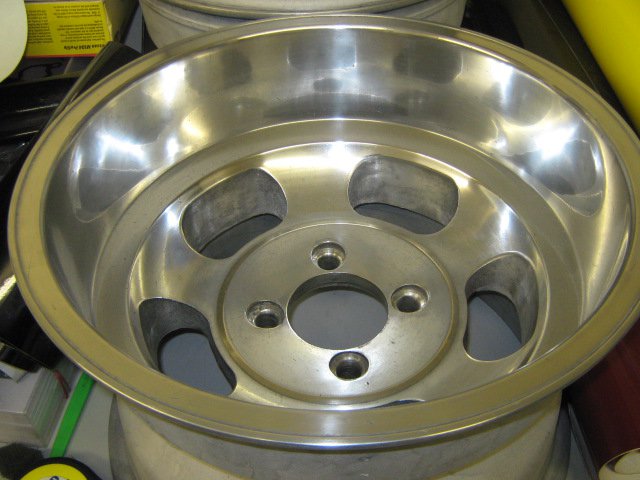

  8. Thanks for the comment wheels are Watanabe RS R-TYPE 16 x 8.5 with a 225 50 16 tyre on the front rears are 16 x 9.5 and a 255 50 16 tyre on standard size ZG overfenders I also will be running a track day wheel and tyre set up with 15 x 8.5 on the fronts and 15 x 10 rears with racing tyres.

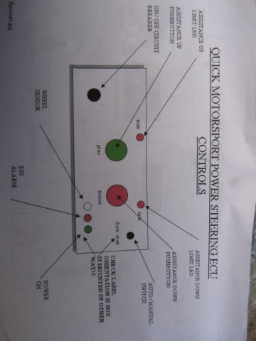

  9. Not a problem here to help out best to remove small bits at first to get the correct angle.

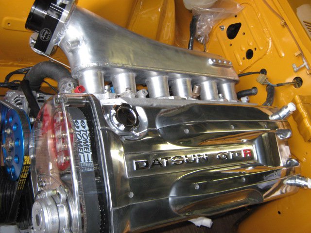

  10. Thanks very easy job to do i bought the chrome letters from a local car spares shop they come with a double sided tape to the rear side, all i did was cover the letter R in a red vinyl to give it a Nissan badge look and had the cover polished and stuck them down. Can post a step by step guide if you want up on the forum ?

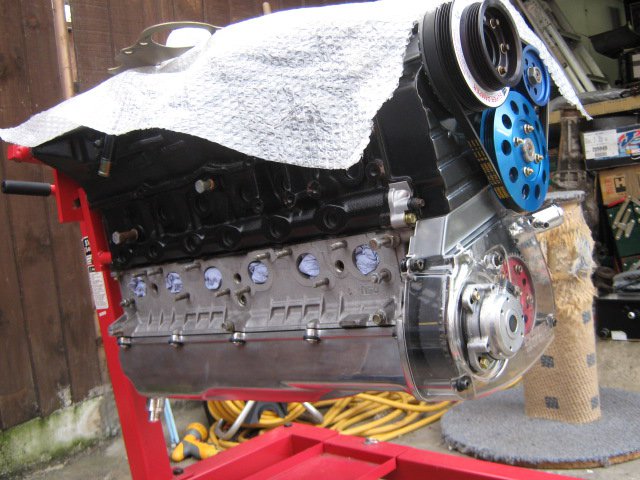

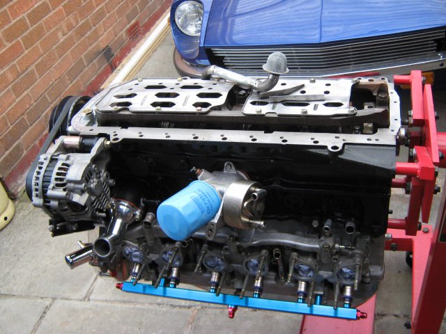

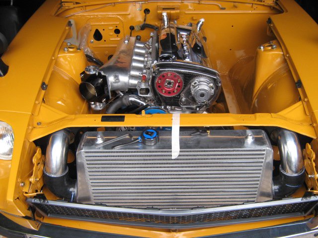

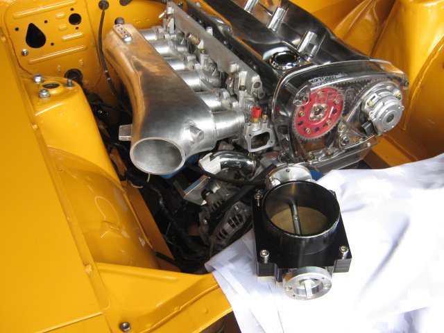

  11. Pictures of my inlet manifold before and after.

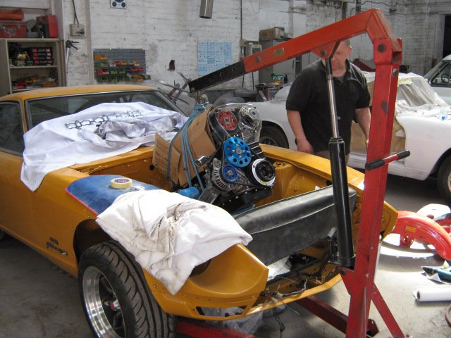

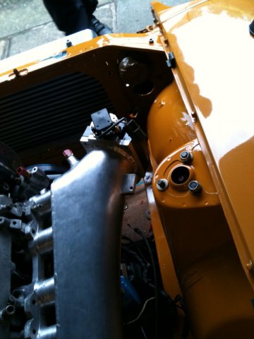

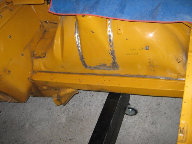

  12. Yes taken about a 1" mellon slice out off the plemium and welded the flange back on this takes it away from the inner wing and now it now points to the large hole in the rad support pannel will post up some pictures tomorrow.
  13. Great progress i have the same intake manifold i found that it was to close to the inner wing and had to cut it about to make it fit better.

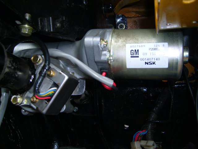

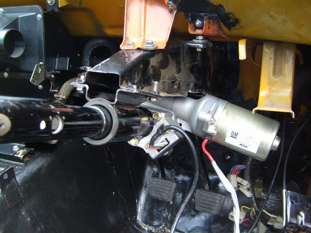

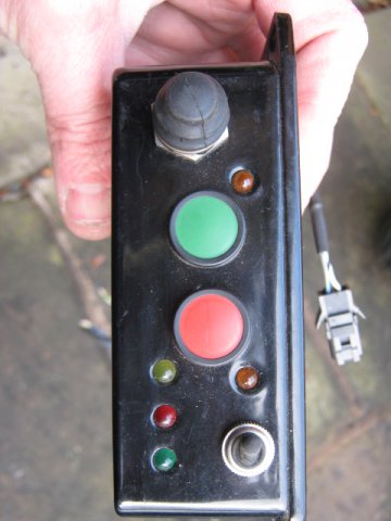

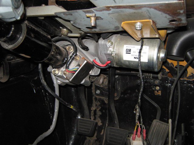

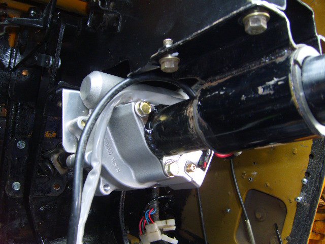

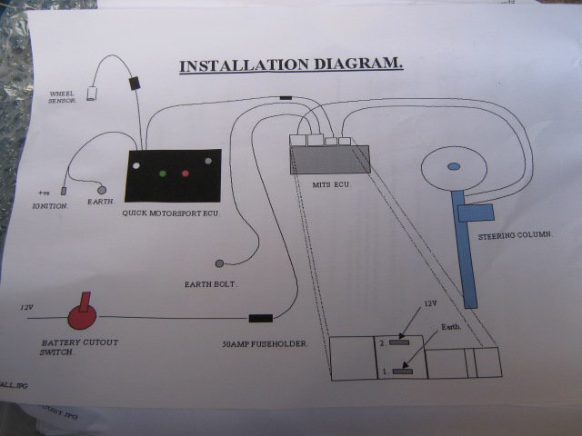

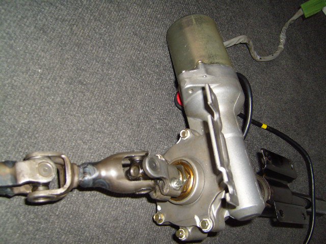

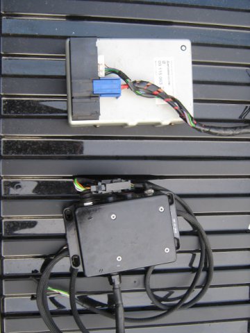

  17. Pictures of the steering unit ECU and control box have also taken a picture of the installation diagram/layout and the control box functions if you need some more info please let me know i am going to talk with the chap that built it all for me to see if he will make some more and what the $ will be.
  18. I will dig out what it cost me and also add some pictures of the control unit.
  19. Thanks for the reply yes lots of $ invested in the car and RB swop lucky for me all my mates have helped me out on the project.

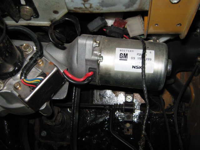

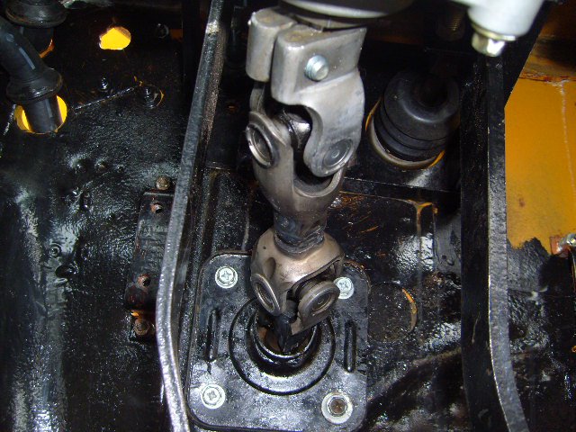

  20. Here are some more pictures of the electric power steering unit.
  21. Kit was made here in the UK by a Z specialist it all bolts into the pedal box and is hidden from sight all you can see is the control box, i will post up so more pictures of the kit.
