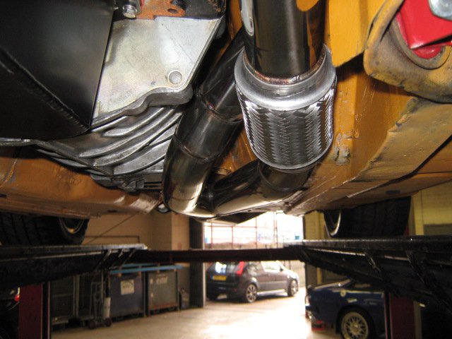

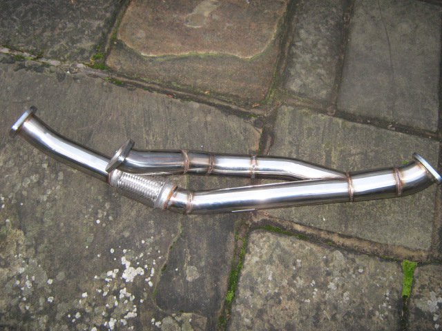

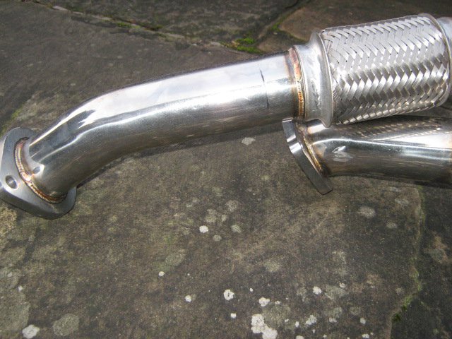

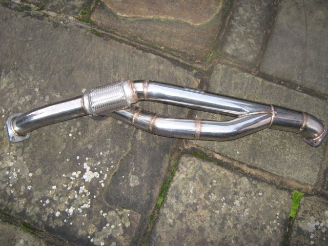

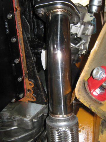

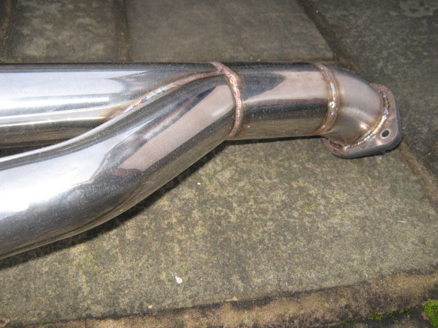

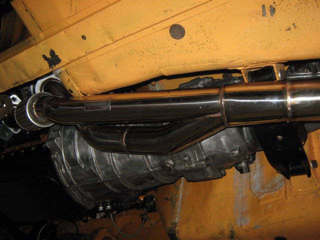

	Here you go pictures of my XS downpipe thats been modified by the exhaust shop to fit my 240z, the original one hangs down do low and we had problems loading the car onto the car trailer to take it to have the stainless exhaust made. We also have a RB26 240z in the Manchester area he is also using a modified XS downpipe for the last 5 years with NO problems. So with a FREE XS downpipe it only stands me at £80.00 to have it modified.
	Mine was a cheep XS item it came with the elbows and was $100 shipped to the UK, i sold the elbows for $100 so the downpipe was FREE, when i had the exhaust system made he used the XS downpipe that i supplied and with a few mods to make it fit, if it brakes i can always use it as a template for a new one. Its in my workshop and off the car i will take some pictures and post them up as the quality looks OK to me i am sure that if it was that bad the exhaust workshop would have not used it.

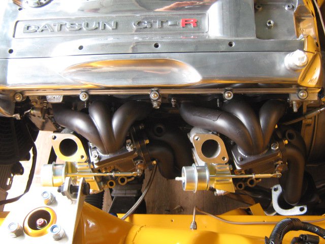

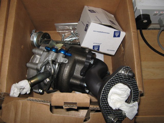

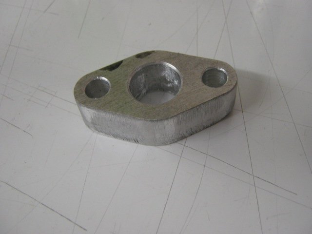

	Got the oil drain spacer now and its all fitted onto the turbo just waiting now for my mate to come over and refit them. If you are buying a set of Garrett GT2860 Turbos i had to have 15 spacers made up so have some for sale PM me if you want one.

	The Garrett GT2860-5 turbos are rated at 360hp per turbo so should support 700hp with all the right kit attached BUT as always the proof will be told on the drag strip or on a Dyno.

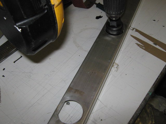

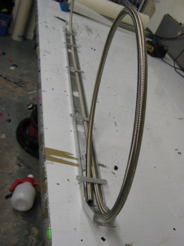

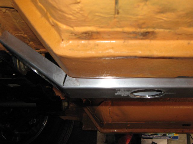

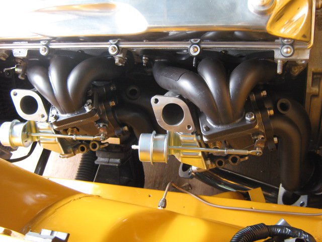

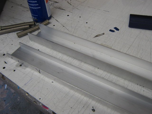

	Small update finding it hard to spend time on the car with work. I had to have a 15mm alloy spacer made for the front new Garret GT2860-5 turbo as the original oil drain pipe was hitting the housing not allowing it to sit correct. With running 3 AN-6 braided fuel lines (2 feed to the fuel rail and 1 return) i was unhappy with them in the gearbox tunnel so i have made a fuel line box from some 50mm x 50mm alloy box section for the 3 fuel lines to run in and it will sit under the car.

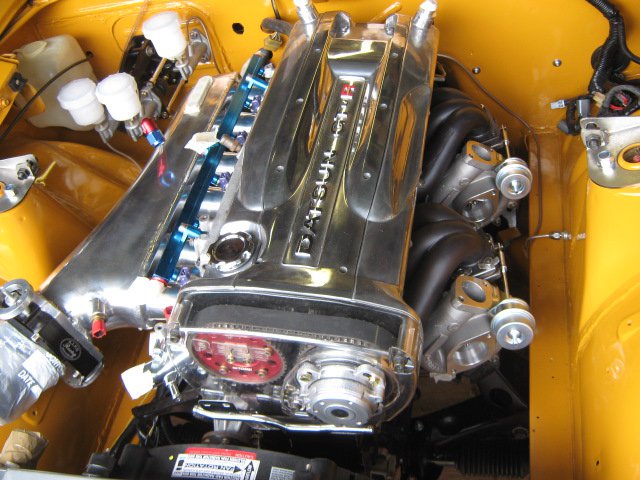

Great looking car some more engine bay pictures please. -

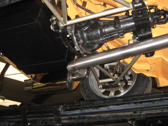

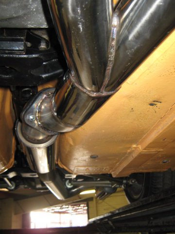

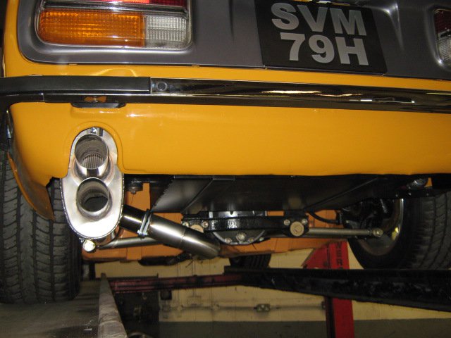

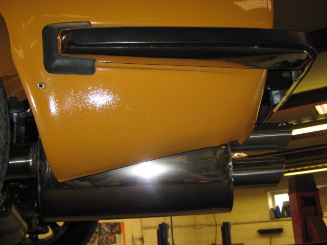

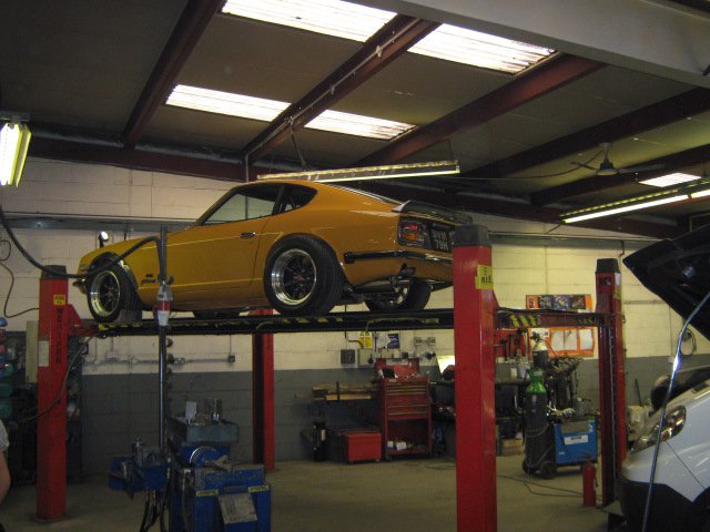

	Picked the car up today from the exhaust shop they have done a fantastic job and the whole stainless system fits like a glove and is nice and tight against the car.

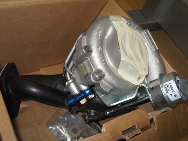

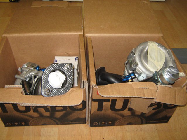

	Bought some new turbos a set of GT2860-5 that are now installed my Nissan 200sx R200 diff is also fitted and car is going off this week to have a full stainless system made. Will post up some new pictures later on in the week when I get the Z back.
