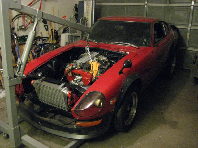

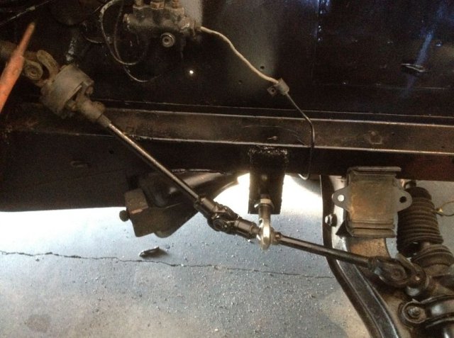

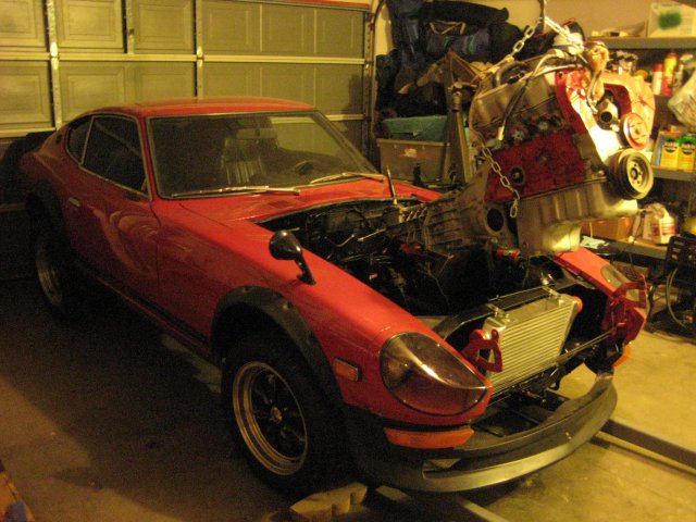

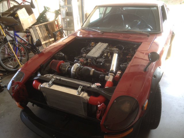

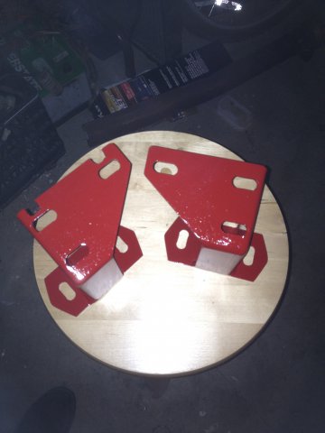

  1. Hello all Im finally posting some documentation of my buddy's 72 S30 VG33 turbo swap. Well it all started when he calls me up one day telling me he's pulling a vg30 out of our local pick a part yard and wants to swap it into the Z. We tore the engine all down had it bored and built it all back up ready to boost again! We set the engine and trans in the car to figure out how to make our mounts. At that point we realized the turbo was going to interfere with the steering shaft, so he cut and jointed it to accommodate. Well as we sat around throwing different ideas back and forth he starts talking about custom headers. 2 days later I come back over and he's made custom headers and front mounted a gt35 turbo. Luckily with the steering shaft out of the way it fit a nice 3" downpipe straight out. There's still a few things to finish up and we're waiting on a harness but here's where the cars at so far.
