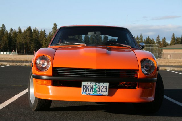

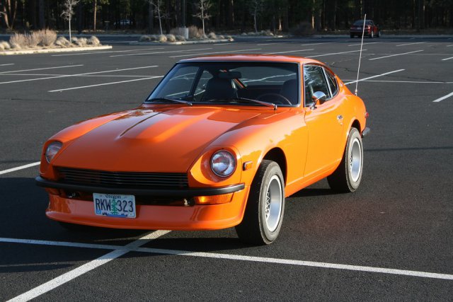

Here are some photos of my orange 72 Z. This orange changes depending on the angle of the light source. It is about three years old now. The car was originally white with red interior. I am the second owner, I have all the original paper work including the dealers window sticker. The original owner hit a jackpot in Reno and promptly went to the Datsun dealer in Reno and purchased it. Those are the wheels she had the dealer put on it.

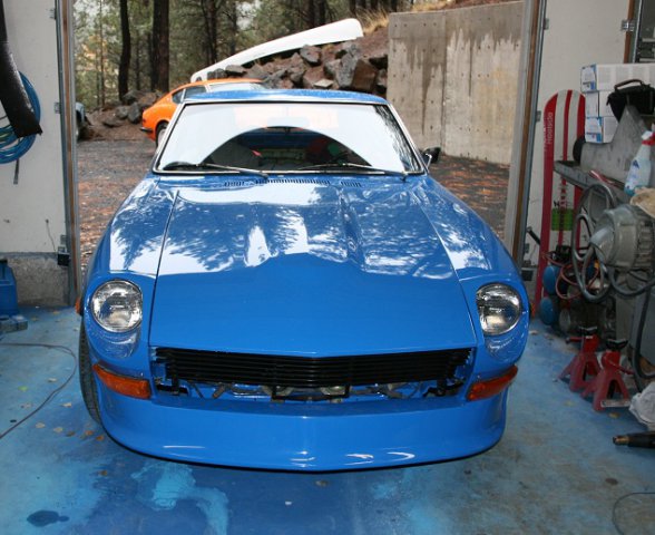

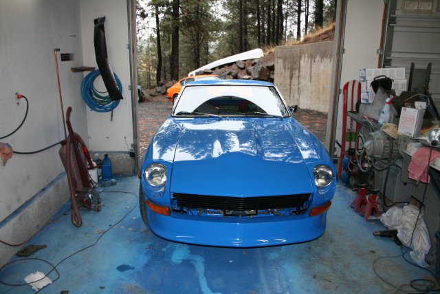

My boy and I painted his 240 with R-M UNO-HD a two part single stage paint over PPG primer D822. This was our first paint job and we were very happy with how it went and the end result. Very high gloss and after two years outside in the rain of the Willamette Valley it still looks like new.

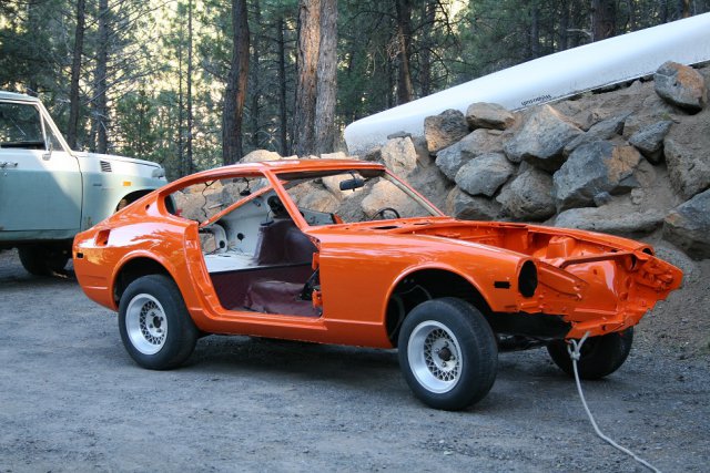

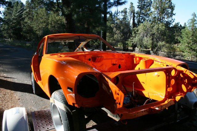

I am a newbie to the site. Not sure how this work but here goes. I have two 72s. The orange one I bought from the original owner who bought it in Reno after winning a big jackpot. It had sat in in a field for 12 years. The blue one is really my older boys, but I get to babysit it. We did all the work on the orange except the color coat. We did everything on the blue. We I mean my two boys and I. Both are away in college now. The younger boy is great metal worker, there is a lot of new metal in both cars. The older boy did all the priming, sanding, and color on the blue one I just tended the hose and mixed paint.
