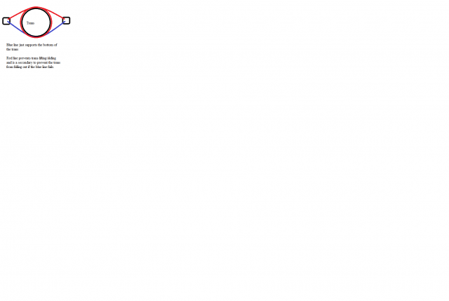

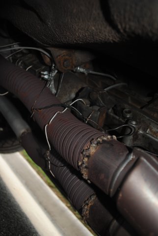

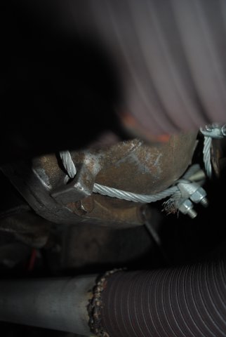

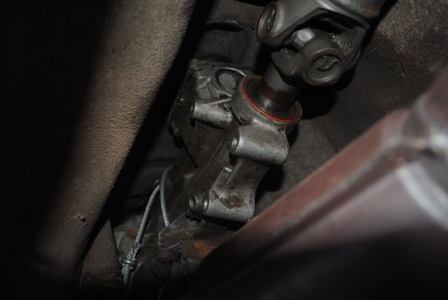

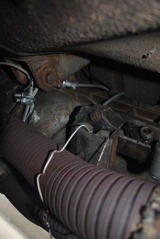

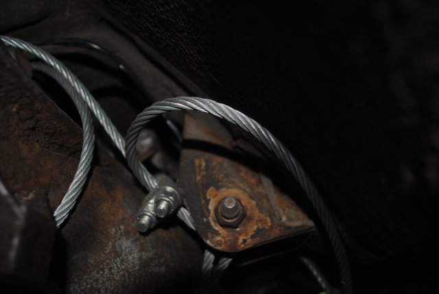

Ok I took some photos, but they are not very good for the exhaust is in the way and I only had time to jack it up. So, I made a diagram! The bottom mount goes from one side, through a hole on the trans, then to the other mount. If trans mounts did anything besides support the weight of the back of the motor and of the trans, then why are the mounts so flimsy? The Ron Tyler diff mount can not use a standard trans mount because it tears it in two on slight engine braking, and look at the stock mount on the T5, that has INCHES of play in it. As for the steel cables, they are pulled taught, it is slightly tricky to get the last bolt in, as you have to have the trans at the exact right height to get the bolt in, and even then you need to angle it in using the closed side of a wrench on the bolt head. There is NO play in this set up. I have kept my hand on the shifter, reved to 3k, and dumped the clutch. No movement was felt in the trans. The professional rigger that made this mount said that the cables used where strong enough to lift the entire car up by several orders of magnitude. Pros: saves weight Adjustable Easy to make, no welding required (this was the biggie, as I was just learning to weld and I did not trust myself to make a mount that would hold) Cons: Some guys can think that it is unsafe because it uses cable. It is slightly harder to line up the last bolt than with a standard trans mount. The ends of the cables are sharp. You have to toy with it to get the cables as tight as possible while setting up the mount (once set up you don't need this when dropping/reinstalling the trans), and this can be difficult if you are alone. (need someone to pull the cable tight while the other puts the clamps on) Nice time machine. I did not know about that movie till I watched Big Bang Theory. EDIT: Again, I know the welds on the exhaust are beyond terrible. It was the first thing I welded and the wirefeed welder I was using kept jamming up/feeding at an inconsistent rate. It is only there until I can afford to get a real exhaust made (and yes I should cover up the speedo cable port) -

I am using a t5. I did not have to widen the trans tunnel, nor did I have to cut out the stock trans mounting brackets. To support the trans I had a professional rigger from the Kennedy center who is also a Z car guy make me some mounts out of steel cable. No movement from the sides, very adjustable in height. I have no drive line noise or vibrations. I can take some pictures if people desire. This set up has about 500 hard miles on it so far, and I could not be happier with it. -
