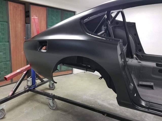

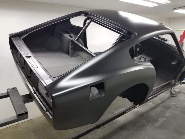

	Final top coat done over the lizard skin to get it darker and protect it a little bit. The body is in primer but no sanding on it yet. Not until its ready for final paint and assembly. She is finally ready to go to a new temporary home where we can turn it into a car. Will be nice as I can help work a fair bit more on the mechanical side of things.
	You probably follow Langesshop? That's Chris the man doing basically 100% of the body and paint work

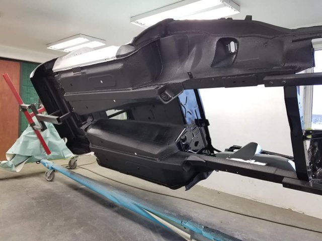

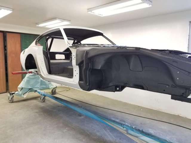

	Sound and heat insulation where it counts. Probably going to do a semi gloss black top coat for the underside of the car just to make sure none of the grey is visible.
