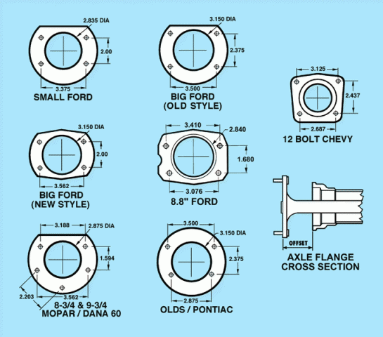

I am having a fellow ranger owner look at his 8.8 tomorrow morning! I am pretty excited for this is looking like we almost have a direct fit. -

I attempted to check the bolt pattern on the explorer axle and I could not get an exact measurement but It looks close. Vertical holes Approx 2 1/4, Horizontal holes 3 3/4. Ill try to double check with some fellow ford guys on the Ford Ranger website. -

Nice, this makes things quicker. Ill measure my Explorer axle bolts in about an hour. this is looking pretty close. It would be nice if we could find a rotor with a proper hat and lug pattern. -

Yeah look at this representation of the Z setup. crazy huh? I am going to have to do some measurements. Again, what do you guys think? -
My '76 280Z has been sitting for 14 years and is in need of a brake system overhaul so i figure, why not upgrade to a newer system? I am definitely going with the toyota 4 piston setup in the front, but i am unsure of what to do for the rear. I stumbled upon this setup that could possibly work. Look at the picture this looks really close to the Z mounting setup for the Drum brake hardware. What do you guys think? I am going to take measurements because i have both examples at home. I am sure the backing plate will need to be drilled, but it would be totally worth it.
