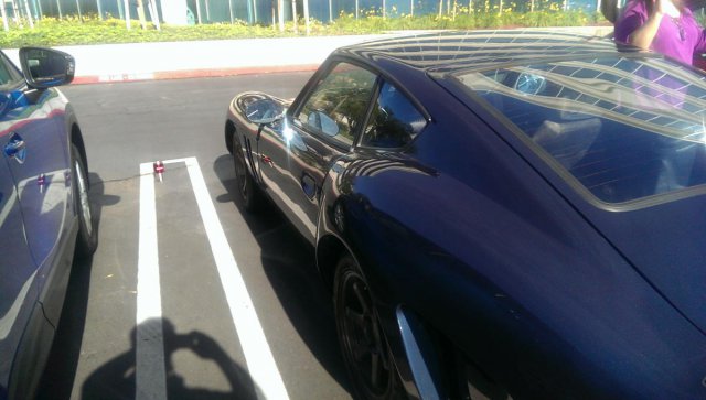

The mirrors are Miata manual units. The looked fairly good with the original body lines and quite good on the VR. I mounted them about an inch too far forward and did not catch that until after all body work and paint was done. That does not impact the drivers but made the passenger side have limited usable range. I would not hesitate to install them again, especially if I could find a new pair at a good price. I daily drive it and could not tolerate losing any visibility, so keeping the windows was a purely practical decision, but I do like the way it looks with the blacked out window frames. I catch people staring at it several times a week, usually with appreciating nods, thumbs-up and a lot of 'what the heck is that?' -

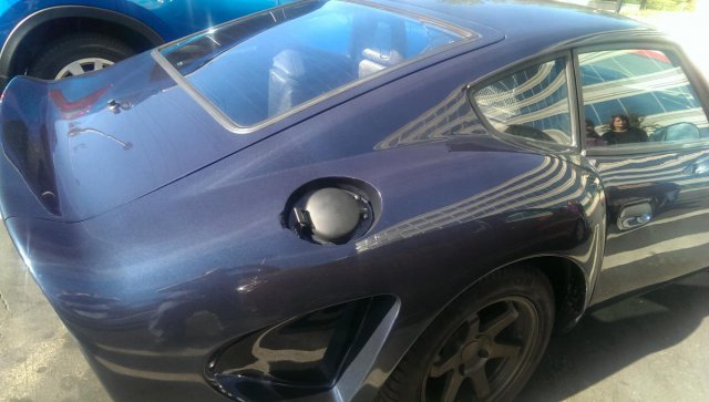

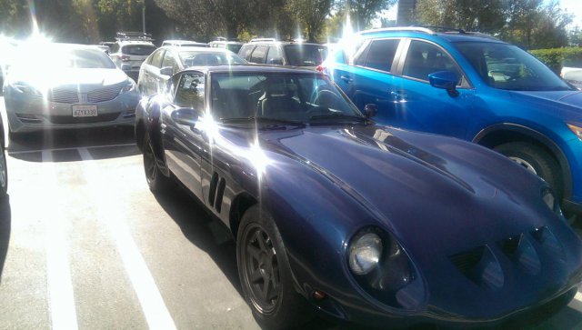

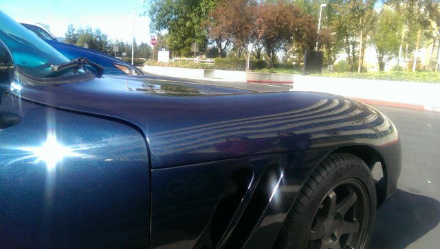

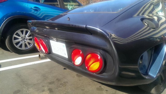

A few more shots with natural lighting- Now for some boost tuning and hunting for a pair of Varstoen 17X9.5 0 offset for the rear, since the 16X8 wheels are tiny in the rear arches... -

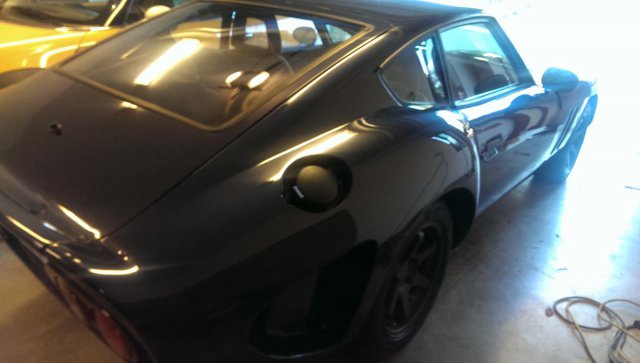

After a couple weeks of 'it will be ready tomorrow', she finally came home. I had hoped to take delivery on Saturday to make the BBQ on Sunday, but that did not happen. It was finally ready yesterday, and I only found a couple minor tweaks that they agreed to tackle at a later date. Sadly they had left the lights on at some point and my 2 year old red top would not take a charge. So I asked them to address the small items and try an overnight charge. The charge failed, and the O'Reillys next door could not find the warranty when I called and when the paint guy tried to swap it. Luckily they did find it when I took the battery in, so I could actually use the car when I got home. Sadly I lost the light by time I got home, so these poorly light garage shots are the best I can do for now- All exposed trim was painted matte black While happy with how most of it looks, I loved how the LeMans cap turned out. -

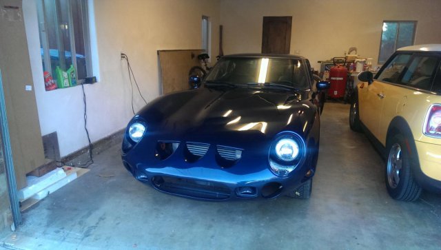

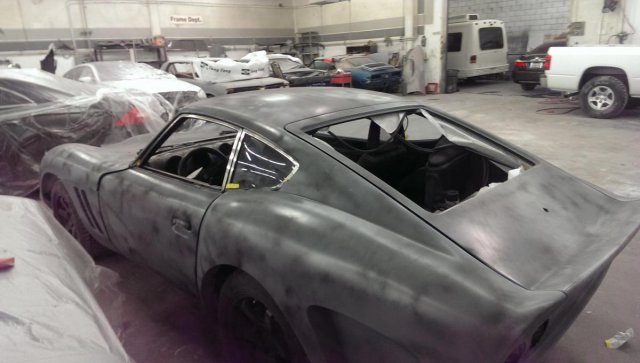

I've made a couple trips to check progress. The first was not picture worthy but today's was. I am still a week away from picking it up, and I suspect I will need at least one more visit to check the small parts to confirm all the polished bits get painted black. I asked them to build up the rockers to blend the tub, door skins and the cheek panels, which I think they nailed: I went over the spoiler and tub looking for seams and uneven transitions, and was pleased I could not tell where metal meet glass... -

I took the body work as far as I could and dropped it off for paint six weeks ago. The plan was four weeks in the shop while I was travelling for work, but the schedule slipped. I hope to pick it up by the end of this week. The shop agreed to create new rocker panels to blend the front and rear fenders, and to clean up my tail light pods. They also will be etching and painting black all the polished trim and door handles. I negotiated colors with the missus and we agreed on Ferrari Pozzi Blue. I wanted to downplay the Ferrari connection, but that is one sweet color. Near black in low light and shifting shades of blue in sunlight, which should look good with blacked out trim. If the shop does not finish up as planned I will be al least doing a progress inspection and grabbing photos at that time.
