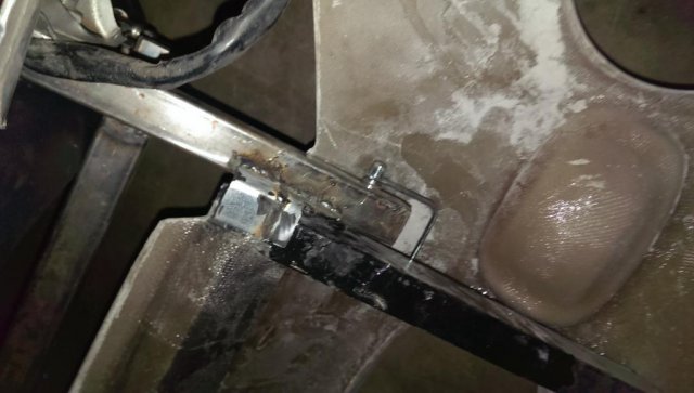

  5. A few more small items knocked off the list. I borrowed a welder and finished tacking the trimmed rear wheel arches. I also welded in the hood stop. The welds look better than the photo, and I really did not care to make them pretty. While I have the front end apart I finished mounting the idle valve and plumbing it and the valve cover breather into the cold air intake track. I found my headlights were canted a bit, despite trying to ensure the buckets went in level. Instead of cutting up the fiberglass I opened up the notches the buckets. Not that I have the lights in I can see that I did have the relay wire up correctly, so that is another item crossed off. The one other item handled so far is cutting in the Quik Latch Minis. I ran a 1/4-20 tap down the original hood bumper mounts and used a 3"4 hole saw (very slowly to avoid splintering) The nut for the latch did not feel right when tightened on the fiberglass, so I cut out a couple of 1.5"X3" tin strips and drilled those to be large washers. The latches are nice and tight, and if they do not hold well enough, I can also step up to the full size Quick Latch, I just wish they have a size in between the mini and full. I picked up a gallon of Kevlar reinforced body putty and will be bonding the tub tomorrow morning. If that goes well I may do the doors too. I am debating removing the doors and laying them flat to make the panel easier to install, although that will make it harder to tweak the panel alignment, so maybe they will be bonded on the car...

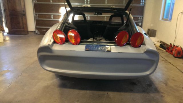

  7. The hinge arrived on Thursday, but I have not even opened the box yet. I moved our corporate HQ last weekend and the local Telco managed to bork my WAN and internet deliveries., so no free time to play. Those problems were resolved yesterday, so the hood goes on tomorrow and bonding is likely next weekend. I am fairly happy with the pods. If the local TAP Plastics is done remodeling I will pick up some 3oz fabric and try my hand at covering them, otherwise I plan to see if a local custom stereo shop that makes enclosures will accept a non-stereo job.

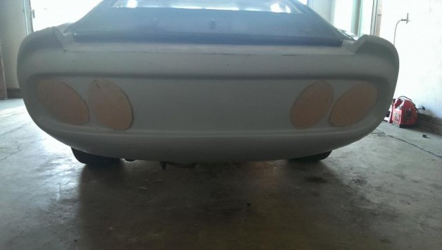

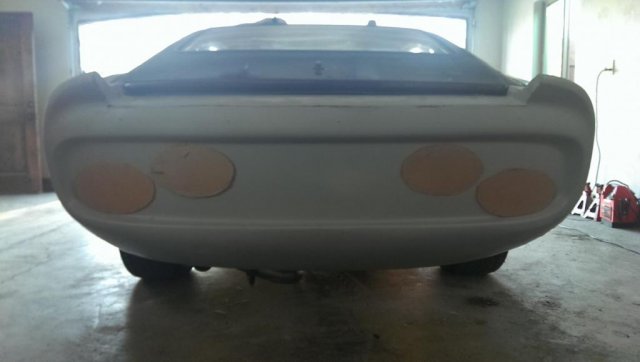

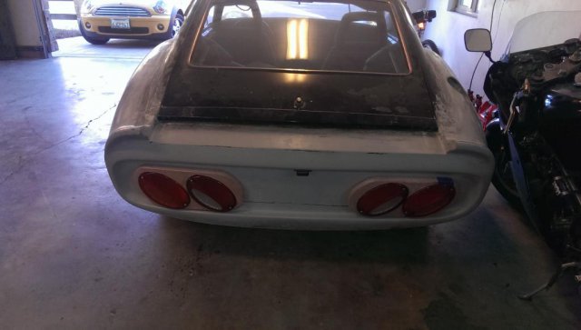

  8. Still waiting for my hood bracket, so I spent the week shaping the tail light pods. Mid-week I placed the shaped, but not sealed/glassed pods and marked out my cuts, last night I took a deep breath and made my initial cuts. The good news is that the pods will completely solve my clearance issues on the passenger side. The bad news is driver side has seen repairs in the past, and is not quite square. I needed to trim the lower valance to make room for the right side turn signal. I have not bonded the tub yet and can remove it to make adjustments for clearance, so this is actually working out nicely. The tub looks intimidating, but I can easily place it and remove it by myself. My first attempt at glassing my pods was just short of a disaster. The shop I bought my epoxy resin from was remodeling and could not cut my desired 3oz woven e-glass, and offered a 'comperable' tape. It did not want to hold a curve and kept pulling away from my carefully carved pods. The 'just short of' was achieved by removing the misbehaving glass before the resin fully hardened. I am now attempting to just resin coat the foam so it is not fragile, and revisit the need to glass it later. Not wanting to end the day on a downer, I finished soldering the tail light harnesses and mounted the lights without the pods- Once I figure out how to finish the pods I can be confident in bonding the tub.

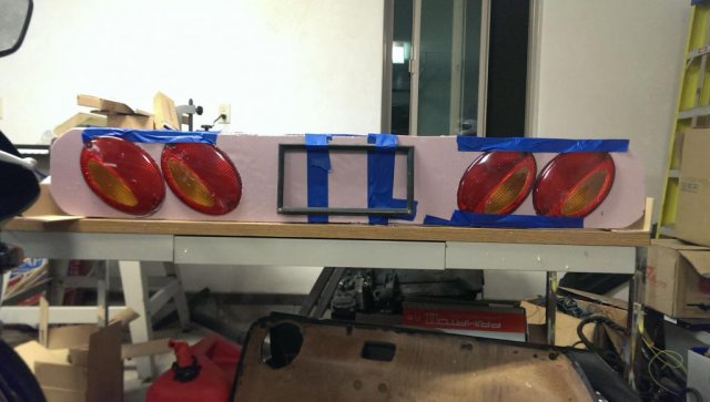

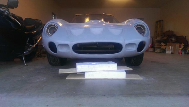

  10. Headlight relay harness complete. The high density foam cuts easy with a fine tooth hacksaw blade and I was able to make curved cuts to follow the lens housing shape. Not as nice as a coping saw, but close enough, and the foam sands nicely. I started by mocking up a full valance to see what it would look like: I like, but do not want to completely fill the void in the valance, so I cut up a couple more 8" high panels, copied the lens holes to the smaller pieces and started shaping the pod curves. I may end up removing a bit of the outer edge to make the pods symmetrical, or maybe not. Once I decide that I need to tackle my first glassing project and cover the foam pods. The pods will solve, or at least greatly improve the clearance issue. Edit- I just notice the tape on the left pod sagged before I got around to taking the picture. That will be corrected before I make any cuts on the tub.
  11. Still waiting on a bracket and a few lights, so not much progress to be made. So I picked up some 2'X2'X1" high density foam panels to sculpt the taillight pods. That project starts tomorrow, after I finish building the headlight relay harness. It has been on my list for a long time, and it made sense to tackle with the front end apart.
  12. My clear euro tail lights arrived yesterday so last night I cut the sockets off one of the factory stub harness and wired up the tail/turn/backup lights and confirmed the wiring scheme. I need to hit the junk yard again for two more tail/brake light pigtails to wire up the second set.

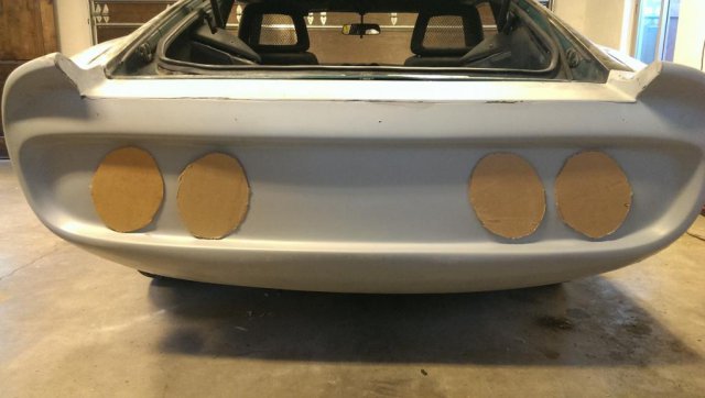

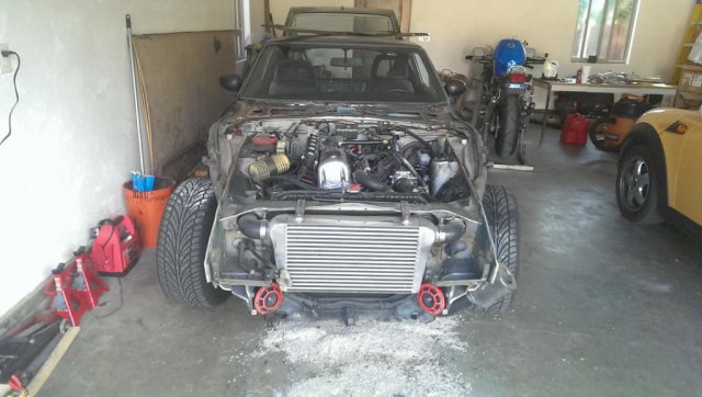

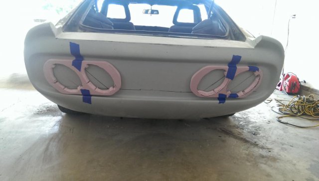

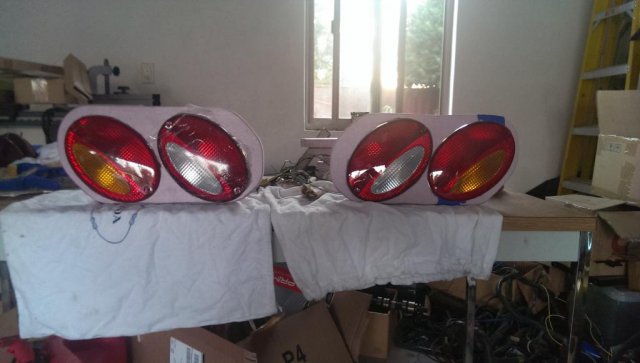

  13. The rear tub is requiring some trimming at the rear to get the front to set down and align with the rocker and door jamb. I just about have it where I think it needs to be, although the arch is covering part of the quarter window trim. I also mocked up a couple more light options- Staggered: Angled out: I really like the staggered, but clearance will be hard, the angled out arrangement is growing on me. I also like it with a slightly shallower angle on the outer lenses, say 30~35 degrees on the outer and 45 degrees on the inner. Finally I placed the lights inside the valance in the angled out setting: This was interesting, although hard to see in the photo, the lights are sitting about 3" too high. The lenses are curved and the peak is about 1/2" to 5/8" from the mount surface, combined with the steep curve in the reflector and the 1/8" thick pocket suggests I will be much close to getting the inside clearance I want. If notching the valance does not yield enough space, I can then move on to relatively short pedestals.

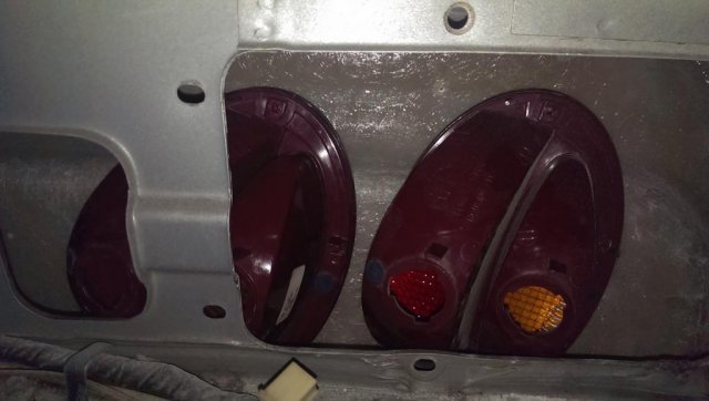

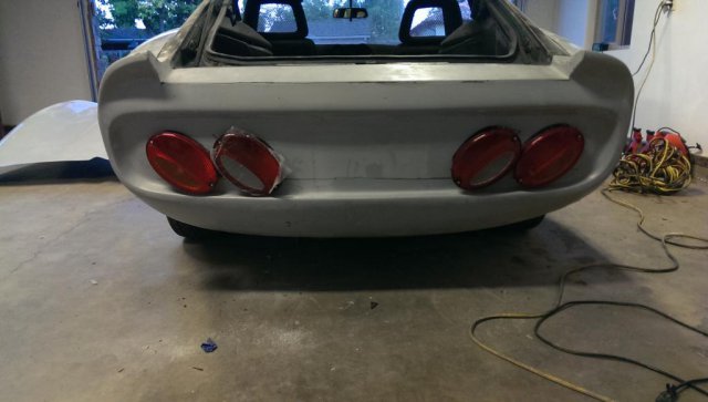

  14. The first delivery of the C5 lights arrived. I found a used set at quite a savings, cheap enough that I only planned to use 2, with 2 spares or two to sell. I have ordered two more with a clear insert that will be my backup lights, which have not been delivered yet I need to decide if I want the secondary lenses on the bottom, top, facing each other or apart. I am thinking that I am on the right track with the angled install. I chopped up a box with the basic shape of the lens, and taped them in place. The missus was calling for dinner, so this was just an eye-balled spacing and tilt. The lenses do not separate from the housing, otherwise I would tape them in place to test the visual appeal. I do tend to think that the angle works better with the tops leaning in, accentuating the wide hips.
  15. That is a little more aggressive than I planned, but it is an option. The housings are fairly shallow, with the central socket 3.5" deep from the mount surface. I had another layout in mind ( _ -- plate --_ ), but that would definitely cause a depth issue. Since I have not bonded my tub yet, I will pick the style I like, install the lights and check the fit. At that point I can decide if I want to do more cutting or make small pedestals.
  16. Another one with missing nub-ins and springs. Pharaohabq has a thread about 3D printing bits we need for these old cars, http://forums.hybridz.org/topic/113544-240z-horn-button-refab/ If that does not work, I may need to study up on plastic casting, there is clearly demand. Not sure where to find the itty-bitty springs, maybe a hobby shop that has a R/C focus.
  17. The lights are scheduled to arrive tomorrow, and I will be checking that very closely. The lights are between 2.5" and 4" deep from memory. I'm playing with a couple designs, the lights a slightly oval, so am thinking to mount them on an angle, which would move their center up ( / / Plate \ \ ) or the basic ( - - plate - - ). A big goal is to maintain access to the bulb sockets from inside, but that seems more and more unlikely.

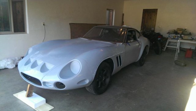

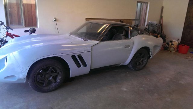

  19. I ordered a coupe kit from Reaction Research 10 days ago and lucked out that John had business in the area yesterday, so I saved I pile on the delivery. Since I knew it was coming, I stripped her down last weekend I could only take a couple of hours for the delivery, so we had to rush the pointers, but I still felt OK to jump in today. John pointed I needed to trim a few brackets, so I had to call a buddy to borrow his angle grinder. He showed up at 2:00 and we shot the breeze for 45 minutes when another friend stopped by unexpected to show the project to his kids. Once every one was gone I got the cheek panels mounted. I managed to get the drivers side right on the first try, but had the passenger set back 5/16" of an inch, which was easy enough to fix. The rear tub was a adventure by my self, but I have it in place as a dry fit, and the door skins taped in place to get a look at the end game. I have just less than four hours in the assembly, which is not a bad start. I need to pick up some duraglass next week and work on wiring harnesses. The bonnet is just resting in place since the hinge did not make it on the truck., so that is a task for after labor day
