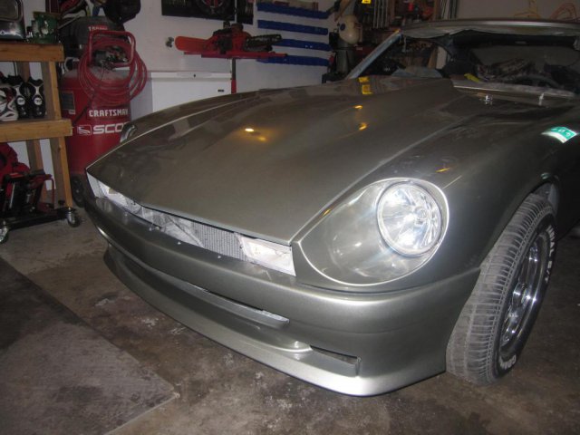

	When I bought the type 2 air-dam and put it on for a test fit, I did not like how far past the hood it went. So I cut approximately 3inches off the sides and shave the top to recess the air dam a little farther. This is how it turned out.

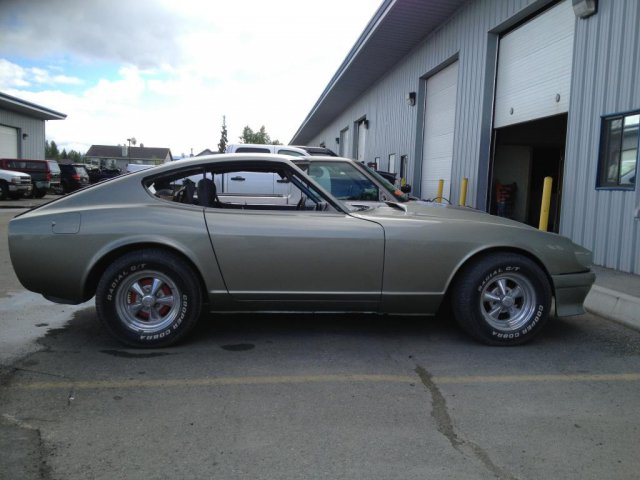

	for the front I got hubs off a 84 300zx turbo. In the rear all I did was that the stub axle and brake drums to a machine shop and had them redrill the pattern to 5/4.5.

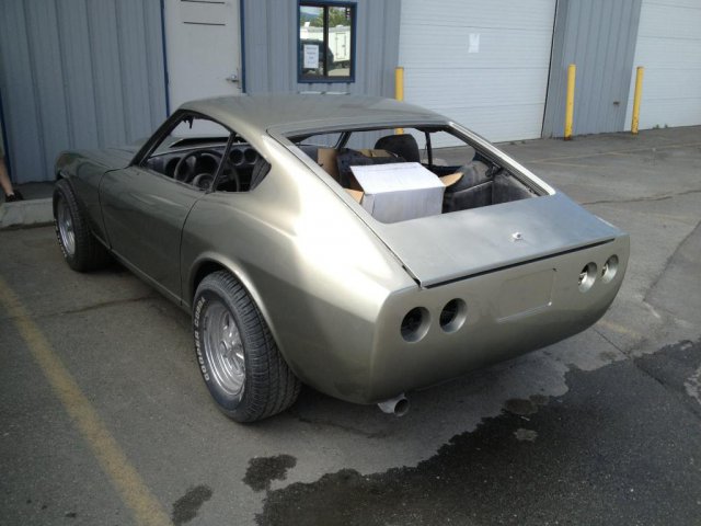

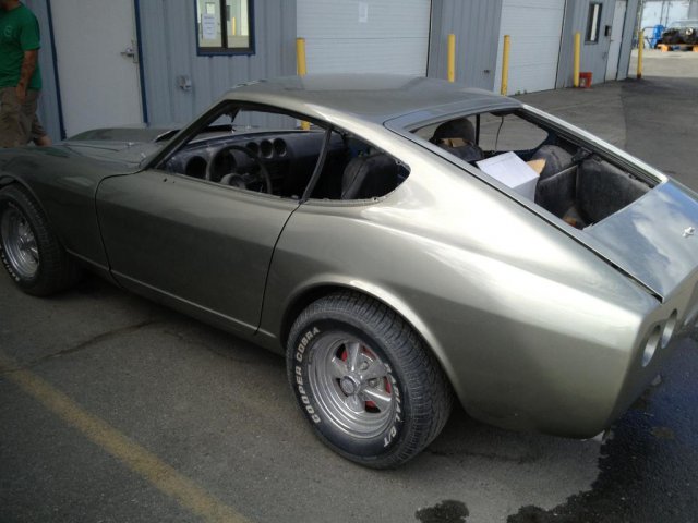

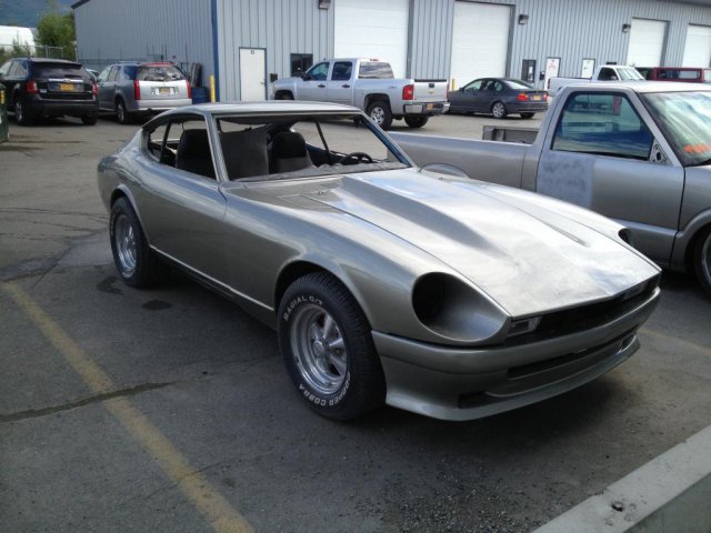

	Car is painted! After all these years I still like the pepper grey metallic. However, I decided to ditch the racing stripes.
	It's been along time guys and the project it still going.
	Well I'm still working on it. I have done alot since I've posted last. I'm hoping to have some pic of it painted in about 3 weeks.
	Hey man hows your Z coming, love your build, wheels the shaved and tail light section everything looks great, got any pictures of it finished?

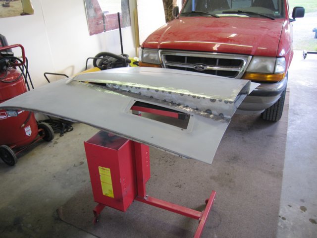

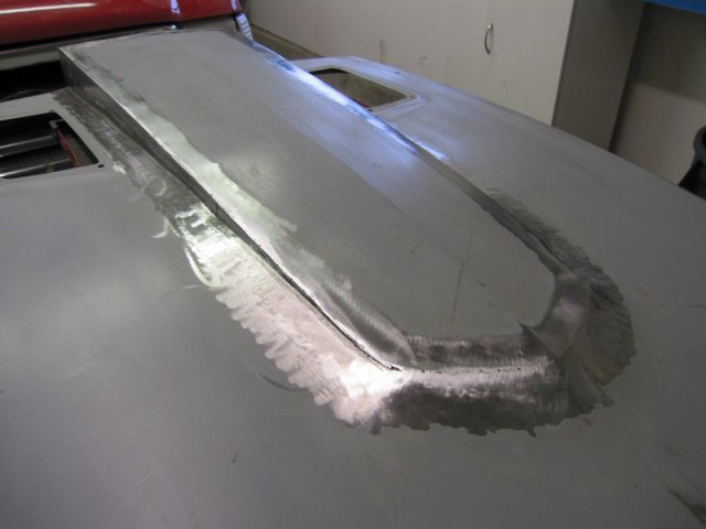

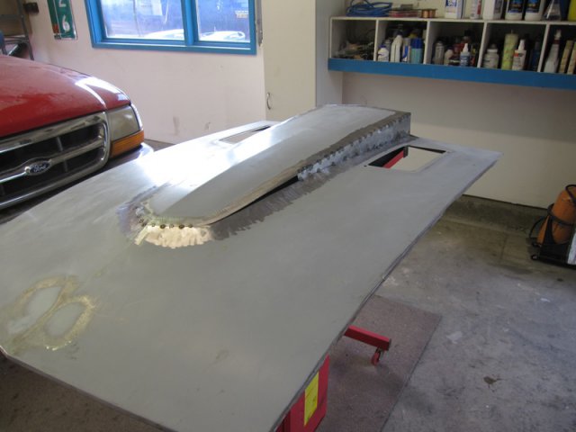

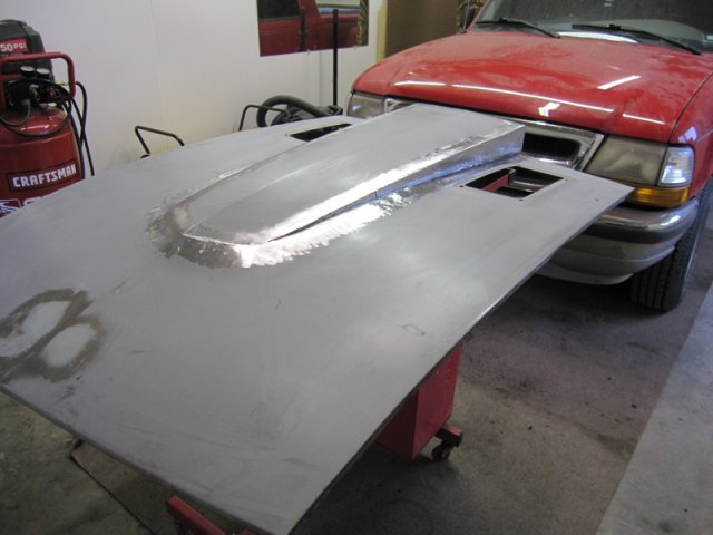

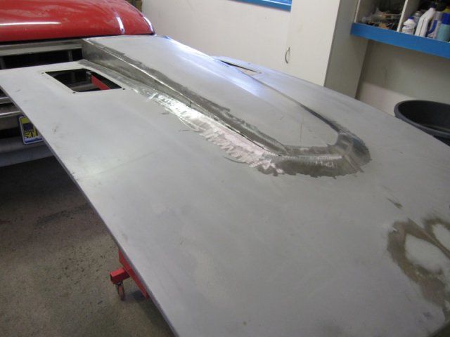

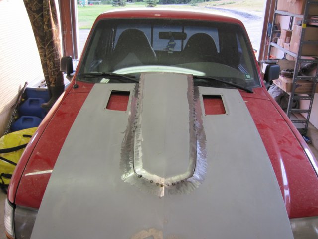

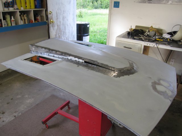

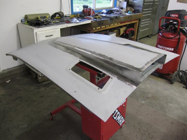

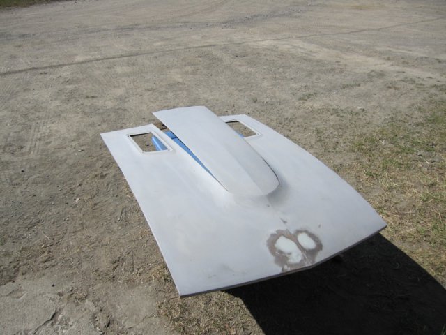

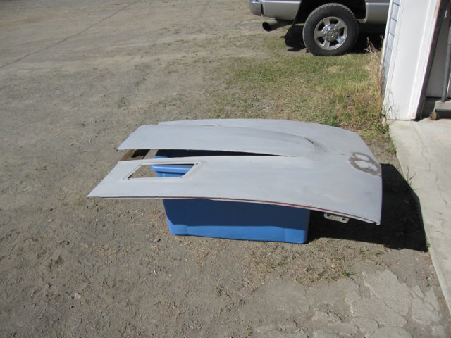

	I think it turned out pretty neat. I was interested in using solder for the "filler" on this hood. Does anyone have any ideas as to what i need to get?
	Some what formed into shape. The metal got a little hot and warped a little. What welding combo are you guys using when welding on your cars?
