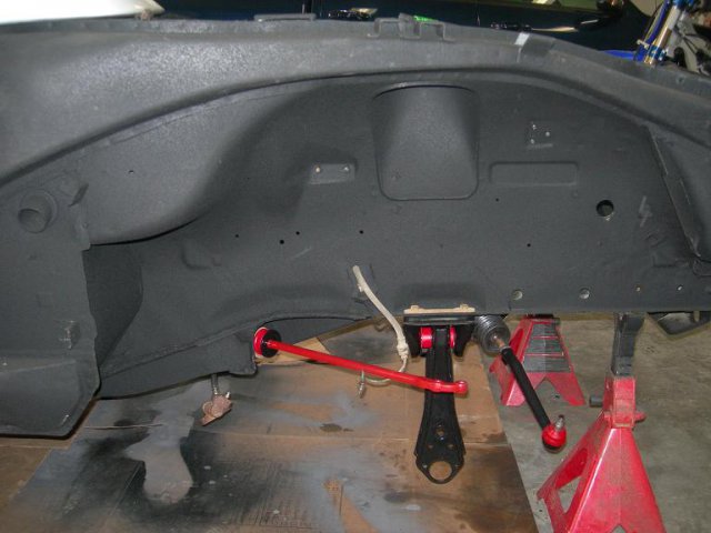

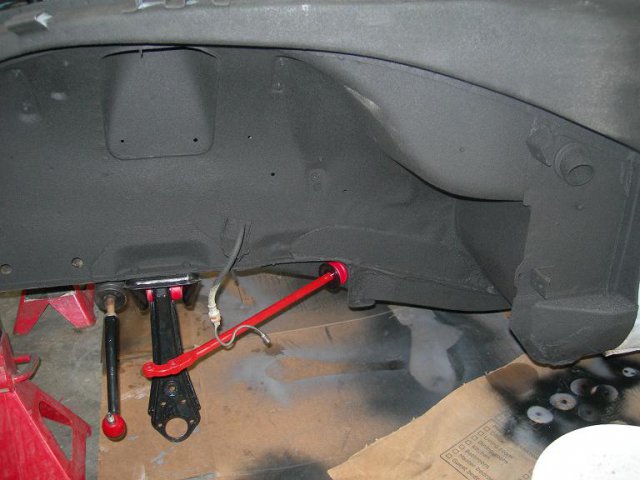

  12. Thats what i though, but i didn't know for sure...let me tell you what though once you put swaybar in on one side it it hell trying to put it in the other...the best way i found to do it was use a visegrip clamp underneath the trasferlink and on top of the swaybar and compress. Also found that getting the shock on when the ball joint isn't mounted to the bottom of the shock was pretty tough as well, but if you take some channellocks and twist the part that the tie rod mounts to...you can control it pretty easy.

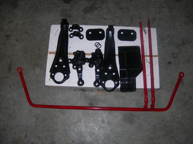

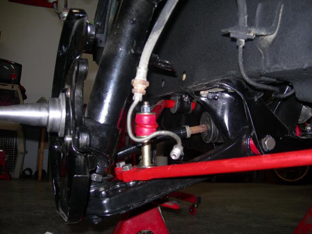

  15. I was wondering if the swaybar bushing should be twisted as shown in the pic below...let me know thank joe

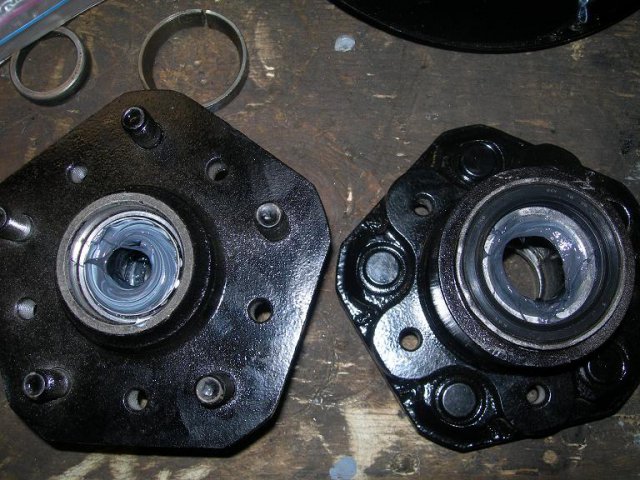

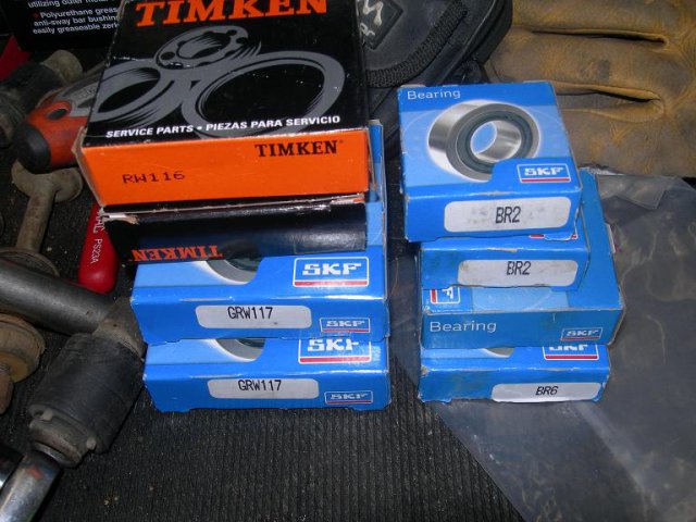

  16. So here is a few parts that I picked up...i put all the bearing and raices in the hubs today and the only thing that standing in my way of assebling the hub/rotor assy on the perch are my spacers that i order from MM. BTW thanks for all the complements guys!

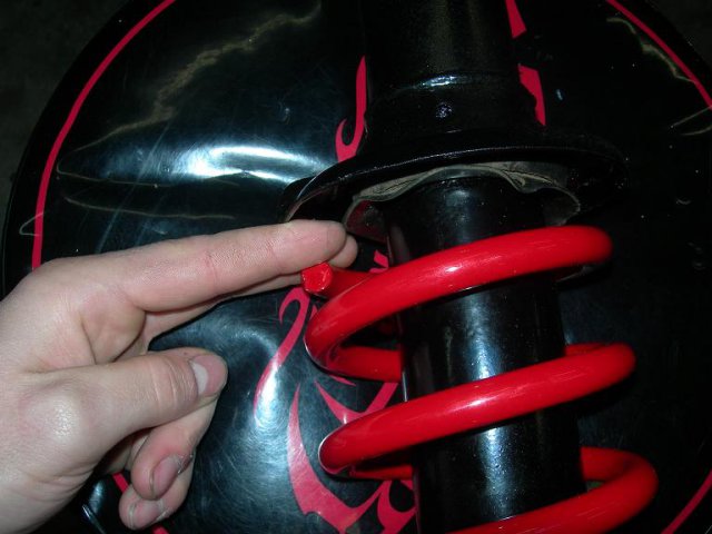

  18. BTW everyone i found out that its normal and that the weight of the vehicle will compress the spring.

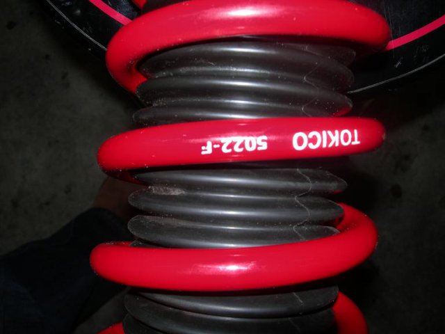

  19. btw the part # on my springs were 5022 and the shocks are the same as yours.
  20. i have a 77 280z as well and i was wondering if when you put the springs on the stock perches if the spring was really loose after tighting the nut? thank joe
  21. i don't know if there are lowered springs or not. I just bought them through motorsport auto and thats what they gave me. if even if they were lowered spring they should be snug on the strut right everyone?

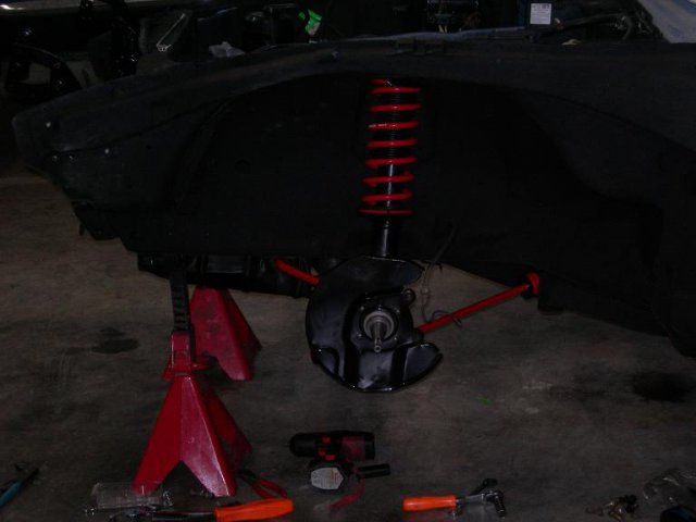

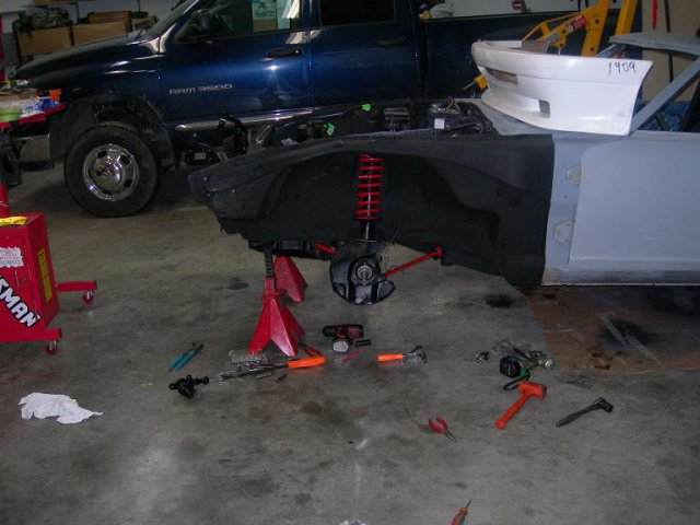

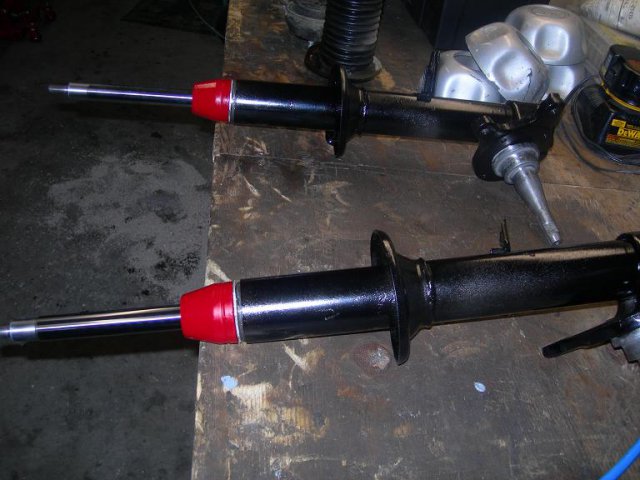

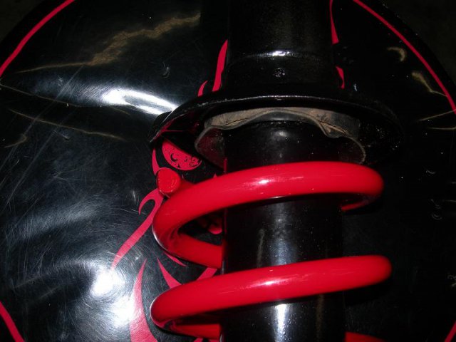

  22. i bought the tokico hp set up from my car and i put the springs on without any spring compressor tools and i have a finger gap as you can see below in one of the pic's... Since it saturday i can't call and confirm that these are the right springs, but is this natural to have such a hung slop with that spring? i can't go any further until i know that these are the right springs and what i have to do. thanks for the help guys.
