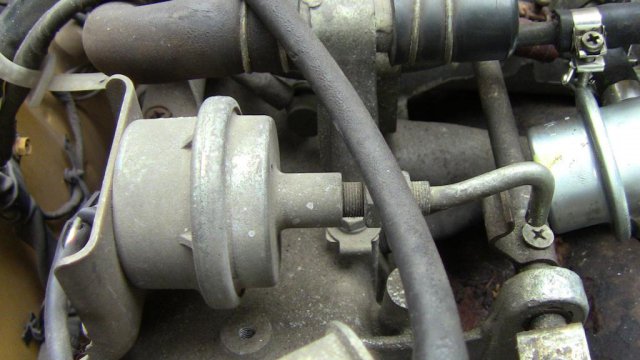

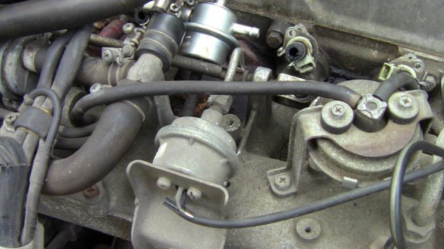

Hmm okay that's good to know. I guess I can get rid of it since my AC doesn't work anyways lol. Thanks for your help! -
So I was replacing my injector wires and I noticed there was a broken vacuum line going to this part, but there was nothing attached to the other end. I can't find anything about it in any of my manuals. Does anybody know what it is or what it does?
