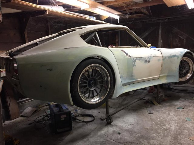

  11. My wheels are forgelines centre locks, 18 x 11 fronts and 18 x 12 rears.

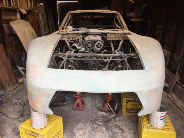

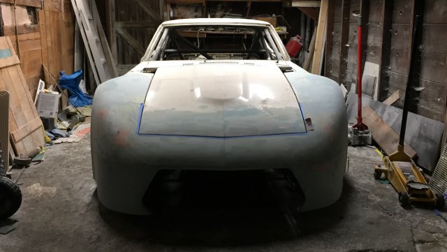

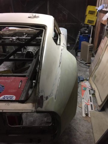

  15. Oh yeah I'm making molds for the whole car except the roof, not sure if there's a demand for it tho. Thanks

  17. Thanks guys, yes, I didn't like the wide body kits out there, Didn't like the other kits cause they didn't flow with the 240 lines. I've imported a set of ZG kit but didn't use it, so went ahead to make my own plugs for my build. My set up is a tube frame chassis with upper and lower arms with an rb26tt engine.

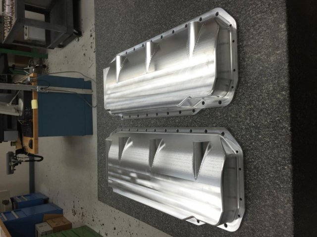

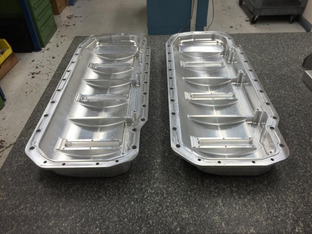

  18. The pans are finished but I have no engine to fit it into. My 240 build is 1-2 years away from being finished . - Rick

  20. ZT-R Hopefully you can see it, from the bottom of the block, .250 pan lip .650 first drop 1.43 second drop 2.40 bottom of pan Centre of hole of oil pump body to edge of pan lip is 0.43 0.86 front of lip to first drop 1.50 second drop 4.125 third drop
  21. Hi Ef Ian I made two in case I screwed up. Also can make more in the future
