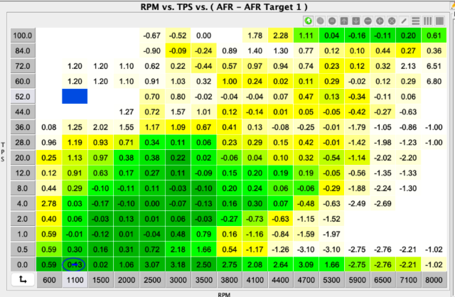

  8. the most valuable tuning tool for me has been this MLV histogram - I can drive around all day logging, and then load this and in one view I can see how close the tune is to where I want it to be.

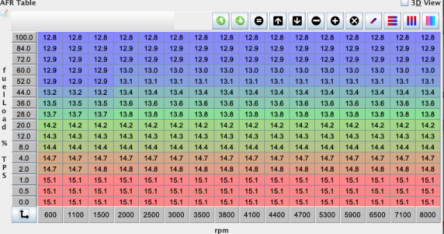

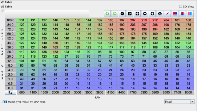

  9. yes, Speeduino uses Tunerstudio too - I'll share some screenshots and the tune. I'm switching to 50s because this engine doesn't rev out like my previous 2.9 did - it would zip round past 8000 but this one is more powerful below 6000 but isn't so keen to rev past 7000 at all. It might just be the longer stroke, but it could be the 45s are too small so I have to find out. on the motorway it does about 35 mpg (UK gallons, so prob 30mpg US). and I'm confident it's well more than 300bhp (but never proved it, because that costs money :)) VE table: Spark table: AFR table I only use closed loop o2 control at low throttle openings. Above that, it does hit the target AFRs quite well, after years of logging and histogramming with MLV. CurrentTune.msq
