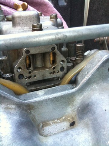

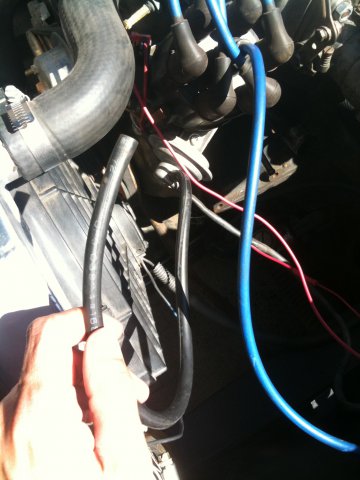

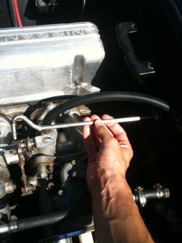

well i have a couple specific questions with pictures ( hopfully they work) 1. my stock 71 linkage is 2 1/2 inches too long to fit on the linkage for the webers, what do people do? 2. all of my webers are missing this plate on the back, the choke plate? can i run without it and will it affect driveability? beyond just starting it up and waiting? 3. where should i plug in the tube for the (vacuum advance?) from the bottem of the distributor? 4. what about a heat sheild, custom? 5. as it is now there is no fuel return, both sides are plugged. is this okay? 6. the SUs had a coolant line going through them, the webers dont. is this okay? thanks for any and all the help
