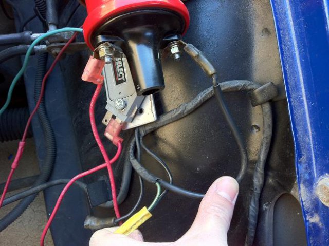

I bought a remanufactured dizzy with E12-80 module. I have a quick question for the wiring: G/w connects to long b/w to bypass resistor + coil post connects to B terminal on IC unit Short b/w wire to + post on coil Black wire from engine harness near coil goes to C pin on IC unit and - post on coil? Will someone post a clean pick of how/which wires are connected to the coil?? Thank you

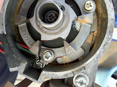

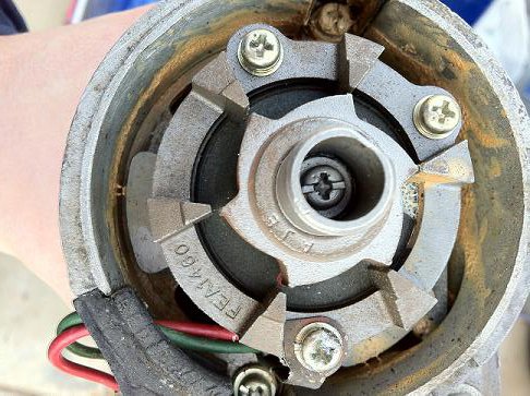

Still no luck. Okay so still the same problems. But I think that I have the HEI wired up properly now. I was trying to change the pickup in the distributor and ran into a few problems: one of the three bolts that holds it down stripped. While I was messing around with all this I noticed that the "star" thing that spins is not looking right. As you can see in the first pic one of the splines is hitting as it spins. In the other pic there is a spline that is about 1 cm away from the pick up point. what does this mean? buy a new one?

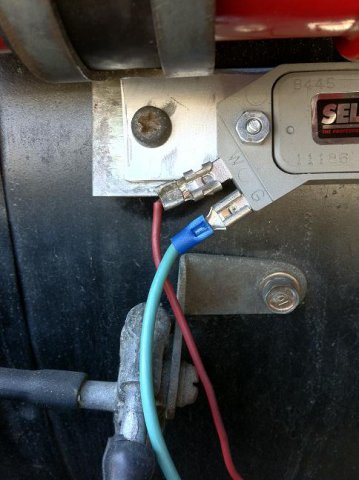

I am still having no success with getting the car started. This is the HEI module. First pic is W and G terminal, I have the red and green wires from the distributor going there. The next pic is of B and C side. Im not sure how to wire this side. I have four wires: long BW( black white), short BW,GW(green white), and B(black). And a red wire that I think goes from the negative post of the coil to the C terminal. I also got a pickup coil to put in the distributor.
