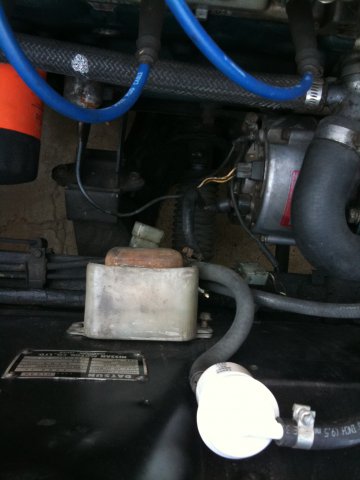

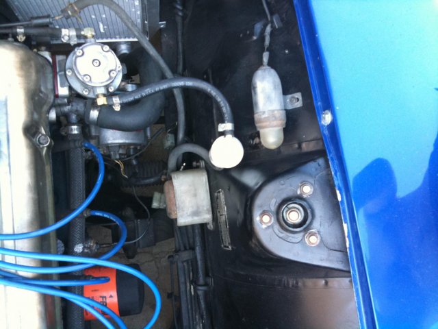

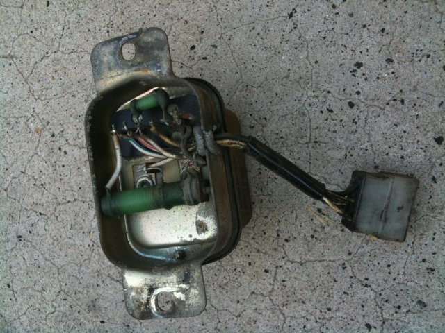

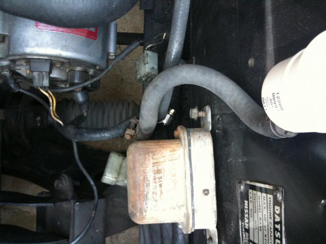

what is this thing near the alternator that bolts to the inside fender well? it is under the fuel filter. mine has a plastic cover that fits over it. it plugs into the wiring harness. do i need it? car is a 71.
