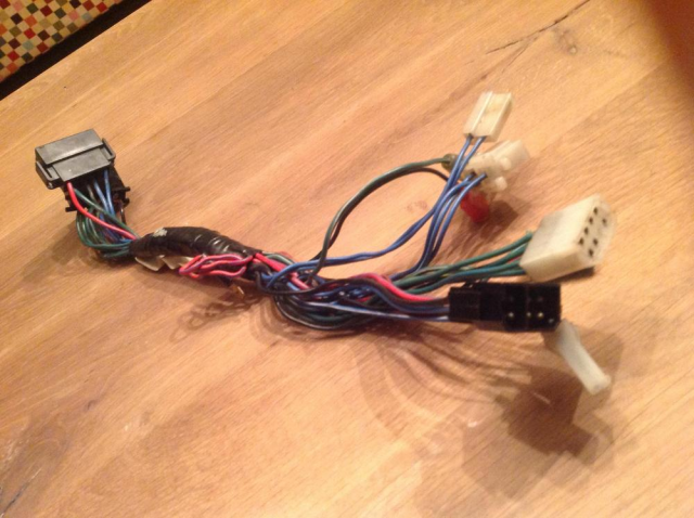

  13. Do you have a center console harness? Its the 30cm long subharness with 2 black plugs on one side

  15. Hey, does anybody have a spare 75-76 280z center console harness? Its the one with the 3x3 hazard switch plug and the black radio connector. Don´t want to butcher my one since somehow a 77-78 got in there which is in far too good condition to modify. Its the one from the two black plugs (C10 and C11) to the radio, hazard etc. Like this one, only with the 3x3 connector. thanks
  16. Yes, the 3x3 one! Do you also have the small piece of harness running from the 2 black plugs (C10 and C11) to the hazard switch? would buy both switch and cable
