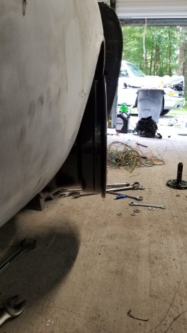

	Funny, I actually just got an '08 Explorer diff heading my way courtesy of ebay. I need to reach out to DSS about a custom set of axles and see what that damage is compared to the Apex kit. Does your car not squat? I'm stock fenders and with 245 dr2 Hoosiers you can see where they touch, presumably on the launch. That was with the stock cxracing springs though (240lb). I've got 500lb springs in there now but never got back to the track to try them.

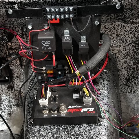

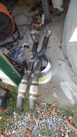

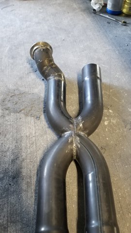

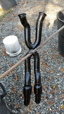

	'77 280z aka Project Tetanus (LS6 383, T56)SH4DY replied to SH4DY's topic in S30 Series - 240z, 260z, 280z Lot's of changes and developments over the past few months. Lot's of Skillard stuff, Redid the headers/ exhaust (single side exit now), went to the dyno.. All kinds of stuff. Oil Catch can I made to fit in the factory washer reservoir spot: WHP axles (left) vs ZXT remans Skillard front splitter (2") and the side market deletes off eBay (I think a member on here?) Interior shot with the dash I made using the factory substructure: I changed up the headers/ exhaust quite a bit - now they are 1.75"->1.875" with multiple merges. I went this way because the old exhaust was rubbing on everything even tucking it up as high as possible. To get it to fit under the car I would have needed to oval the entire thing which I didn't want to get into. Luckily with all the merges, it's actually pretty quiet even without any real muffler. What it looks like all together. It's completely heat wrapped now. And finally: I finally made it to the dyno. It was kind of bittersweet. Who am I kidding - it was a kick in the dick. My Speedhut wideband started reading erratically and the MS3Pro followed suit making changes to the fuel map that made the car undrivable and caused a backfire through the intake trumpets that melted one of the screens on the ITB's. So that was fun. I disabled the wideband corrections, cleaned up the fuel map and changes the spark plugs all while still on the dyno and it was a brand new car. I just used the dynos wideband the rest of the time as the Speedhut unit continued to be flaky and erratic. At the end of the day I called it quits at 390rwhp SAE uncorrected - the fuel was pretty spot on and timing changes weren't making any difference in power. Yes, for the parts that are in this thing I had expected much, much more - I was thinking 500-520rwhp. So I was pretty defeated until the next car that went on only made 276rwhp and it was an LS1 with Intake, headers, full exhaust and tuned. Soooo, to be +40% over that... that's actually probably about right for a 383 LS with ported heads and a cam. You just get so used to internet heroes with bolt on LS's making over 400rwhp, you forget not all dynos are the same. I'll post the graph later on - peak power is around 5,600 and it's pretty much nosed over by 6,800. With the cam thats in it I was thinking it would carry the power higher but the 52mm ITB's might be restricting it up top on this size motor. Overall, I'm happy with it. It sings a sweet song.

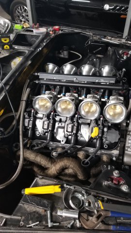

	Alright, now that I have the car running: You absolutely need to have each throttle body adjustable. It will run like absolute dog sh*t unless they are synced, per bank and bank to bank. And the adjustments are very small, like 1/4 turn on an M4 bolt. I also went through the painstaking process of drilling and tapping every single runner and then tied them into a vacuum manifold to get a good MAP sensor reading. No Alpha-N needed, it tracks on the VE just like a normal manifold does but you need to ramp up the tps accel enrichment because it revs very, very quickly. Getting the crossover linkage sorted out was also a massive pain in the ass. If I did it again I might flip the TB's 90* and use an adjustable heim joint or something like this: https://www.jegs.com/i/JEGS/555/15795/10002/-1?gclid=EAIaIQobChMIx9e22LT55AIVFIrICh0mgAz7EAQYBSABEgKwhfD_BwE But, for the minimal amount of driving I'll realistically be doing, the current set up should be fine for now.

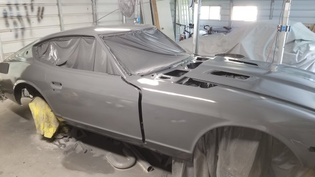

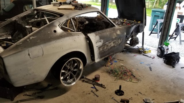

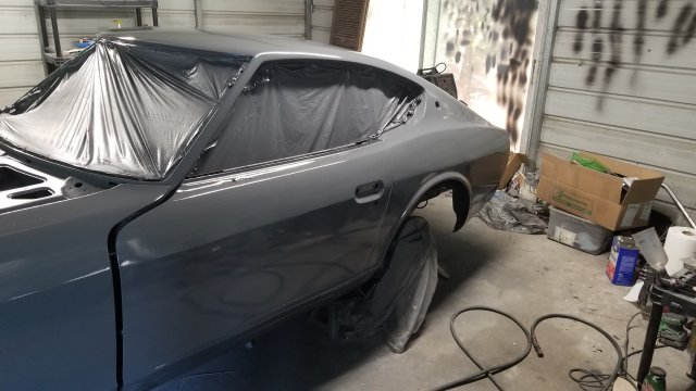

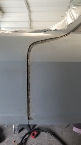

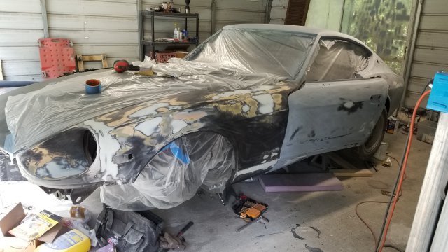

	'77 280z aka Project Tetanus (LS6 383, T56)SH4DY replied to SH4DY's topic in S30 Series - 240z, 260z, 280z Making some progress again. I've spent the last month trying to get the body sorted out and painted. It has definitely tested my patience. First time I sprayed it, it came out like shit because I didn't spend enough time blocking the primer. Sanded it all back flat and sprayed again. Was pretty happy but burned through the paint prepping to cut and buff it. Wet sanded it all with 400 grit and pictures below are the 3rd try. It's a single stage so there's orange peel put plenty of paint to cut and buff it after it cures. Started working on a fiberglass/ carbon dash skin. Motor runs: I ran it out of gas syncing the throttle bodies and thought I had screwed something up. Definitely need to get the gas gauge hooked up. I did learn than the lines hold roughly a gallon of gas... Still a long way from driving but she runs and she's all one color so that's a plus. MS3Pro and engine fuses/ relay panel:

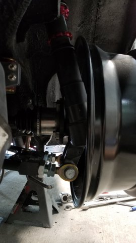

	T3 Rear LCA's with CV conversionSH4DY replied to SH4DY's topic in Brakes, Wheels, Suspension and Chassis Well, after talking with WHP their kit does require shortened axles even though the site doesn't specifically say they are required when using their CV conversion flange. I'm going to try and shorten them myself (cutting in the c clip groove further down the splined portion as outlined on this site) - I'm sick of throwing money at these damn axles. If I can get them at least a 1/2" shorter I can increase the track with the RLCA's and should be fine. I'll report back.
	I finally got around to installing the upgraded WHP 39 spline stub axles with the zxt inner hubs. When I initially installed the axles they were too long (or the rlcas were too short) to get the coilovers to line back up in the strut towers. The picture above is how far I had to adjust them out to get everything to fit. Right now the axle is horizontal but the ride height needs to come down another 1" at least. That should help get the axles above horizontal at the hub and help with binding but I still think it'll be close. Can anyone chime in about your rlca measurements (i don't have the stock ones to measure) or see if the above looks about right? More pictures to get an idea of current camber and height:
