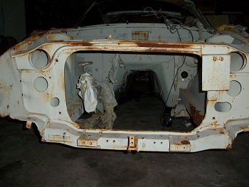

Made up a build sheet for starters. Body- sending car to stance body. Midia blast. Fix all body rust and imperfections. Cut and weld in TTT camber plates. Primer and paint.(factory yellow or silver) Bring car home and start on suspension/brake/wheels swap and build. TTT-Camber plates TTT-Front & rear control arms TTT-Tie rods TTT-Rear end & axle swap kit 300zx TT axles/diff) TTT-F/R strut bars Tokico illumina strut/ground control coilovers 300zx twin turbo brakes swap SS brake lines Run New brake/clutch lines 81 280zx brakes master/booster I have everything as fair as turbo motor/trany/drive shaft/interior/seats/gauges/clutches/ECUs, so all my cost are body (need finders, hatch,windshield,headlight buckets witch I pick up next week ) paint, suspension, wheels, weather striping & wirring. Let's get started!!!!! -

I forgot to grab a pic of fire wall numbe will tommarow. I guess the thing to do now is get the sub frame back on the car, and wheels so i can push it around easyer and get it to the body shop. I leaves in about 2 weeks for the media blasting and primer. Were thinkig of painting it pearl white, factory 905 red, 919 yellow,901 silver. lets just flip a coin. -

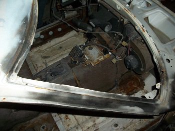

Check this out & what do you think? Solventreplacement.com is the company. I have been reading a lot on the web, and seems there is a lot of maxed feelings over what the "right" approach for the surface rust removal is in my 240s condition. (Media blasting,acid dipping,green solvents,sand blasting, ect). I have the chance to really clean and properly build this early 240z and want to do it right the first time around.... From what I've read the cons to the following were- Midia blast, sand blasting- worping in the body. Acid dipping- not properly cleaned after dipping and acid continues to eat the metal. So help Me out let's here dome ideas? -
