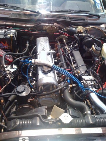

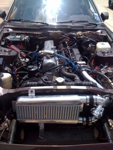

Well i have had my 280zxt for about a year now. Just sold my 83 280zx {the gold colored zx in the photo}. my 83 280zxt is a side project/DD, ill list a few mods. Car is tuned at 12PSI made 210whp/251wtq - Auto trans. 181,000 miles factory block & rebuilt head. Stock t3 turbo MS II ecu 440cc injectors n42 intake 240sx TB PowerFab FMIC Tial BOV MSD ignition walbro 255 fuel pump Greedy profec b boost controller prosport boost,oil,water guages Aromotive manual fuel reg AEM wide band PowerFab down pipe {no exhaust} HKS metal headgasket much much more.

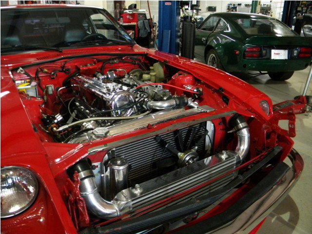

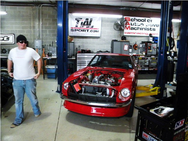

The 240 is running GREAT, drove it to get the fenders rolled, so i put about 22 miles on it total so far. PowerFab put it on the dyno today and it made right over 300 at 8PSI with the holset hx-35. Tune is rich and we are just taking a easy on the 3.1 to brake it in nice safe. We got the 750cc injectors in today so those will be installed along with a bigger intercooler. Still waiting on clutch, but that wont really matter untill we are making over 400whp/tq. Will post up dyno sheet once i get it emailed to me. -

Ok so the stoker is installed. We are STILL waiting ont the injectors and clutch we will have to go back in and change the clutch & injectors when we start making really power with it. But progress has been made, we are going to start it tommarow for the first time and tune it for a brake in safty tune. i didnt get to take many pictures and we havnt installed the oil cooler or filter yet. Pics http://s1106.photobucket.com/albums/h363/chrismiller891/ -
