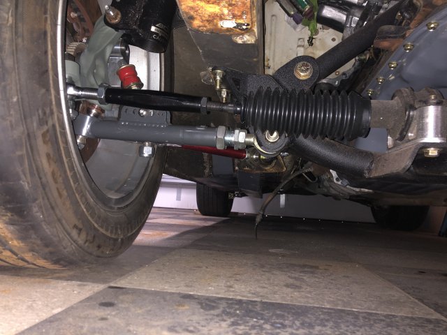

    I finished the initial mock up my rear suspension and came up with the following approximate measurements. The suspension consist of: Full T3 rear end swap kit, minus the T3 coilovers. BC Coilovers with T3 tabs welded to the BC lower mounts...this allows the BC coilovers to be bolted to the T3 hub mounting plates. The resultant clearance is in the drawing attached. Given these dimensions I believe I should be able to stuff a 9.5" wheel in the well but its going require a positive offset of approximately 40. I may be able to adjust the lower control arms in a bit to get this down...I'll have to take a look at that.

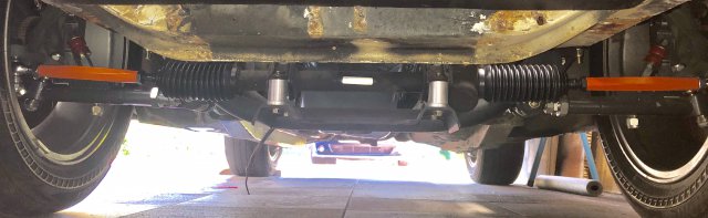

    Well I went back to my metal work...this past weekend I fabricated the aft driver’s side floor, there was a small area of rot but I ended cutting our a section approximately 6” long and the full width of the driver’s side. This required me to remove the rear seat mount. I also had to purchase a bead roller to roll reliefs/stiffeners in the replacement floor to allow it to fit properly over the aft section of the frame rail. All in all it came out pretty good. Still have a little welding to get this repair finished. It’s not very photo worthy but once I get the rear seat mount reinstalled I’ll snap a photo or two and post to this thread. Still have to get the driver side rear quarter welding completed but it’s on the list. Also spent some time over the weekend removing all the OEM rear drivetrain and suspension then installed all the T3 candy, both rear control arms, drop down mounts, mustache bar. It’s all in for mock up purposes but excited to see it in there just the same. I also installed the T3 front control arms. The quality and fitment of the T3 stuff is phenomenal... I highly recommend their stuff. i’ve posted a couple photos, please keep in mind this is only mocked up to ensure fitment, please excuse the condition of the bottom of the car...it’s on the list;-)

    As predicted once the T3 candy showed up I couldn’t resist. Plus, I’m waiting on some welding aids to continue the left rear quarter so I unpacked all the T3 odds and ends, unforturnately a couple of pieces were damaged in shipping but as soon as I let T3 know they immediately shipped new parts. I was able to remove the stock left rear suspension and install the T3 control arm, hub adapter and BC coilover. The BC coilover was a weld in unit but T3 was kind enough to sell me their mounting tabs. My welder is not high enough amperage to weld the 1/4” plate tabs so they are only tacked in place until I can weld them up with a stronger TIG welder. I am quite pleased with the result,the rear end is lowered by about 3” on the initial setup...keep in mind these are only mocked up and will need final setup once they are permanently installed in the car. Next week I’ll get the right mocked up and lower the fronts to a move level attitude.

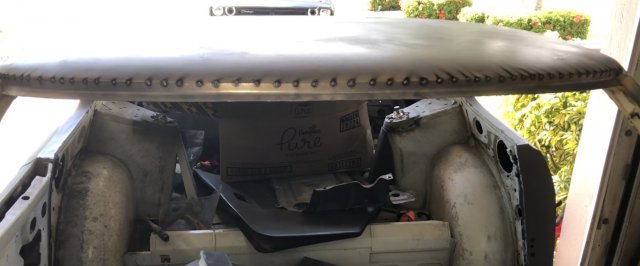

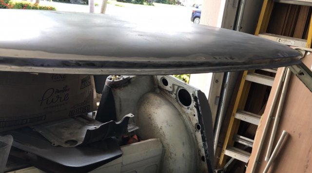

    Jumped back on the left rear quarter panel. Started butt welding it in place but it’s slow work trying to prevent excessive warpage, plus I have a couple areas where I have an excessive gap between the weld area so I ordered a magnetic copper backing plate to back these areas up to aid in bridging the gap. I’ll get some photos up ASAP. On a different note, my rear end conversion kit from T3 arrives today so i’ll Probably get sidetracked from the quarter panel to mock up the new rear suspension and BC coilovers. I’ll keep you posted how it goes.

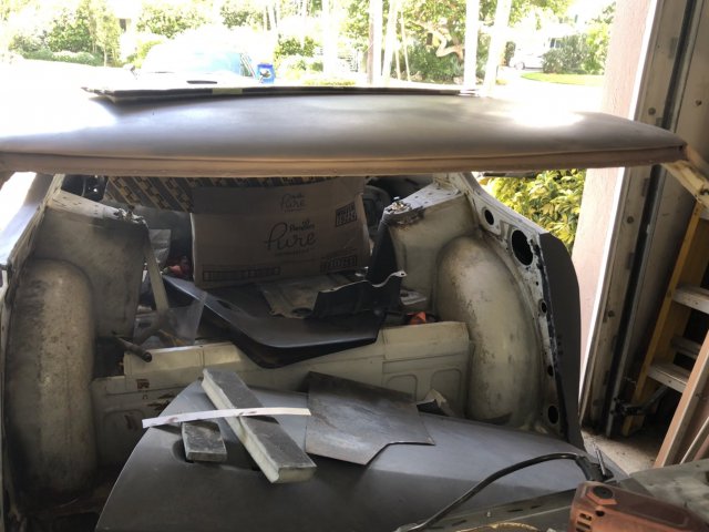

    Been working on the rear valence for the past couple of days. Let me start by saying this replacement part is much heavier gauge than the original part but it was delivered in a nearly flat condition and the rear of the car is not flat so it takes quite a bit of massaging to get this panel to fit. And, the only part available is for a 240 so this creates more work too. The 280 bumper brackets (behind the valence) were bolted and welded to the chassis (genius), they are totally different than the 240 so these had to be cut off the chassis. Then I fabricated new ones to be welded back in place. Then the only indentation in the 240 valence falls right on the rear chassis crossmember so it had to go as well. Now Im ready to move forward with final fitment before I weld it in place. This piece is a lot of work but should be a vast improvement over what was there.
