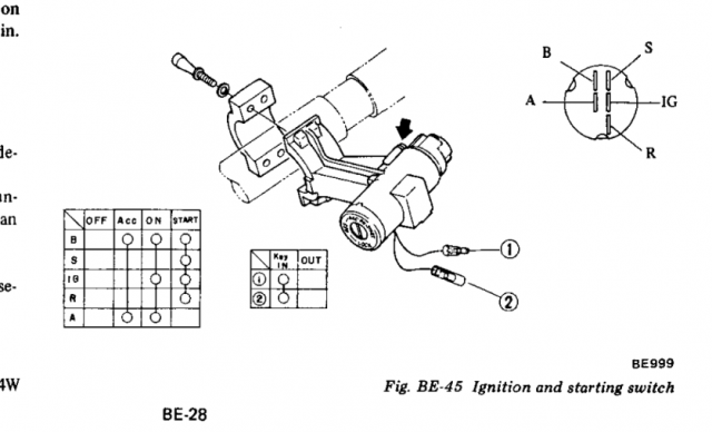

  10. NewZed, I already checked the switch, before i read your post. From BE-28 i checked all and especially "B" and "IG" since those are the 2 active on " start" and "on", which are needed for fuel pump relais. Both had power in both settings. Therefore, I checked the working of the "floor Temp" sensor" and found in EC-17 that that system is also interacting with the fuel pump relais and grounding all over. I removed the passengers seat, and removed the relais (btw what is the thing next to the floor temp relais, on the left and is it normal that 2 pins missing in the connector?) Did the relais check as per EC-21 and found that terminals , and found error as no continuity exists between 5 and 6, and this should be present. Other continuity was okay. Did not bother yet to connect 12volts to check other functions. What do you think, could this be the issue? From the schematic I concluded that this could be reason, but i' m not sure. For sure I need to find a new relais, or is it common to remove the floor temp system? Cheers, Joost

  17. Well guys, I finally solved the issue - Since I got my car without any keys and ignition lock and switch, I had ordered a replica version on e-bay. Once it arrived I looked at the connector and the switch (5 pins,1 missing) and figured that it was all correct. I also checked the details in BE-26, with the B,S,A,IG pins, and the one not named in BE-26, marked as "R". Measured the signals and all seems correct. - After having run through the fuses, relais, and wires, i went back to the switch again. After studying the schematic below, I figured I better measure the signals with the connector in the switch. There I found out there was no voltage signal on the "S" with ignition on START. Checked the schematic below again, and found out that when I would swap out 2 wires in the connector, all would be fine. So thats what I did, I swapped the White Red wire, with a Black Blue one, and starter cranked up right away. Issue solved! So for people getting replica ignition switch watch out for this mix up between R and S. - btw, anyone know what the Black/Blue wire is for? as I have now switched that one in the ignition switch connector. Thanks for the help jhm! cheers, joost

  21. just tested the switch, and in "START" position, "B" , "S" and "IG" are all connected as per the schematic and they are all closed from "A". I think this rules out any issue with the ignition switch, right? 7. I checked all fusible links (all 4 right side in engine bay) and they are all connected. I think I will check if the voltage to that point (past the fusible links) when I engage the starter switch. Joost
