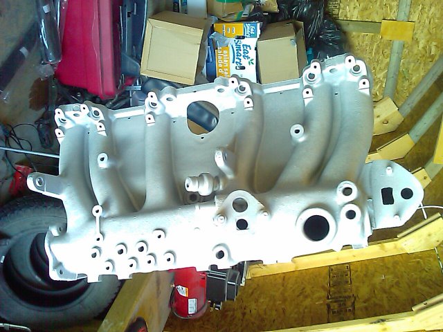

So Im building a couple Z31's. As posted previously I have been wanting to make one engine Twin Turbo VG30ETT and the other just a Gas saving semi fun car lol. So I have picked up a 1984 Arizona Z and recently got a FREE yes FREE 1987 N/A with all leather interior and Black dash and stuff hehe. Anyway in staring to Mod a customers vehicle a friend and I have notice the Z31 intake fits backwards on the plenum and still clears all obsticles. only real close part is the timing cover but it actually clears it still by a couple mills.. Anyway I will post pics as they are on my laptop I realized but we basically chopped off the side intake welded that hole shut and then cut a Square out of the Backside of the intake (which is now the front) and mounted a 240sx Bigger throttle body on that. Couple kewl things we noticed. More room to access lower parts and injectors. the Plenum now dosent hang so close to the exhaust near firewall infact there is over 60% less Aluminum to gather heat from the exhaust thus making your charge air so much cooler. Also! makes it nice for turbo aplications and NA as you free up tons of room all around. Ill post pics with Both the Pathfinder (ported) intake and stock (Backwardzzz) Z31 intake Our new creations name is: Mr. Z & Mr. 2 OEM automotive Engineering. We will be accepting cores and converting them to the new design Pending our finished product and Dyno numbers and flow charts. We hope the gains will be good overall so that all of you all can have a semi stock looking plenum without paying huge bucks for ones that might not fit perfect or have to be redrilled ect. ect. Stock fits absolutely perfect backwards hehe.. Weird hey

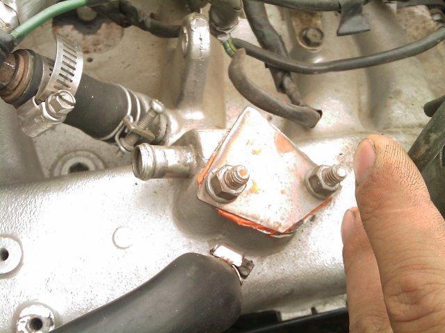

OK first I`ll tell you whats left on mine. Nothing... LOL ok no seriously... I have Vacuum for Boost Sensor Vacuum for my Auto tranny and Vacuum for Fuel Pressure regulator (FPR) thats it. Everythign else I took off Except that Air flow (when cold) thingy I kept incase car would run weird but I capped it hosing here frig Ill take some pics LOL one sec... *runs outside* everything I got brass caps and closed off all other vacuums except ones shown.. Brake booster Boost FPR Transmission (auto)

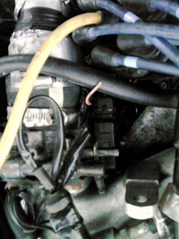

ok heres my build. Thing is... I have it down to a Coil/Distribution of Spark problem. or if the Cylinder Head temp sensor if it would cause Bogging at stoplight Acceleration or half throttle area (maybe most engine vibration) its very strange because... I have eliminated all AAC/EGR ect ect my intake is as follows. Filter on end of MAF ---> Turbo ---> intercooler (just over the weekend) ---> Throttle Body (240sx) ---> intake plenum ----> combustion chamber ----> Exhaust (O2)...... So what are your thoguhts.. ECU (swapped to 300zxt 1987) MAF (maxima 1992) TB (240sx 60mm) Stock 280zxt injection Stock sensors TPS 1990 Maxima Converted to Cable throttle Ported head intake to 32.55mm (from I think stock was 28.5mm) so to *gasket match* 1987 300zxt turbo mated to 280ZXT wastegate and downpipe 280zxt Wastegate actuator (1981.5 stock) Swapped in and out MFPR and Stock FPR no change tried different fuel ranging PSI from 32psi to 50Psi Switched out distrubutor internals with 300zx and same symptoms Soooo this problem was happening before my swap to ECU Z31T so I was hoping the change would cure it with better mapping ect ect but to no avail. its almost like I have an injector stuck open but when I check plugs they are all slightly blackend with soot so its as if its misfiring on all cylinders intermitantly or just over fueling every so often... any ideas greatly appreciated.. I should test the Head temp sensor I guess.. Anyone know resistance values or I guess I can look it up on ALLDATA. after that if that is all good. then I guess im looking to buy a New Cap and or Coil assembly
Yeah I just put an entirely new 240sx throttle body on with another TPS reset ignition timing and checked all connections, Rewired anything that looked fishy, put in another O2 sensor and now am doing plugs and oil change.. then I guess its temp sensor time Cause after that i have replaced almost everything except that little round thing beside coil whats it calld again.. Stores charge or something? all I know is when its not grounded the car wont start lol. So other than the temp sensor and that thingy everythings replaced.. Even used the guts of a 300zx Distributor and inserted in my 280zxt SHell and that didnt cure it either!...
