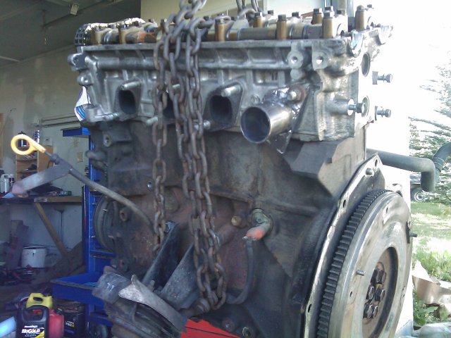

ok so went in town and got some 1/2" by 3" Flat Bar Steel. took the old Gaskets from the exhaust manifold and a can of spray paint. Laid out the flat bar sprayed over the gasket and Vwala imprint of where I need to drill heheheh... Then I proceeded to cut the center hole which is now 1 3/4" and the ports on the L24 err I mean KA24DE are 1 1/2" so when I finish porting those exhaust ports Ill port match to just under flange size to make sure there is no pressure trying to escape out the flange. I then welded 1 3/4" Exhaust piping to the flanges a good solid doubled bead LOL and the pipes extend out about 3" at various angles. So I plan on going 4 to 2 to Turbo Flange so it hits the turbo in a V pattern. Then I want to have a 2 1/2" Flexpipe (ughh $60 dollars!!) from turbo to under car and make a External Wastegate I guess and then the rest is easy lol. So more pics later tonight as I weld weld weld away! got some serious flash!! gawd I hate my welder!

So I started a mockup Flange and Pipe for my Project 300z (Spec-SXT) hehehe and heres the first flange-pipe. So far so good Fits perfect seals nice and after a couple hours I should have a basic Manifold constructed Again Mock piece to see fitment or flange
