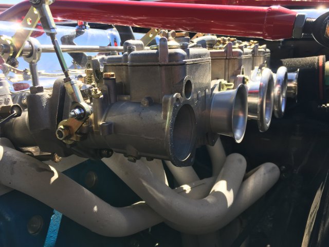

Prior to my velocity stack hacks, I would have advised the 40mm venturis exclusively for drag/road racing (38mm for all else). If you are ok with the coin required to upgrade and possibly partially/fully mod your intake parts (three options), you will not be disappointed by 40mm venturis fitted with 47-49mm ID stacks. I apologize for being vague. (I want to make sure I have my notes in front of me.) My dyno date was rescheduled, not due to my schedule. So it goes. I'm not sure when the reattempt will be. I'm racing almost every weekend until October, so it might have to wait until fall. I don't remotely lack for torque or power, so it won't impact my racing as much as a throttle cable upgrade might. I've been carrying around a folder with pages of my jet settings. I need to organize it and figure out how to best present the highlighted data. I'll deliver. -

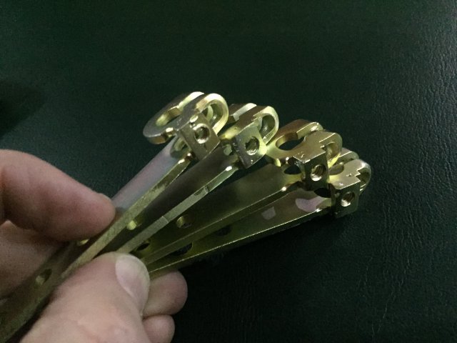

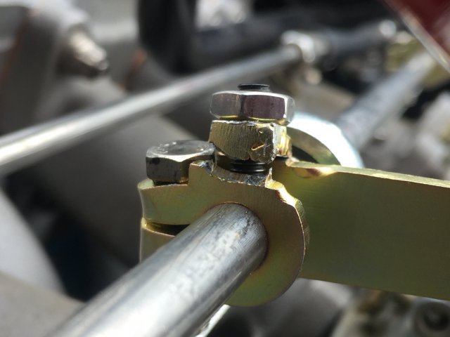

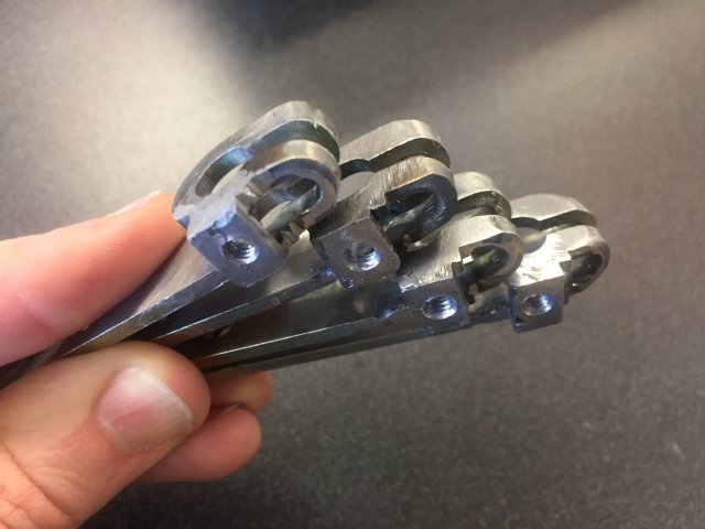

Hi Marcel. I'm not sure I'm following you. I do have custom throttle levers with a set screw. The purpose is to hold position throttle arm angle on the round throttle bar, and not slip. Metal tabs were welded and tapped, and then the arms were custom coated to match OEM Weber. They do not have adjustments for idle. Idle speed is controlled by the carburetor idle speed screws (1 per carb) and the adjusting the lengths of the connecting links between the custom throttle levers and the carburetor throttle. It isn't the best design / best welds. I broke one of the welds too easily. Very disappointing after all that effort. Now it all has to come off and be resynched... -

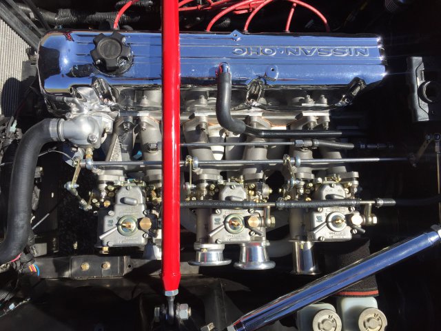

I'm still here and making significant progress with my intake tuning. At present, I can report that all aftermarket horns have outperformed the Weber straight horns, both short and tall. I have further invested in some custom machining solutions, one of which has really paid off (holy crap, I thought the car was singing before!) and is now very happy to quickly change engine speeds up and down with less resonance and gargling, even under 4k. I have another custom machining solution in the works, because well, my last three gut-instincts have been in the right direction and I'm still gaining lots of smoothly-delivered torque under the curve. And I still think I can have my peak power, too. No way I'm quitting while I'm ahead. Why am I not sharing the actual details? Because I have another dyno date set and I'm tired of saying I'm going to deliver data. This might be my last foreseeable dyno visit. "Maybe I'll have data, maybe I won't." At a minimum I will share my qualitative comparisons as well as my jetting combinations (because the changes in jets reveal how the swapped intake part affected the AFR plot). Ideally this information will be accompanied by dyno plots, but I have abandoned my mission to have an R&D experience. If I'm not already having an R&D experience then I should just give up my keys now. It's way past time to officially tune the engine timing and get an official, satisfactory baseline. As always, I'll still share everything I have learned and I will post pictures of my custom machining solutions, whether they work or not. EDIT - photos added showing some of the different air horns, mounted. (no I didn't ever fire it up this way) -

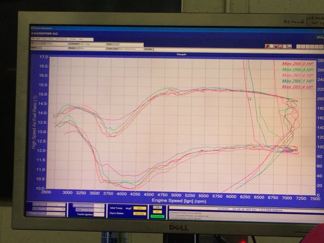

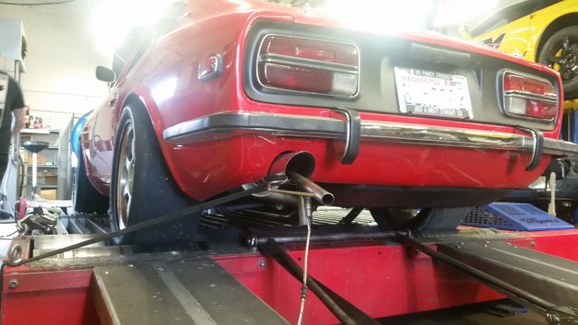

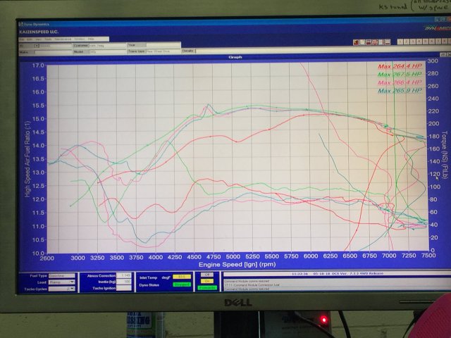

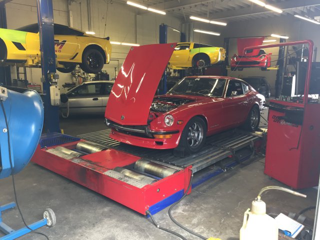

05.18.2018 Dyno Day Report 630am - 815am I arrive at my road testing location, and continue to prep for my dyno appt at 9am I continue to refine the performance of the short stack webers I achieve a near-constant 13.0 AFR from ~4000-7000 RPM Car is smooth as silk at the top of 4th gear, 120ish? I have known good jet settings for 38mm venturis with long stacks, and 40mm venturis with short and long stacks, and have swapped back to known good settings several time this week. Repeatable. 845am Unload car at dyno shop Car fires right up, I turn it off after driving it off trailer. Tech wants to get in the car and put it on the dyno. Against my better judgment, I allow a young tech to attempt to start my triple carbs (neither warm nor cold motor) 915am At this point I kicked the tech out of the car and I'm trying to start it. Flooded? Fouled plugs? I decide to refuel, allowing time for the flooded carbs to clear. Won't start 10am New NGK plugs installed Fires right up, I drive it onto dyno Tech has me accelerate slightly to set the wheels. I am already alarmed by dyno noises and vibrations, I am assured this is normal It's not like I've never dynoed before 1030am Car is NOT the same car that I've been tuning all week! Making jet changes are having OPPOSITE effects then what happens roadside! Example: changing main jets 10 up or down DOES NOTHING!? Example: changing air corrector jets now behave as if the main jet is being changed? Additionally and separately, my ignition is being screwy A few times, the rev limiter did not kick in AT ALL Several times, the car wouldn't accelerate on the dyno, but would simply hesitate and chill out and get groceries Several times, while getting groceries on the dyno, VTEC or something kicked in because the acceleration would suddently PULL VERY HARD. Pulls back to back did NOT have the same performance. We started to not trust the data, sometimes doing 3 pulls for every adjustment. WTF is going on? 1130am Despite that the rules of tuning are now unpredictable, despite that my known settings are now shit... I finally find a good AFR again, very near my 13.0 AFR that was attained roadside that morning Time to move to timing Dyno is scheduled for another customer at 2pm! At this point all I want is to capture data for the Weber short and long stacks 12pm I start messing with 1000RPM timing I get my triples idling very nicely with a screwdriver I start messing with 3000RPM timing Engine is hot, needs to cool 1230pm Tech announces he is going to lunch No other techs around 1pm Pulls resume I am less desensitized to the vibrations I continue to express concerns and I am told all is normal 115pm Eff this, I'm getting my car outta here I drive off the dyno and onto the street, vibes are insane, loud at 35mph Day is done 215pm Drop my car off at a general auto place to investigate on a lift They tighten the driveshaft and right CV axle (inner bolts) Evening I pushed myself so hard this week that I start shaking and aching and getting sick Straight to bed around 7pm Weekend Saturday - rest. I skip the first race the car can actually enter... because the driver can't go physically. Sunday - autocross. Car kicked my ass, in a good way. Couldn't get the rear to settle down, which was delightful. Not sure if I had "fun." Big losses this week. That's sad. Ignition My ignition was crippled by something that day. The hall effect sensor is supposed to negate interference? Haven't called Electromotive yet. Depressing. I will. My theory: the dyno's ignition inductance pickup was near my hall effect sensor's harness, where the sensor wire is less shielded for a few inches to allow the sensor and XDI harness to clip together. I suspect if this had been relocated, the issue would have cleared. (Some positions definitely made it worse!) Dyno Graphs The way the dyno loaded up (very delayed)... it was very hard to scientifically produce consistent dyno runs. You can see some really screwy dyno plots. The ignition pickup had a really hard time, clearly. I attempted to attain WOT by 3500 and 4000 RPM as the engine tune allowed. In most cases, if I rolled into WOT slowly, it worked out. If I rolled quickly, it would be a wasted dyno pull (delayed dyno loading). A few times I forgot I was supposed to achieve WOT (for consistent analysis of what the change did) and throttled the carbs through the reverb RPM range. Very interesting to look at the torque plots of the throttled runs! WOW! (Enter driver as a patch! Haha.) Summary Phudge. What the crap, even? I'm still going to mess with a few of the air horns for awhile. I'll still come back... not at this dyno. The staff, to me, was more interested in getting through their day than helping their customer accomplish anything. They dismissed my concerns about ignition and vibrations. Not helpful. Sigh... A not-quite what we want to hear video: https://www.youtube.com/watch?v=vk_MpV3F9Ys -

The Weber short stacks made the most power by about 270 whp. I never swapped any parts. Frustrating day. Showed up with a singing car that refused to sing for the first hour, oddly, and ultimately broke on the dyno while tuning the timing for my initial baselines -- excessive vibrations above 35mph. Never even got a good initial baseline! 🙄 My new driveshaft was installed by a speed shop and my right rear CV axle was also removed and reinstalled in the offseason. They were found loose after I finally demanded to unstrap my Z, and two bolts on my bigger driveshaft lost their nuts today. So to speak. I'll attach media when I am able. I have my suspicions about the dyno itself, nothing but issues with ignition signal today (due to dyno? very odd day). The car was smooth as silk at the top of 4th on asphault... and on the dyno it not only shook itself apart but the ignition was so inconsistent I don't find tuning to be useful on their equipment and doubt I will return. Very cool shop though... just not for my car evidently? Weird. I'll revisit this sometime this summer -- I still need to digest the day. It simply didn't add up from the beginning. For now, I am going to bed and still not attending my first race of the season tomorrow. I've literally made myself sick today. It was all I could do to get the car in the trailer in and out for the 4th time today as a shop with a lift helped me confirm my vibration issues. For now. At least the motor remains stout and sings beautifully on road tests. 🍻 🎻 -

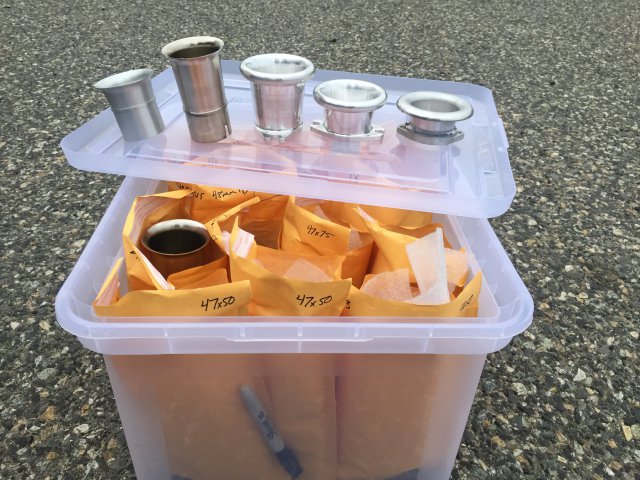

Only the 47x50mm T3 stacks will be used today, sadly. Mounting issues, had to hack up the set that's by my best guess. (Tall ones wouldn't fit an airbox anyway.) -

Hey gang. I haven't had much time for road testing the 40mm venturis yet (let alone stacks). Still not driveable, so at present, the forecast is testing via 38mm venturis tomorrow unless I pull off a good tune tonight. I have main jets up to 245 now (!) and with 6 sets of emulsion tubes one would think a solid setup is within grasp. Attached is my tentative dyno flow chart: May 2018 Dyno R&D FlowChart.pdf It assumes unlimited time. I don't yet know if I'll be running 38mm venturis or 40mm venturis or both. At some point I will abandon broad data collection and proceed toward focused data collection. The results will navigate this flowchart, and so will the limited timeline. If half of those boxes have data at the end of the day I'd say that's a win. Any advice or thoughts here is always welcome. Ryan - The electromotive hall effect upgrade instructions are attached. The XDI 200 ($895) would meet/exceed my needs for carburetors, but if I'm going to rewire my ignition... I might as well rewire everything under the hood and integrate all of my fan controllers, etc. into one computer: the GT200 ($1,695!), which would also be forward-compatible with sequential fuel injection one day (should ITBs ever occur on the car). That's an $1,700 upgrade for a TPS at present. For now I'll save my cash and I'm buying the Electromotive loaner XDI unit from them, so I can get out there and race! I may have built a race motor (RIP, RIP...), but I'm a driver first and a builder/owner second. I'm already late to race season as it is! -

Thanks Ben! About the T3 stacks - I have both their 47mm and 49mm ID varieties. Do you know the ID of your setup? Since the (Weber) sleeves have an ID of 48mm, the T3 stacks are an exciting wild card to me, because I can also test with / without the inner (Weber) sleeve inserts that will be cut. When I have more time I'll post a table of the impressive list of combinations I will be able to play with. More than I will have time. Fun! Ryan - it's truly my pleasure to share. About the ignition upgrade - I will be calling their tech today. It's not an option for this week or maybe this summer... but I'd love to incorporate a throttle position sensor. I believe that means a TecS is a good option? Not sure. I owe the tech a call about the loaner unit anyway. Would allow software to map both throttle position (TPS) and manifold pressure (MAP). That'd be awesome to pair with carbs set up for WOT but retains driveability across a 5k+ RPM band. I think it can be done. Between fancy fuel, fancy ignition and fancy head work... I think one can have their cake and eat it too. But they might have to have fancy intake and exhaust setups! LOL Speaking of exhaust, I still haven't announced some of the other upgrades. The 3" mandrel exhaust now has two straight-through Magnaflow mufflers in series after the merge collector. The first is 14" and 1/2" thick(14x4), the second is 6" long and 3" thick (6x6). The sound is very balanced. The second muffler, since it is a different shape, attenuates a different sound frequency and it just-so-happened to work out the way I hoped: it didn't muffle the tough, but it did nip the high pitch resonance perfectly. I still prefer it raw -- just remove the exhaust after the merge collector. No hood and no air filters, windows down. Just open air horns and a merge collector. That's my favorite sound. One day maybe late this summer I'll take the car to a drag strip without any exhaust attached... one milestone at a time.
