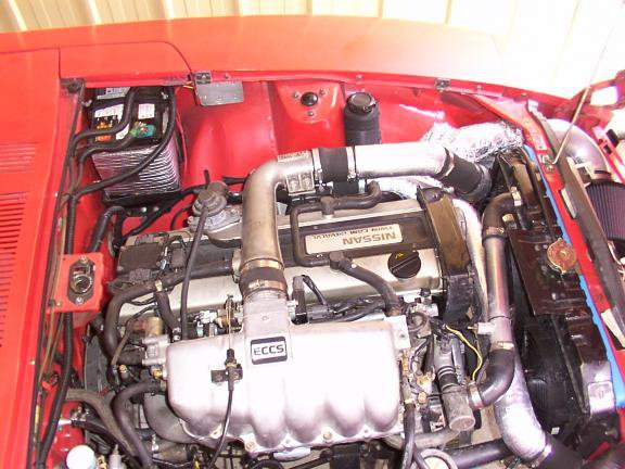

  9. I haven't had time to grab pics from the front of the car yet, but just to clarify a bit, the IC sits in the opening in the radiator support panel, and there is a gap below the bottom tank of ~ 2cm. I'm thinking 2D CFD to look at the interaction of the front bumper, ducting, IC & radiator. Maybe even create a 2D CAD of the centreline of the car to play with front panel work etc. Linux -> Blender (CAD) -> Gerris Solver & Viewer. Here is a pic of the engine bay...
  10. No space for a V-config without removing the rad support panel and a major rework of the coolers. My thinking on the two ducts is that it will a smaller overall entry path into the intercooler/radiator than a single duct with only a slightly smaller entry than the intercooler size anyway. Besides which, the bumper sits right the middle and must cause turbulent flow anyway. Less air in a diverging duct should slow the air and make it work more effectively - shouldn't it? And reduce the pressure build up in the engine bay (with appropriate undertray). As background - my car overheats once air temp goes over 32C. Was 28C before I moved the number plate down onto the front spoiler and removed the grill. Main problem is I only have space for thermofans, and they just can't flow enough air. Two years ago I did water manometer testing and the only high-pressure areas were in front of the intercooler and the 2cm gap in front of the radiator below the intercooler. I've been sitting on the issue for two years, because I haven't had time to do anything constructive about it, and didn't want to blow $1KAu on a custom alloy rad. And I cycle to work in summer anyway... I'll dig some pics out later...
