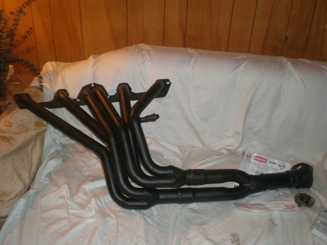

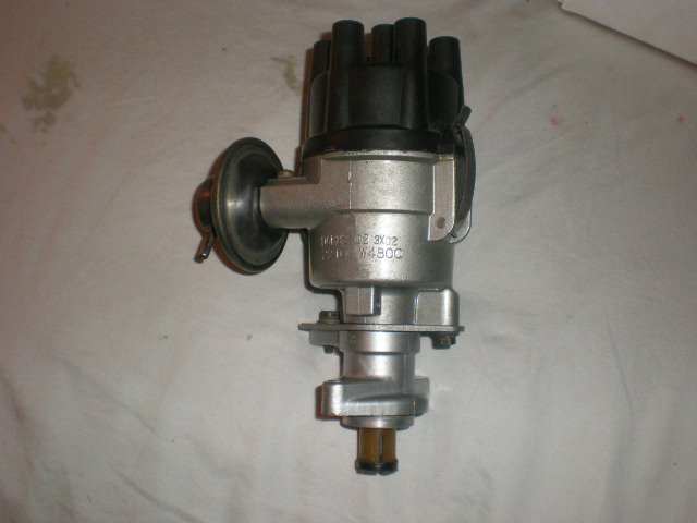

  4. Called Modern Nissan in Concord N.C yesterday and was told there was one breaker plate assembly part number 22136-h9501 left in the country for $92.81 list and my wholesale price would be $74.25, and the only way to know if it was still available was to order it and wait until today to see if it went through. I got the call form the parts dept. this morning and was told to come pick it ,they even covered next day air since it was for a commercial wholesale account ,hope there are more to be found ,if not my next build for the 77 will have to get a reman. or go edis I also got my header in today.

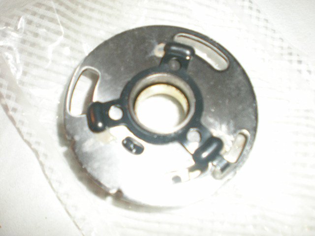

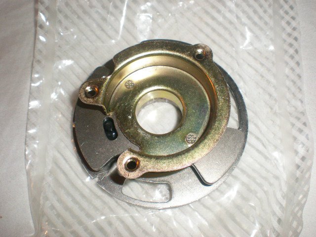

  5. Quote ((These parts are no longer available. But if anyone know's a source let me know. the stamp is how many degrees of mechanical advance. If the unit has 8 stamped on it, that is 8* of distributor advance, which translates to 16* of crank advance. __________________ 72 240z. 75 2.8l, 79 5spd, R200/3.90's, 280zx rear brakes, headlight relay mod, hella h4's )) Called Modern Nissan in Concord N.C yesterday and was told there was one breaker plate assembly part number 22136-h9501 left in the country for $92.81 list and my wholesale price would be $74.25, and the only way to know if it was still available was to order it and wait until today to see if it went through. I got the call form the parts dept. this morning and was told to come pick it ,they even covered next day air since it was for a commercial wholesale account ,hope there are more to be found ,if not my next build for the 77 will have to get a reman. or go edis
  6. I have found another 81 dizzy I am going to get tomorrow and check it also ,I also found another n42 cyl. head and intake non egr that I can get for $75.00 complete head and intake. I allready have one n42 non egr intake and head I will probably go ahead and get these to help out other HBZ members ,I cant post classifieds yet but if anyone wants to call me my number is 704 719 7439 E.S.T .
  7. yes I understand what the stamp means I have only heard people speak of the 8.5 or 9, this one is stamped 9.5 which would be 19* of crank advance .Thanks for the answer ,just curious if anyone ever saw a 9.5 plate before. And if so what did it come out of? this appears to be a standard 2.8 81 model dizzy. D6K82-G2 3X02 22100 W4800
  8. Anyone know where to find dizzy parts for a 81 280zx ,I need the breaker plate,ball bearings and magnet that goes under the stator,I am going to call Nissan tomorrow but would like to find them elsewhere if possible . I know that cardone has a reman for about $135.00 at a$$holezone but I would rather rebuild mine . I am assuming the po had it apart as the ball bearings are missing from the upper plate which is broken and pieces missing, and this one has 9.5 stamped on the mechanical weight plate as opposed to 8.5 or 9 anyone ever saw this before? This is a D6K82-G2 3X02 22100 W4800

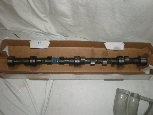

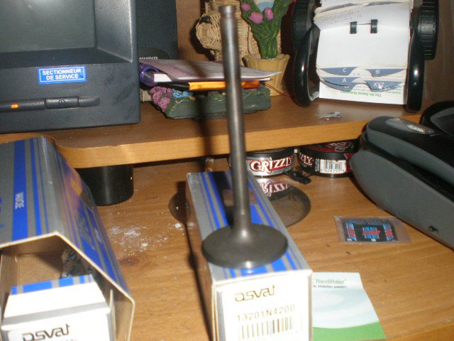

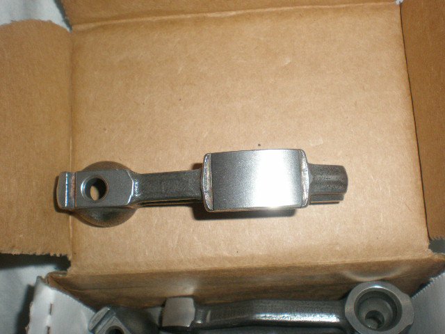

  10. reground cam and followers from Delta Cams. I am still waiting on my new n42 model intake and exhaust valves,my MSA header 6to2to1,my shims from goodson supply,new .180 lash pads,and my body seal kit and pro urethane bushing kit.

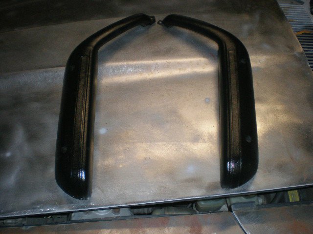

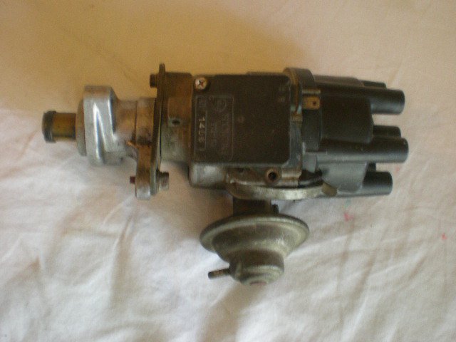

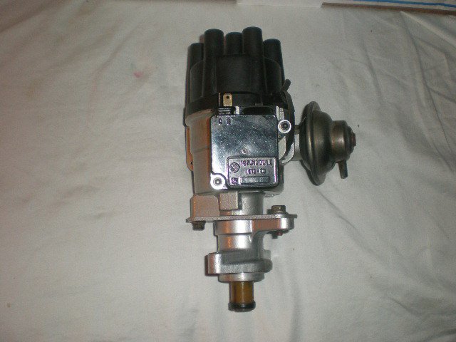

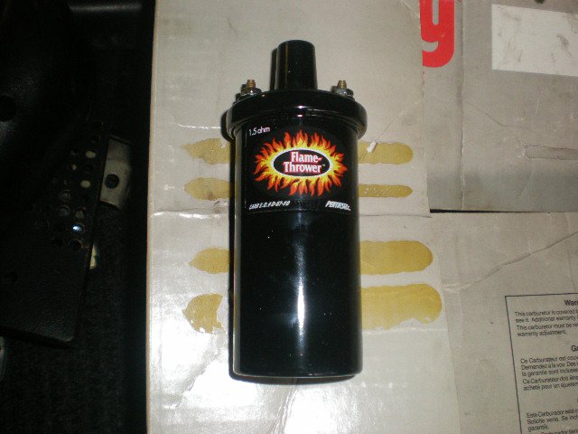

  11. more pics refinished dash,arm rests and my new to me used 81 dizzy with e12-80 ignition and my new pertronix 1.5 ohm epoxy filled flamethrower coil.

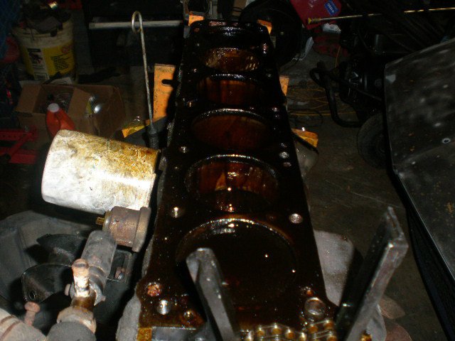

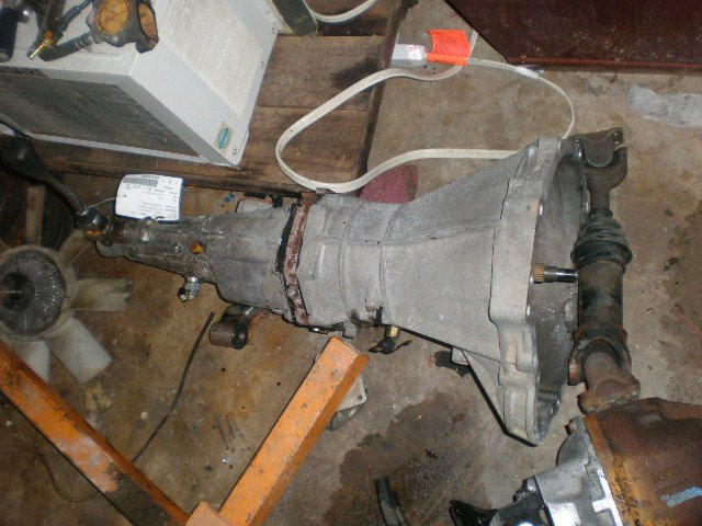

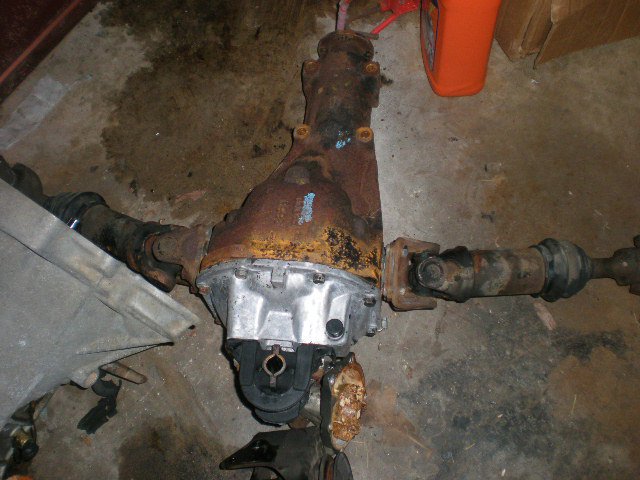

  12. Here are some before pics of the intake and carb. and some more parts, 83 model 2.8 with flattops the top of the block has been sprayed with cosmolene to prevent rust . 83 model 5 speed and rear r200 3.90 gear. more to come

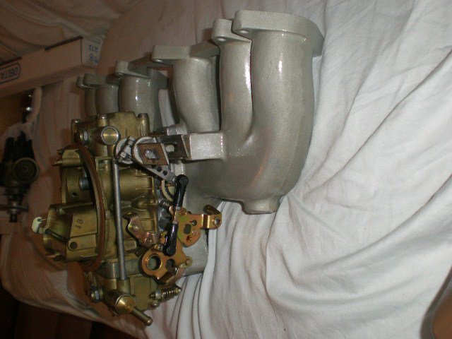

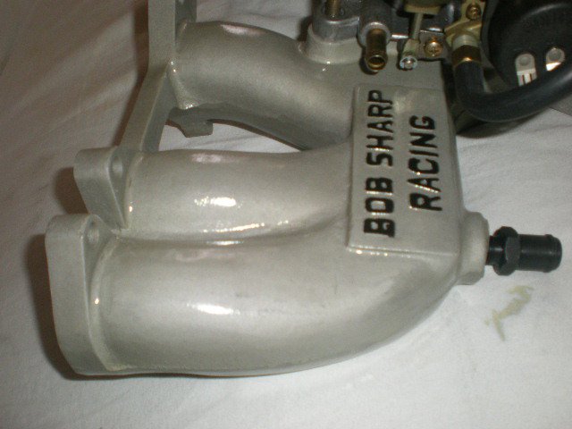

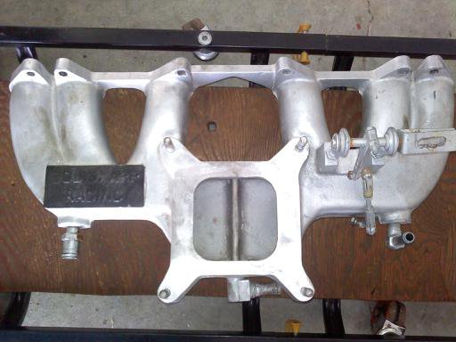

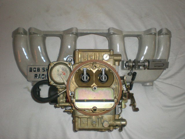

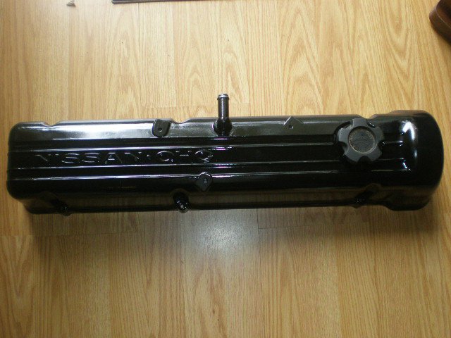

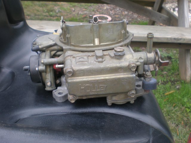

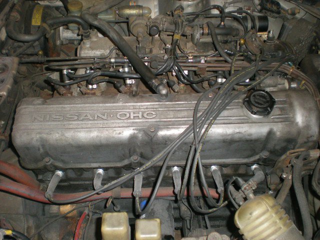

  13. Just thought I would post my first Z build,these are the parts I have gathersd so far ,and the progress on cleanup on a few pieces.First picture is the stock 2.8 that is in the car currently. 2nd 3rd and 4th pictures. are the Bob Sharp intake and holley 390 after cleanup and rebuild. 5th is valve cover from 83 model after cleanup and semi gloss back paint. I will pozt more as the prozect progrezzez.LOL

  21. That is exactly what I am looking for a very quick holeshot and decent topend I feel that with this tranny I can obtain a happy medium, with the happy part being takeoff and the medium being topend useage!Thanks everyone for your input. I have sent a P.M. to Braaap to see if it is allright to post in the classified I have some parts I think some of you may want at a great deal,I have been a member long enough but don't have my 40 posts yet ,So hopefully I will be allowed ,and if not I will post what I have left after I receive my 40 post mark,and thanks once again.

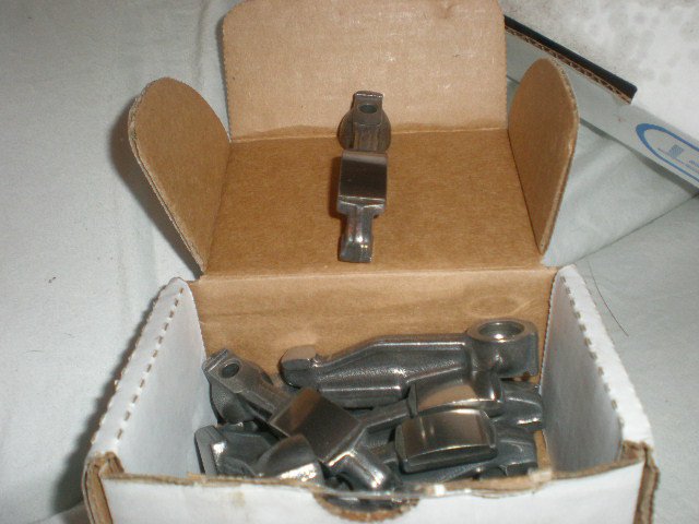

  22. I had my 83 stock nissan cam ground to 274 duration which is 234 @.050 with .464 lift and 10 followers reground bought 2 matched reground to go with my 10 and had the pin repaired and it only cost $135.00 plus shipping. The reason i only had 10 was that 2 had been stolen at the local pull a part before i got there to pull the engine out, you have to keep an eye on the cars as soon as the come in if you want to get what you need,the 5 speed had been pulled and the afm but i got the engine and 3.90 r200. But I think that Delt cams prices are killer. Pull a part is pretty good also
