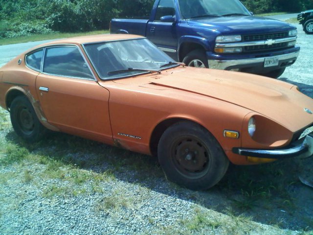

Great topic. My lady is the reason i'm into these cars. I used to race motocross AMA District 7. I had a terrible accident a few years ago and had a knee replacement as a result at the ripe age of 28. I sold all my race quads, trailer and gear and didn't have anything to satisfy my hunger for tinkering. I built a few old relic quads, 20+ years old, restored them. About the third one I did she started coming home each week saying "I want that orange car sitting in Laurel". I blew her off for probably a good 4 months. Each week the same line. "I want that orange car in Laurel". I knew nothing about Datsun. Finally I cracked. I rode to Laurel with her on a Saturday to check out this car. It was a rusty beat up 73 240z. I looked it over, laughed and said "well the interior is in great shape, if you want it i'll buy it". So i did. We both worked on it for months. The brakes were frozen, the car wouldn't roll, the right quarter panel someone had taken a sawzaw and cut it out, the motor was locked up all in all a terrible Z. Anyone once else would use it for a parts car. I didn't do my homework. The body work hasn't been done but this car is now my favorite Z. It runs great. Looks like a rat rod but I drive it about 10k miles a year. She drives it whenever she can for work. I now have become so addicted i've bought another 73 240z and its orange. My girlfriend didn't want me to modify "her" car so I had to buy a second one to put a turbo motor in LOL. She to this day says that she didn't realize that I would become so obsessed with these cars. It filled my void from wrenching on my race quads every week trying to get ready for the next moto. She supports what I do and helps in the shop sometimes. She now knows alot more about cars (especially Datsuns) than the average person I would dare say. I am a very lucky guy to have a significant other that is supportive of my interests. Its give and take though. I have to be supportive of well shopping and baking and well all the other girly stuff. I'm thankful to have a great relationship. These cars have brought us both a lot of enjoyment. We go to the cruisin each month locally and take them to Ocean City in the summer. Its fun for us.
