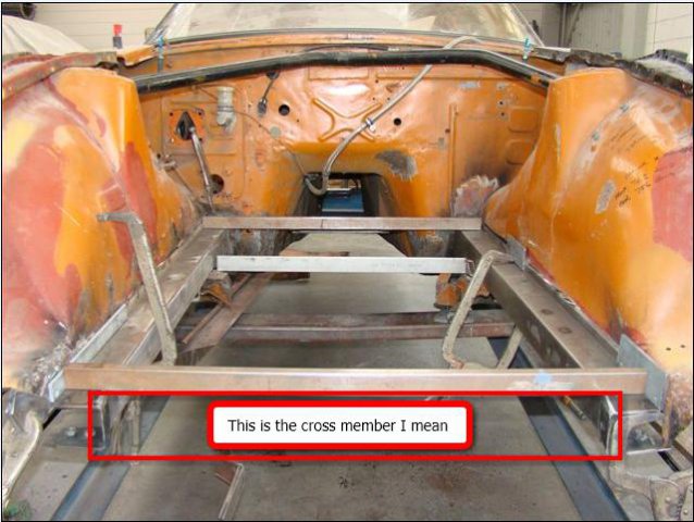

  21. Hi guys, Well finally the 240 is in the panel shop having the frame rails fully replaced. The cross member that runs accross at the very front of the frame rails is in very bad shape, we have cut it right out at this point of the job, and it is really beyond repair. My question is can i replace it with a straight piece of tube, as the stock member has a step down in it. Is this step down needed? what is its purpose? Hopefully we can replace with a straight tube, as this will be so much easier. Note: my car is a race car, that will be far from stock, so will not be using the stock radiator or anything.
