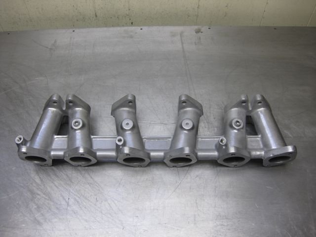

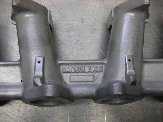

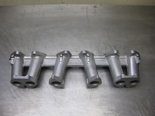

Upon further review, I dont think the Mangolesti in the picture is the same casting. Note that piece sticking up near the upper front bolt on the left of the picture - not on mine. Also, the casting curves towards the carb mount - it even continues into the front and rear carb's ports! The brace part of the casting that connects the carb ports looks different - even when I squint my eyes!

Dtnslvr - I think that you are right! I did a little Googling with your info and found Mangoletsi manifolds. No pics that I have found other than yours and mine. Would have been nice if that link had a picture of the top or even the bottom. I have a feeling that the manifolds might have been sold under a different name here in the states. Thanks a lot for the info!
I have snatched some very good pictures of the intake manifold that I have had on my car since '76-'77. I bought it new from Bap Geon and my receipt does not have the name on it! I have no intention of replacing it or my DCOE40's. I am only curious if it can be used with other carbs or ITB's etc. Please post if you have any history or knowledge on this intake manifold! Thanks much!
