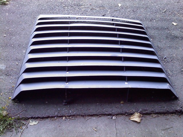

I think it would greatly. If it's the same, maybe I just need louvers for the first half of the ZX's. Thank you for your response!
I really like how this is turning out! Any chance you'd want to hop over to Kitsap county to make one for my S130? Lmao. Seriously, though, it looks great! I'd love to drop by and see it when it's done. It looks close to what I've wanted my front end to look like for a while now. I wouldn't want to steal your ideas, just do something similar.
I am unsure as to wether they were a factory option, but it would appear that I have a mounting strip for a set of louvers. I had forgotten to mention, the louvers get wider the farther down they go. They are about the right size for my window up near the top of the hatch, but near the bottom, they are nearly as wide as the hatch itself. I'm unsure if this is due to it laying flat for an extended period of time or not. I will take pictures of my "louver mounting tab" in the morning and post them here.

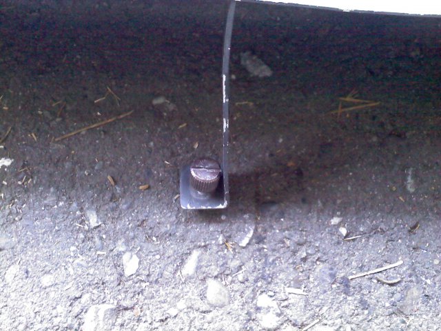

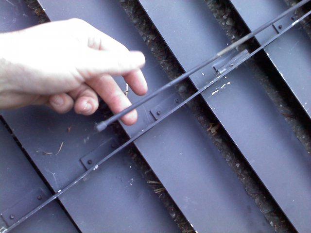

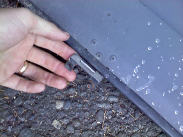

Alright, so I picked up these louvers: from a guy that said he pulled them off of his ZX. I took them home, and realised that they wouldn't fit my ZX. First off, the mounting area that I have is a metal strip across my hatch window with two sets of bolts and nuts. The mounting hinges on these :are in the wprng spot by a few inches. Also, I don't have any areas for the bottom part of the louvers to screw into. This louver set has four thumb screws that are supposed to screw in : . These louvers also have two little props for cleaning the window :. Can anybody tell me what Zcar these might have come off of? If a ZX, was it the later model? The ZX I bought them for is a '79. Are these just a custom mount kind of deal regardless? Thanks for any info!
