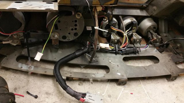

  3. Quick text update. I've got my dash wired up and the car wiring to match. No the only thing left to wire is the ass end of the car, then I can pull the motor and finish the fuel system and engine bay and then I should be nearly done.

  11. 5 Month bump, for shits Almost nothing has gotten done in the last few months, I got some minor wiring projects done, mostly just got the fuse box mounted and wired the column controls. I have been away for school via my job, so i havent been able to do anything to the car, besides dream and get myself psyched up to get it running. I go home this weekend, and my goal is to get it running solid before i come back up for school again in january Anyway, i decided that i was unhappy with the cheap ass connectors that i bought, so i spent way too much money and bought a set of DEUTSCH DT weatherproof connectors with a tol as seen here http://www.amazon.com/Deutsch-Connector-Kit-451-With-Crimp/dp/B006QMKPV0/ref=sr_1_8?ie=UTF8&qid=1413164715&sr=8-8&keywords=deutsch+DT+connectors I got a 300 piece kit for 100 bucks less, still is an asston of money though... I work for caterpillar, and ive seen these connectors used, and the way they work, how easy they are to pull apart, and how well the crimp tool works made it a nobrainer for me to spend the dough and pony up for the kit. Should make for a much nicer install then the cheapo split crimp disconnects i got. Anyway heres a short list of the things that i can remember that i need to do on the car -Finish wiring, Basically everything in the dash, all the front and rear lights and the alternator, battery, ETC. Luckily the column controls and the ECU are almost entirely wired, so ive at least got a start. -Once the wiring is finished, Remove the motor -Minor refinish of the engine bay, basic smoothing and paint. -Finish the motor mounts, if im feeling insane i may redo them, as im planning on getting a better TIG/Stick welder combo, and im not 100% satisfied with the quality of the MIG welds on my current mounts, or the design for that matter. Same with the trans mount, which is ugly as sin. -FInish up lines for the motor, mostly just sorting out heater hoses, -Run fuel lines, IM currently debating whether or not to keep the High presure pump behind the passengers tire, or to move the surge tank and HP pump to the spare tire well to cut down on the fuel lines at the front of the engine... Its something i will have to debate before i get back home. I think if i do that, i will probably build a custom surge tank with an in-tank pump, or maybe even modify my gas tank to be in-tank to cut down on the clutter... -Disassemble the trans, and swap it to my modified shifter, which i may cut apart to ensure that the welds on the extension are up to par. -Fix the gaping chasm of a trans hole that i had to butcher together. -Reinstall the motor, get it running, and ruin my tires... Overall theres not too much work left to get this thing running, my only problem will be finding the time to work on it, however if i can get my other project sold, the Z can get the garage space and it will be much easier to work on it.
