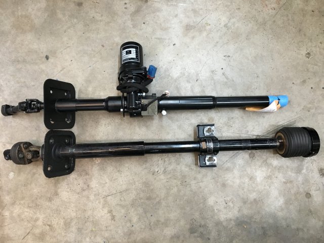

	http://www.ezpowersteering.nl/ The electric power steering from this company works great in a 1976 280Z. Direct swap with zero modifications required. Highly recommended. D374F924-A3A4-481A-B580-46EF26E66686.MOV
