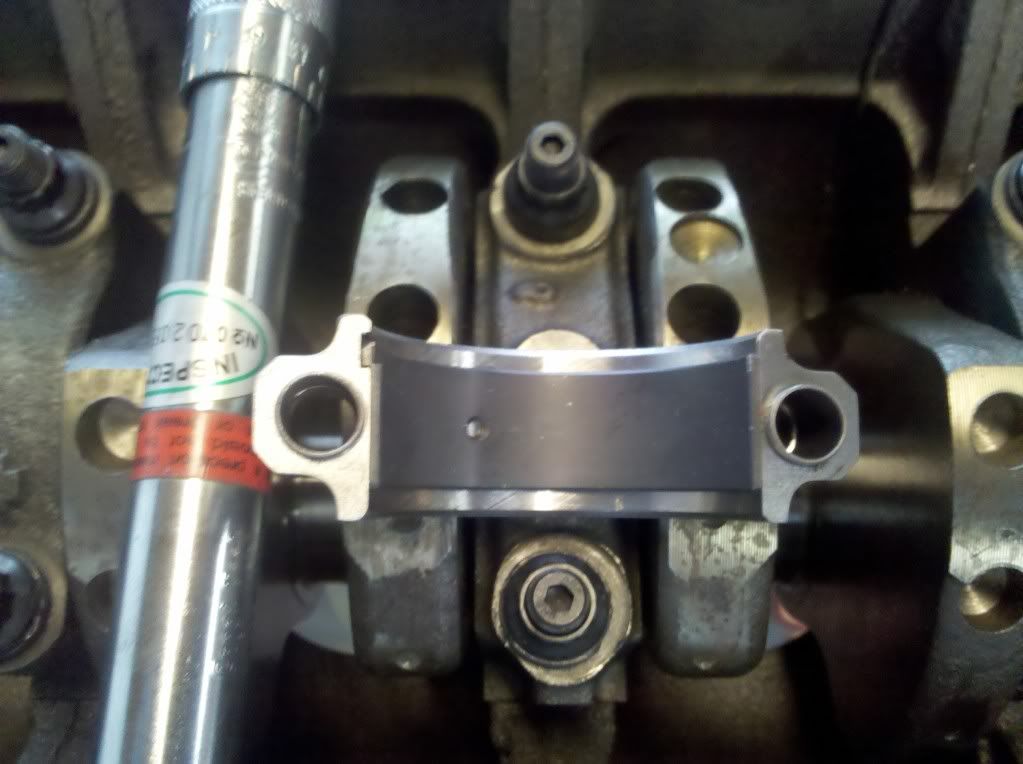

zack_280 Posted June 19, 2011 Share Posted June 19, 2011 (edited) Can someone let me know if these rod bearings are the wrong bearings? I know that they look wrong, but this motor was built by people who build good motors (Sunbelt). Take a look at the picture below. Notice that the bearing is has a smaller width than the rod 'seat' and the tang is much smaller than the indent on the rod. Other than the fact that they look wrong, they have been on this motor for some time and they appear to be in good shape. Due to the fact that Clevite bearings are not in stock anywhere that I can find, I would prefer to reuse these. Thanks again, Zack Edited June 19, 2011 by zack_280 Quote Link to comment Share on other sites More sharing options...
johnc Posted June 20, 2011 Share Posted June 20, 2011 they have been on this motor for some time and they appear to be in good shape You've answered your own quesiton. Quote Link to comment Share on other sites More sharing options...
Tony D Posted June 20, 2011 Share Posted June 20, 2011 (edited) To directly and honestly answer your question: Yes, they are the 'wrong' bearing. They are not the bearings that are 'supposed to be in there' if that is your definition of 'right & wrong'....but before you chuck them into the shed's bin... Please look at some engineering texts regarding reducing bearing frictional losses within I.C.E. and you will have your enlightened answer. Damn, another secret is let out of the box for those who can see it! Edited June 20, 2011 by Tony D Quote Link to comment Share on other sites More sharing options...
zbloke Posted June 20, 2011 Share Posted June 20, 2011 Secret noted and stored away for future reference thanks! Has the cap been modded, some sort of alignment bushing, around the stud/bolt holes or are my eyes playing tricks on me? Quote Link to comment Share on other sites More sharing options...
johnc Posted June 20, 2011 Share Posted June 20, 2011 Bad Tony! Go back to your room! FYI... Its most likely not a Nissan rod. Quote Link to comment Share on other sites More sharing options...
zack_280 Posted June 21, 2011 Author Share Posted June 21, 2011 Thanks again for your answers. I'm going to read a little further into this, but it makes me feel better about re-using them. Even more so since I've already put the pistons/rods/bearings back into the block. As you guys have probably already noticed from my previous posts, I am far from an expert. But I can read gooder than some people and I can soak up the info from the wise counselors here. The rods are not Nissan. I'm not sure exactly what manufacturer they are. Zack Quote Link to comment Share on other sites More sharing options...
inline6 Posted June 25, 2011 Share Posted June 25, 2011 Hi Zack, Your bearings look like the ones that are going into my motor. They center up into the bearing bore just like your pic. My rod bearings are from a Toyota Camry 2VZ-FE engine (same as Lexus). I am building a 3.0 liter with a reground stock L-28 crank, Toyota Celica rods (See John's note about non-Nissan rods) and custom pistons. I was able to order rod bearings (Clevite 77 with coating) from Calico Bearings. Garrett Quote Link to comment Share on other sites More sharing options...
