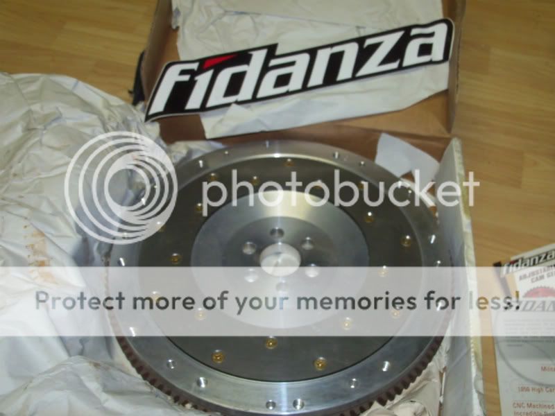

Leon Posted November 27, 2011 Author Share Posted November 27, 2011 Quick update: Scooped this off of ebay! Looks like a clutch job and transmission swap is in my near future! Quote Link to comment Share on other sites More sharing options...
luseboy Posted November 27, 2011 Share Posted November 27, 2011 Thats awesome! How much does it weigh? Quote Link to comment Share on other sites More sharing options...
Leon Posted November 28, 2011 Author Share Posted November 28, 2011 Thats awesome! How much does it weigh? I believe the Fidanza units are 10.8 pounds. This is compared to a stock flywheel which weighs in at something like 25lb! Quote Link to comment Share on other sites More sharing options...

Leon Posted December 7, 2011 Author Share Posted December 7, 2011 "Are you going to get the special bolts from mcmaster carr?" Please enlighten me on these. I have that same fidanza lightened flywheel. Apparently, the holes in the flywheel for the pressure plate are not tapped deep enough for the stock bolts. If this happens, you must use shorter bolts in order to make sure that the pressure plate is clamped down properly. http://forums.hybridz.org/index.php/topic/57299-ordered-a-105lb-fidanza-flywheel/ http://forums.hybridz.org/index.php/topic/100321-fidanza-flywheel-act-clutch-install-and-pedal-mods/ Quote Link to comment Share on other sites More sharing options...
