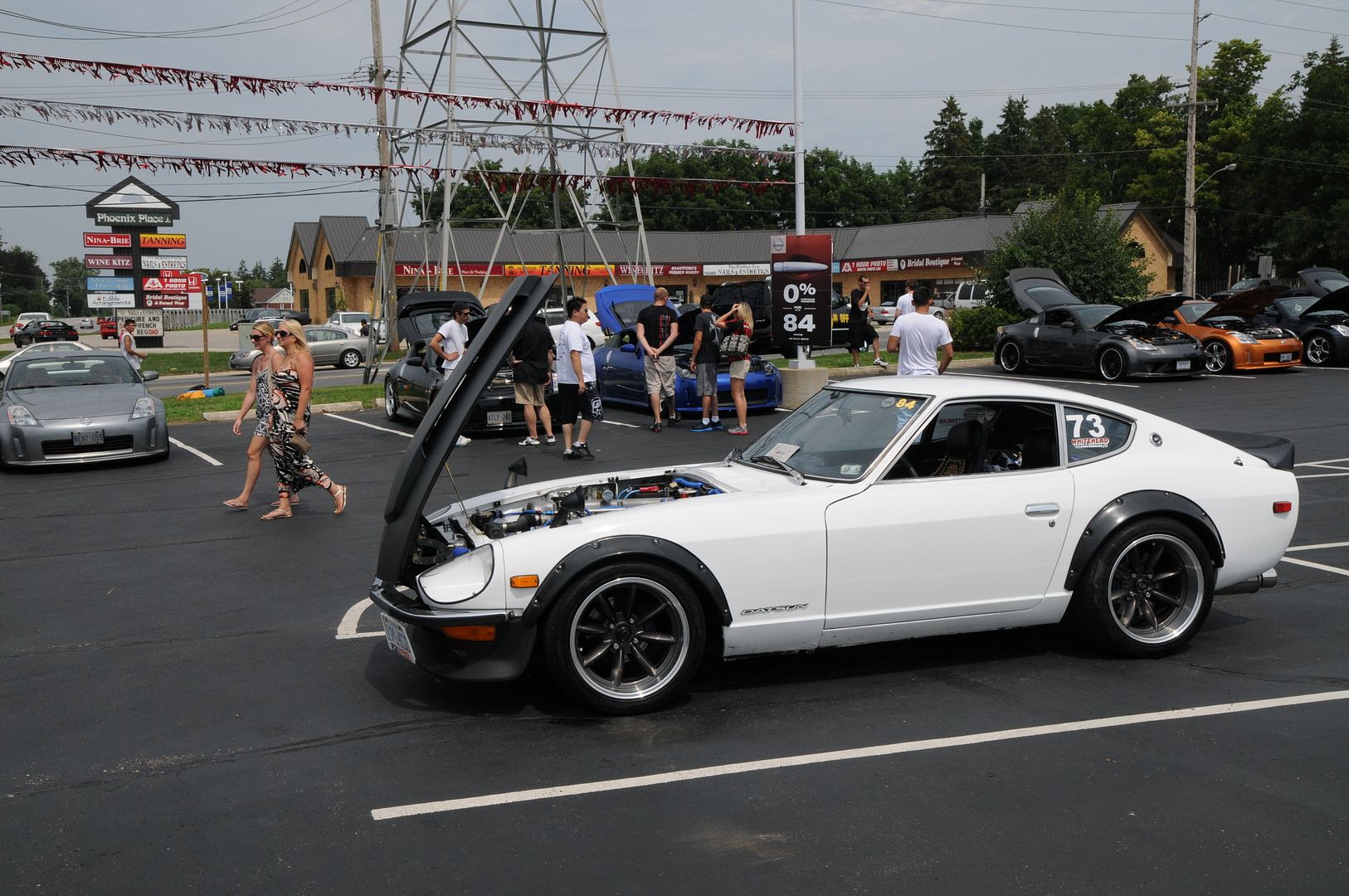

billseph Posted August 30, 2011 Author Share Posted August 30, 2011 http://www.motortopia.com/files/11549/album_datsuncompetitionhoodvent/4df7c7fc988db/IMG_0991sml.jpg I'm looking for a stance similar to this...maybe a little lower if possible. Anyone know if this car looks to be significantly lowered compared to stock?? The one Z I have with suspension on it is WORN OUT, so I dont know what to compare to. Thanks for all the input you guys have given. Quote Link to comment Share on other sites More sharing options...
Nigel Posted August 31, 2011 Share Posted August 31, 2011 (edited) http://www.motortopi...IMG_0991sml.jpg I'm looking for a stance similar to this...maybe a little lower if possible. Anyone know if this car looks to be significantly lowered compared to stock?? The one Z I have with suspension on it is WORN OUT, so I dont know what to compare to. Thanks for all the input you guys have given. That's my car. That picture was taken when I had Eibach springs and KYB struts. I now have the Arizona Z-Car coilovers, and it was dropped a bit more. I mounted the rear flares a little higher than it turned out I needed to. I'll probably lower them 1/2" to 3/4" at some point, which will make the car look even lower. Nigel '73 240ZT Edited August 31, 2011 by Nigel Quote Link to comment Share on other sites More sharing options...
