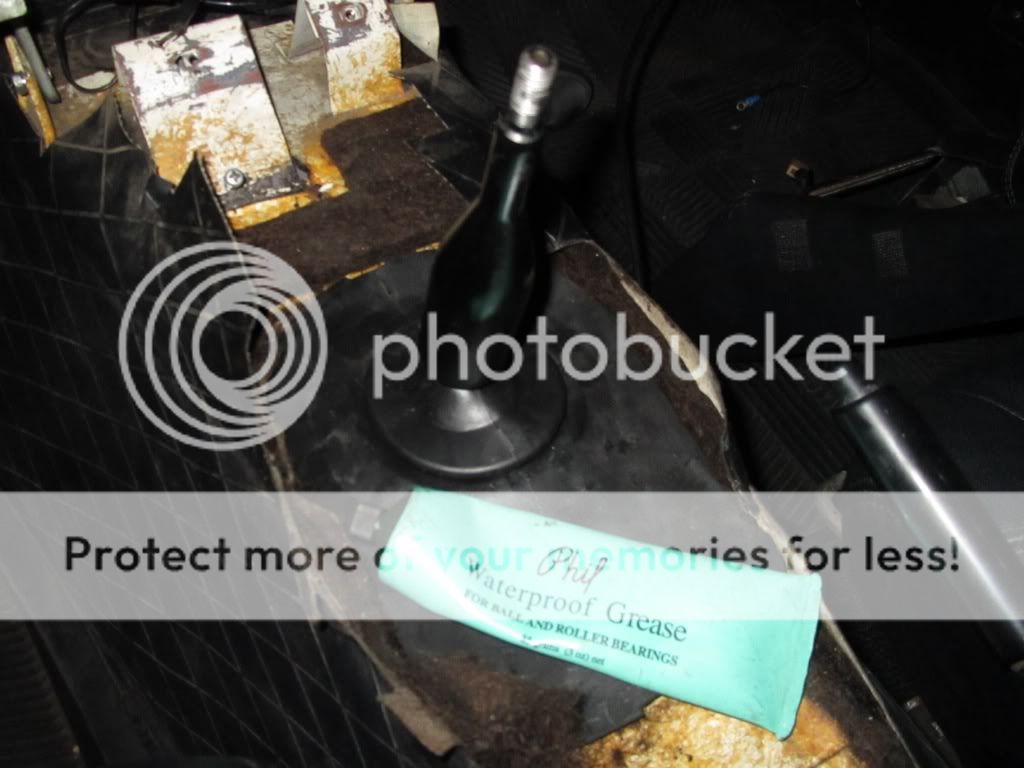

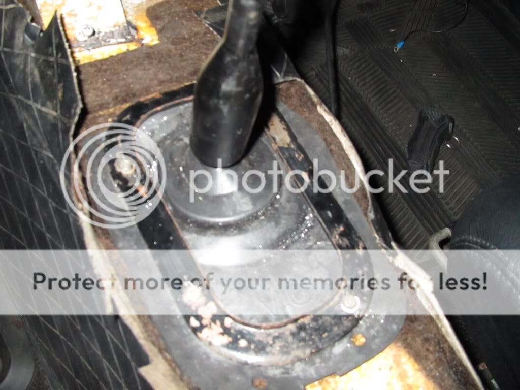

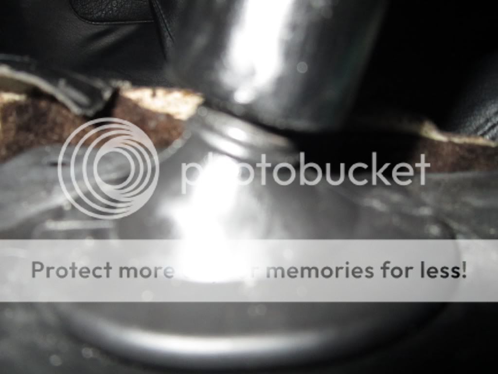

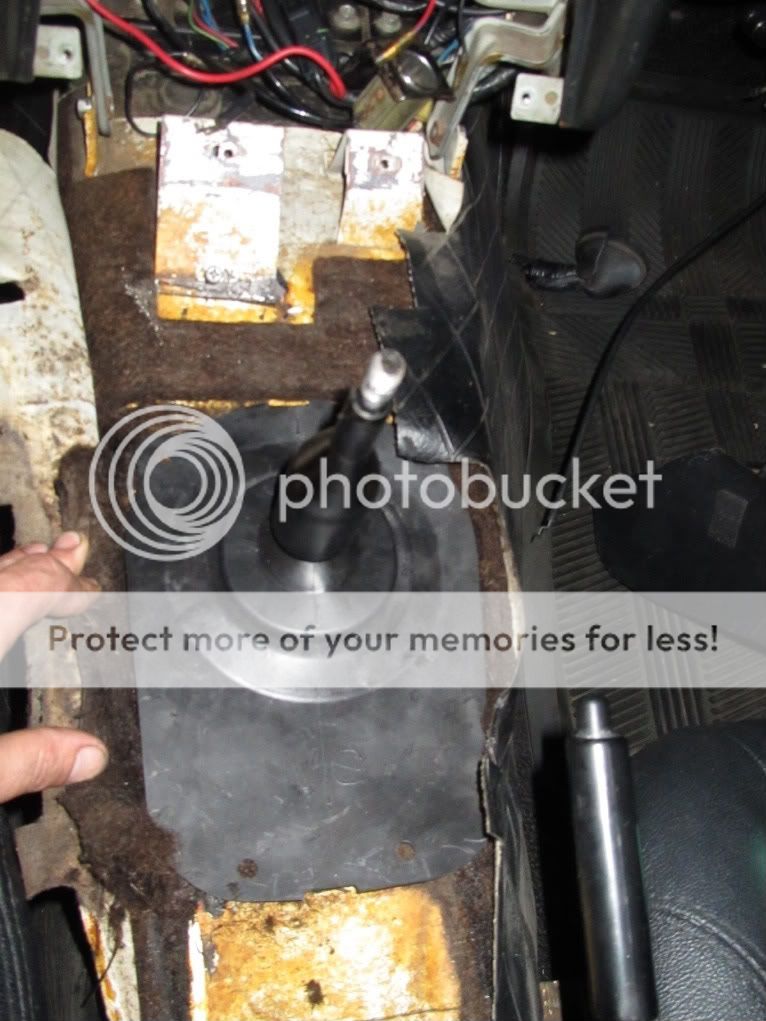

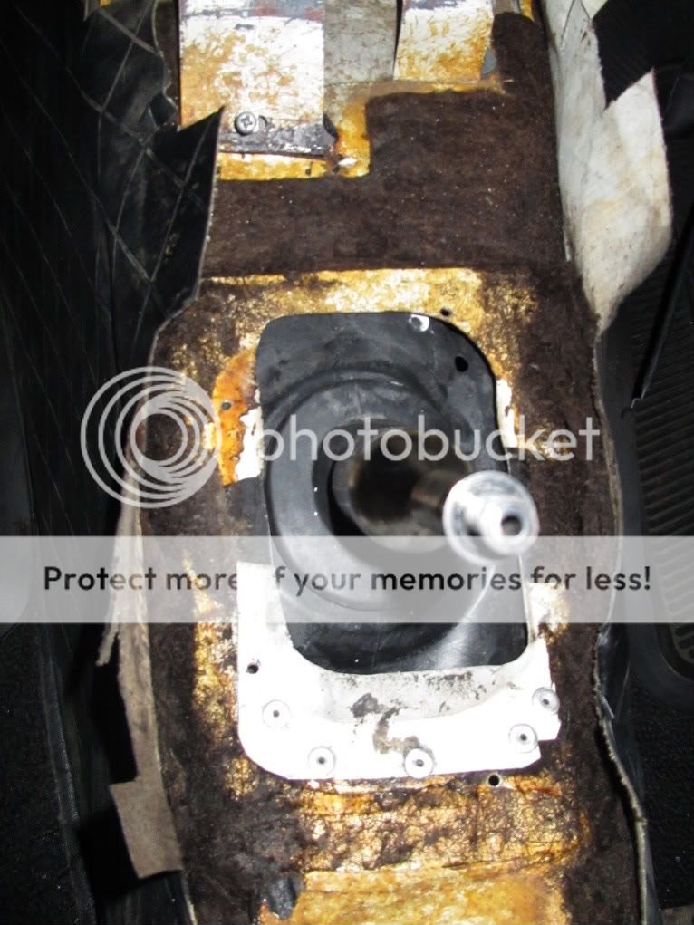

wrcbonk Posted November 12, 2011 Share Posted November 12, 2011 Wanted to write this up quick before I lost the motivation. Needed to come up with a shift boot for my RB transmission that would seal adequately and fit the new trans in my S30. I decided to order the shift boot from an 84-84 Z31 VG. Wanted new rubber so I forked out and ordered it from MSA. To keep the boot in place I needed a plate. I was able to get a plate from a 260z from a friend. I ordered a leather outer from the same place as Rayapp. To get the VG boot over the RB shifter isolator you just need some lube. Drilling the holes was fine except for the front right corner. The PO cut away some of the tunnel putting in a 280z 5 speed tranny. The hole is very close to the edge, I used a smaller diameter sheet metal screw and won't think about it. I am not going to make any more predictions about when I am going to start the car, I'll just post a video. Bonk Quote Link to comment Share on other sites More sharing options...
