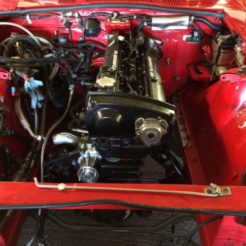

  7. For what its worth the McKinney mounts do "place" the motor spot on Am finishing fitting an RB30 to mine and I couldn't have asked for a better fit - engine n box wise Previously used an RB25 but the 30 seems to fit even better which sounds odd lol

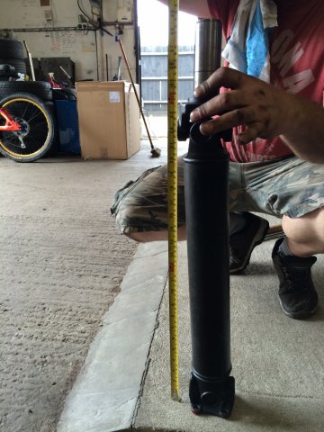

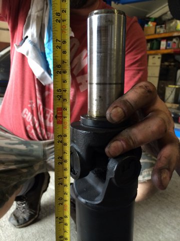

  14. Few pics Using McKinney mounts (RB25) but think they're the same as RB26 anyway For others that might need to know prop length shown is with a GTST box and GTST diff flange As it goes I think the std Z diff flange has the same depth anyway, so measurements should stay about the same Would deffo advise you check your own measurements before you weld anything mind Have fun
