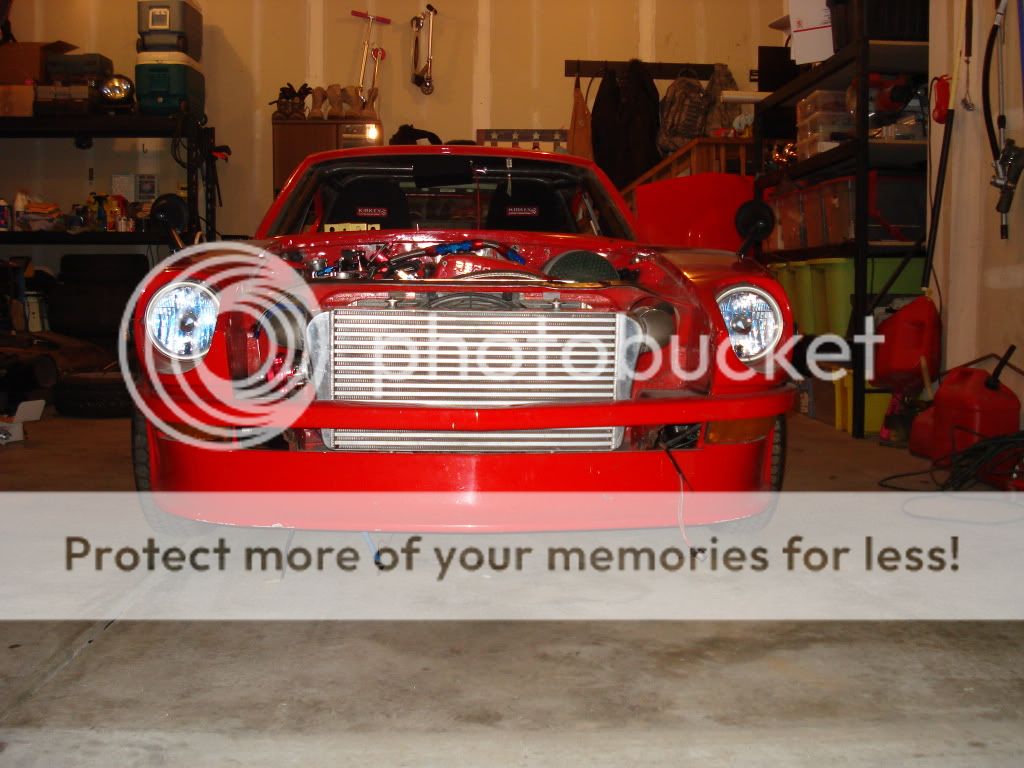

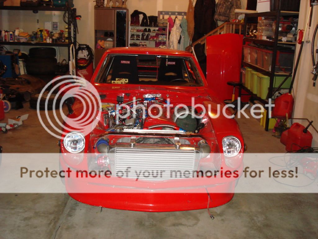

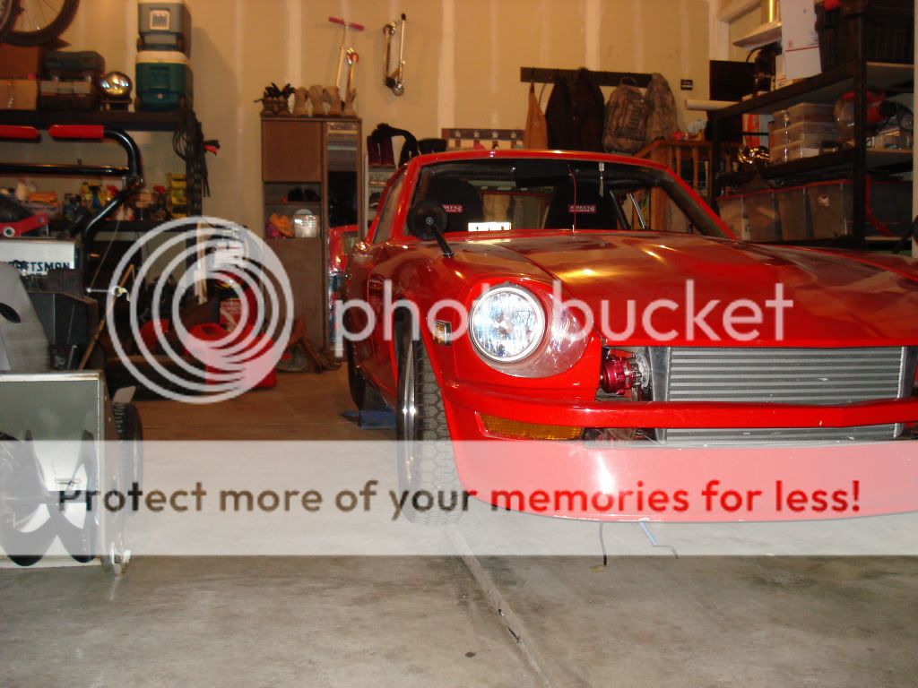

I will proabably get slammed for this but oh well. i used a simliar one to this and it has supported 700WHP!!
Yes it may not be AS efficient as a 1500.00 intercooler. and it may be a tad heavier but you cant beat it for 150 bux. I cut the ends on and had really tight 90s welded on to point right at the holes in the core support. fits pefiect. I didnt use this exact vendor so you need to look around but i think they are all pretty much the same.

I can personally stand behind these cheap internet intercoolers. The China intercoolers being pedaled by cxracing, fastwayracer(EMUSA and all their affiliates), and OBX-R(and probably more) will work just fine. With one of the medium sized intercoolers and one of the larger GTR(R33/R34) style intercoolers Im seeing average 10* drops across the intercooler on the dyno which is great considering the value. The last one I bought cost me $130 and Ive seen them go for $80 or less on ebay. You just have a look around. I have had several stock RB25 and RB20 intercoolers and there is no practical way of mounting and plumbing them without hacking an S30 up significantly in the front. Just make sure that what ever intercooler you get to check for temperature drop across the tanks/core and in multiple spots. I was very suprised to find that much drop across these cheap ones.
