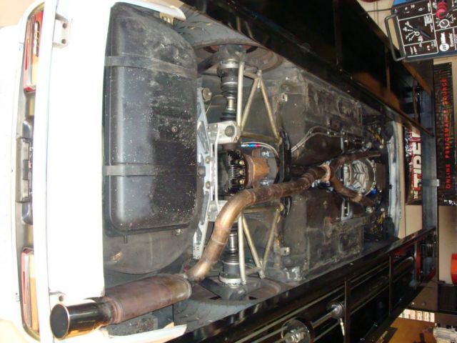

1 tuff z Posted February 20, 2012 Share Posted February 20, 2012 So now that my long tubes have finally arrived been thinking about the rest of the exhaust. My current setup is dual 2.5" into a single 3" [just aft of the tranny] into a single 3" in/out offset summit racing muffler. Entire system is T304 SS mandrel. Like to hear from the rest of you who got on board with our group buy as to what you've planned! pic of my current setup Quote Link to comment Share on other sites More sharing options...

Litman Posted February 22, 2012 Share Posted February 22, 2012 Clive, I think it will be difficult to position the F-body fuel tank to allow center exhaust. Wish you had asked this question last week. You could have stopped by to try it on my car. The attached picture may not show much but I can mount the tank and take more images from your requested angles. I have the tank fipped 180 degrees to put the fat end near the diff and and the fuel fill on the correct side. Quote Link to comment Share on other sites More sharing options...
EvilC Posted February 22, 2012 Share Posted February 22, 2012 Craig thanks! I would of loved to stop by with the gf. Maybe the next track day we will stop by. I am going to get her on WGI. Anyway back to tanks, looks like the only way to have the center exhaust would be to mount a fuel cell. Craig can you just snap a pic of the top side (from the hatch area) so I can get an idea of space there is to maybe go forward with the f body tank. I am sure it is tight and would make sense to try to wrap around the tank. J - looks like I have to start drawing the new exhaust on paper. Not in a rush because I have to save for a new set of heads to go with the cam, intake and now exhaust! lol Quote Link to comment Share on other sites More sharing options...

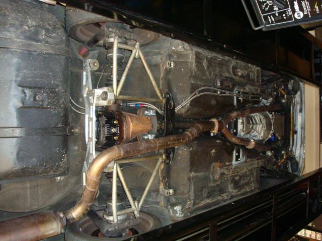

Litman Posted February 26, 2012 Share Posted February 26, 2012 Craig can you just snap a pic of the top side (from the hatch area) so I can get an idea of space there is to maybe go forward with the f body tank. I am sure it is tight and would make sense to try to wrap around the tank. Clive, Attached are some images for you to use in your planning. As you can see I have the AZC stuff in place with the R200 diff. Looks like you could inch the tank a little bit closer to the diff but it still might not provide enough room behind to tuck pipes and a 90deg bend for center outlet. My hatch area (topside) is still basically complete so you can't see much from that side apart from the cute little trap door I made. Quote Link to comment Share on other sites More sharing options...
