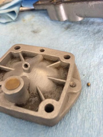

1) When I pulled the carbs off, carb #2 was sending great streams of fuel from the pump when actuating the throttle.  The other two, nada. Nothing.  I pulled the first carb off and checked the pump body.  No rattling present.
The other carb the small brass ball actually popped out.
I am guessing this is not ideal.  They should be able to spray while off the car so long as there is fuel in the float chamber, correct?  I think I need two replacements unless you can advise a way to fix what I've got.
I wondered if my diaphragms had gone bad also..?  The one that sprays makes a nice "squish" sound as the fuel gets primed and sprayed out of the throat.  The other two sound dead.
  Quote
1.     Yes, the pump body MUST rattle.  That is the check ball and is the only moving part that makes the pump body work.  If it doesn't rattle, it doesn't pump.  YOU MUST MAKE IT WORK as it is one of the few items no longer available.  Squirt carb clean in all holes, bang it on the bench, you won't hurt it.  That brass ball goes back into the hole shown in the pix and then gets peened into position.  It blocks off that end of the hole so fuel goes the other way.  Must be put back and secured.  Pump diaphragms may be bad, may as well replace while doing all the other work.

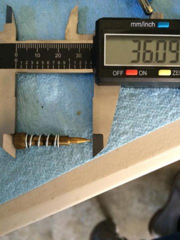

2) Most of my mixture screws look like the following:
I thought these tips looks healthy enough, but can you confirm please.
  Quote
2.    Yes, those pilot screws are "screwed" it's not the length that matters, it's the profile of the taper and it should NOT be stepped  like that.  They are abused and no good.

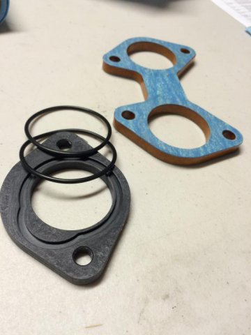

3) I found the o-ring style insulators I'd gotten from you and think they need to go on.  The insulators that came with the Harada intake I'm running look to be potential blocking the brass fittings on the carb body just above the butterflies. They might have not be sealing so great, causing a small leak, leading to my conditions.
  Quote
3.    Yes, probably so, get them on there.

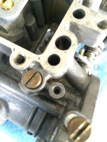

4) Neither the second or third carb has a vacuum advance pipe.  Are these then just openly leaking??  Like a PO just pulled the pipe out?  What to do?  Is it okay to just devise a way to plug it up.
  Quote
4.     Yes, that is correct.  Even though the "hole" appears to be there, it isn't actually drilled thru to the bore, it is only cast into the body to hold the brass pipe but it isn't installed.  It is fine and correct, no need for plugging.

My additional question to everyone here is: do you have any additional techniques to really free the check ball loose in the pump body?
I've been after the two that were seized with carburetor cleaner and a large mallet and have freed them slightly, but in comparison to the one that works well they still 'rattle' less.
