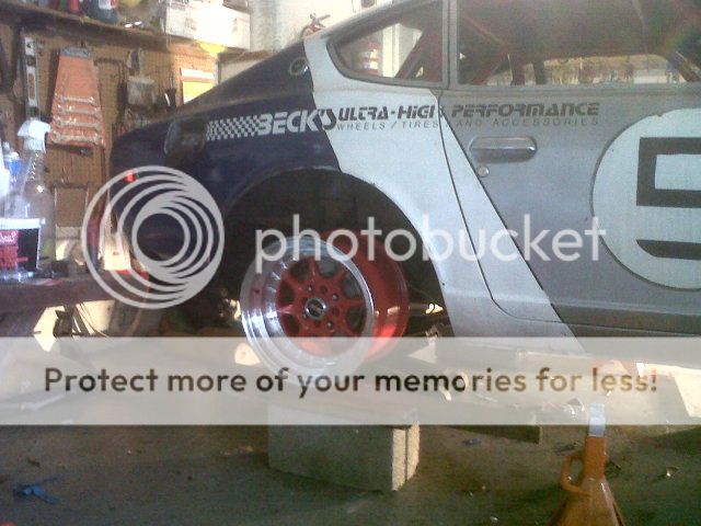

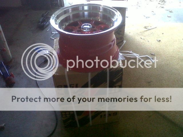

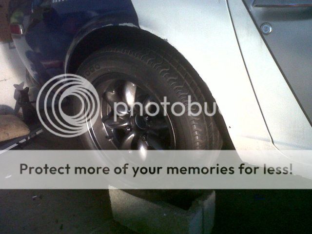

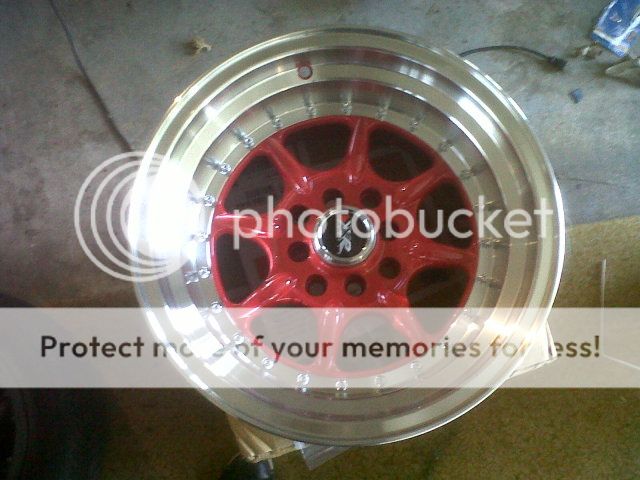

9) Tires for the panasports, and better lug nuts. 205/15 fronts, 225/15 rears

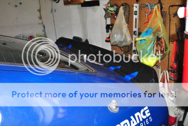

10) MSA front bumper with the 240z turn signals, MSA carbon fiber spoiler, and ZG flares.

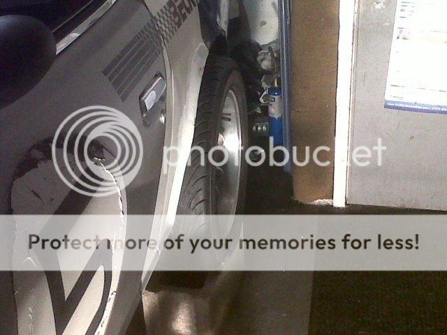

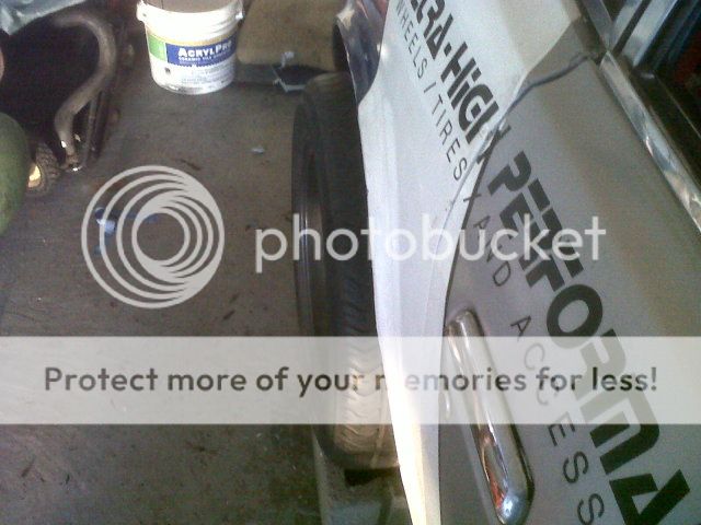

Pics when I first go it:

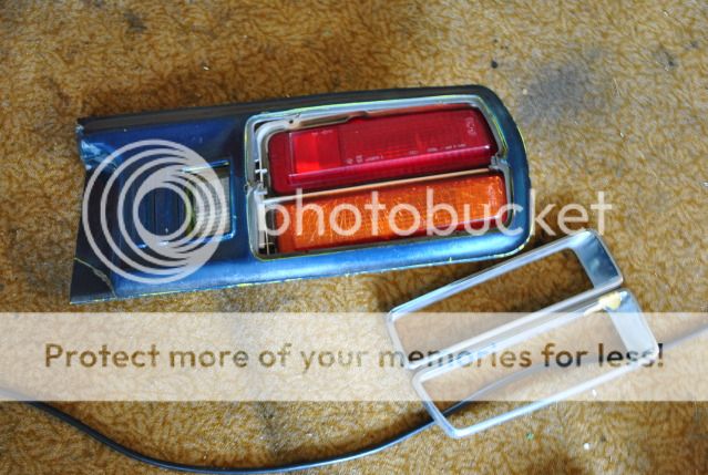

Took the disgusting bumper shock absorbers off. Did a bit of cleaning and dropped the intake+exhaust manifold, gas tank, and tranny. Looking to pull the motor to make life easier.

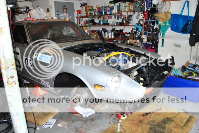

Still havent ordered anything, but this is how she sits right now:
^ Got some cleaning to do.

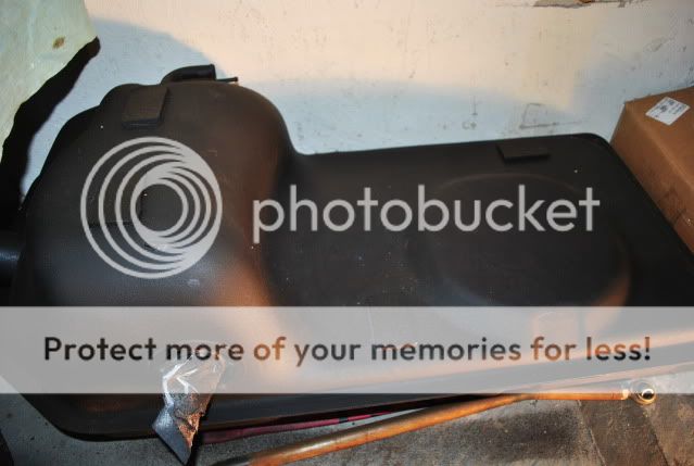

^Brought another 76 gas tank, which are RARE, but turns out it had a pin hole leak. Decided what the hell, and will restore my tank instead since it it nicer.

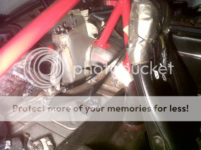

^ I think the "withdrawl lever", the metal spring type thing might be bent out of shape.
^ Clutch looks to be in place lol.

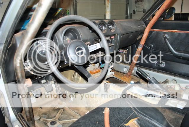

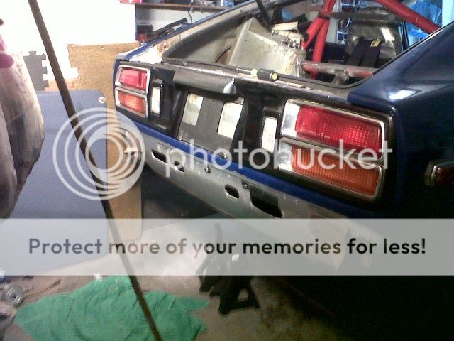

^ The only rust spots on the z. One of which is from scrapping the pavement, the other is a common area. In which the drain gets clogged, both are easy to fix and not serious.

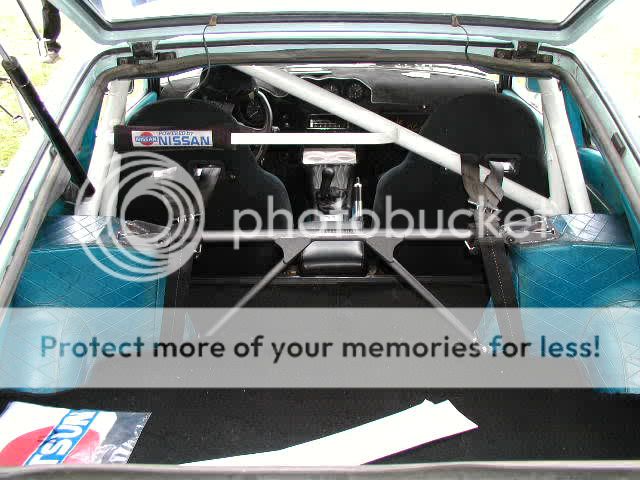

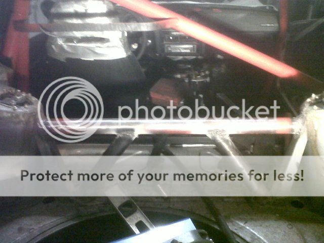

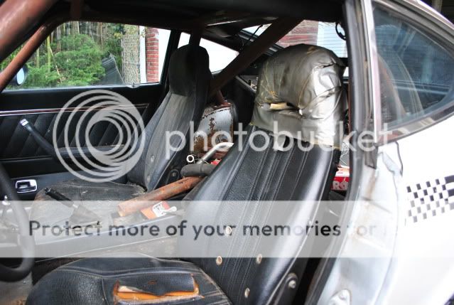

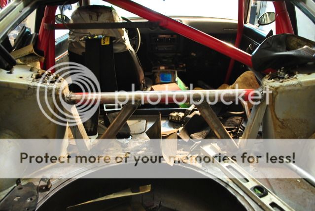

^ Took out the stupid knee bar, looks much better. The roll cage is SO tight ti the body, that the driver side rood liner is melted from the rubbing friction against the cage.

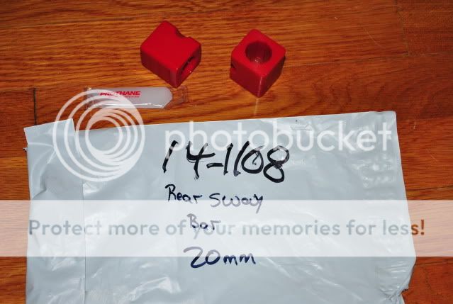

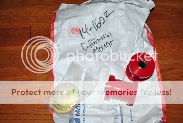

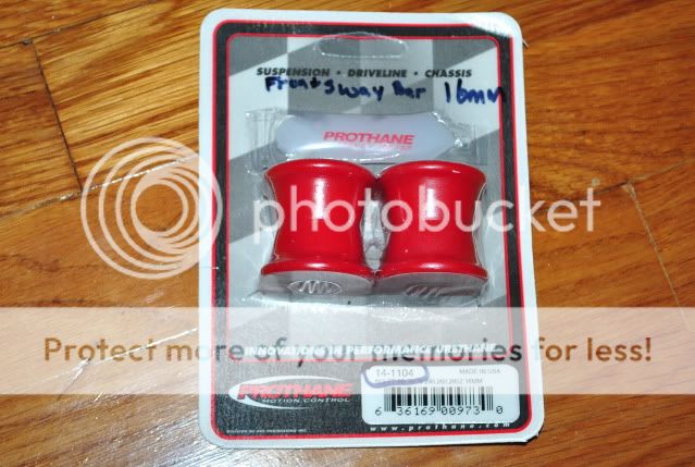

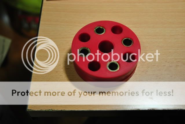

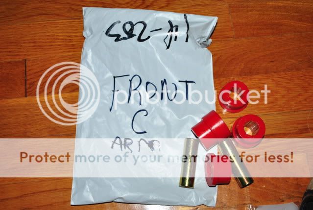

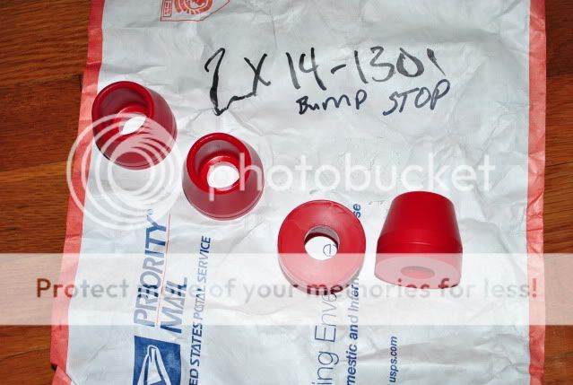

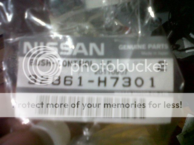

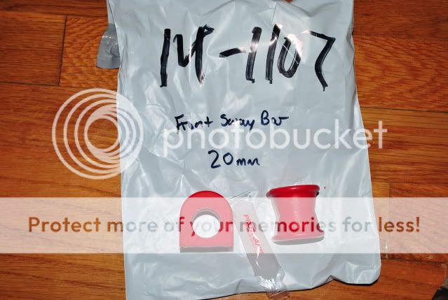

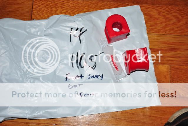

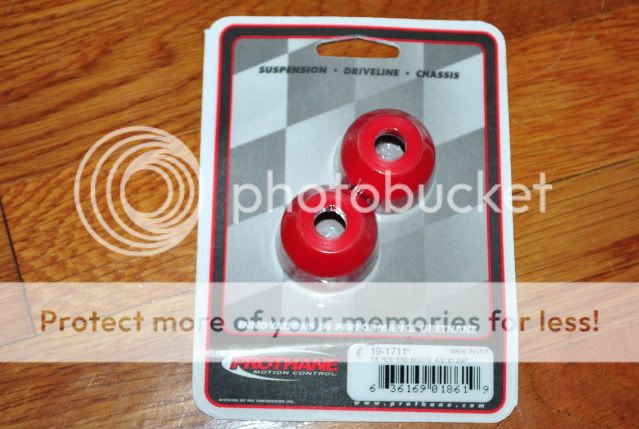

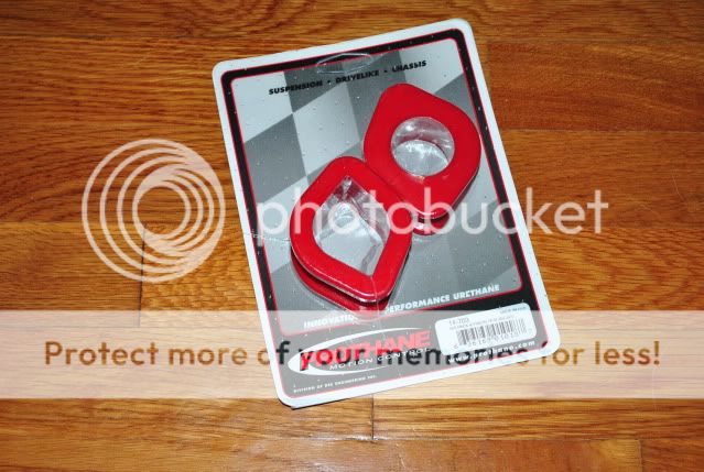

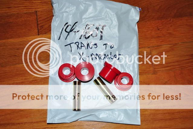

Got my Poly Urethane bushings. Only installed the transmission mount bushings so far. I think they are super bad ass! But I know they will squeak like hell' date=' soon. Here are some pics of the set that I got from ebay. They are awesome and the shipping was ridiculously fast.
[img']http://i604.photobucket.com/albums/tt124/makaofox/280z%20pics/PolyUrethaneBushingsfor280z001.jpg[/img]

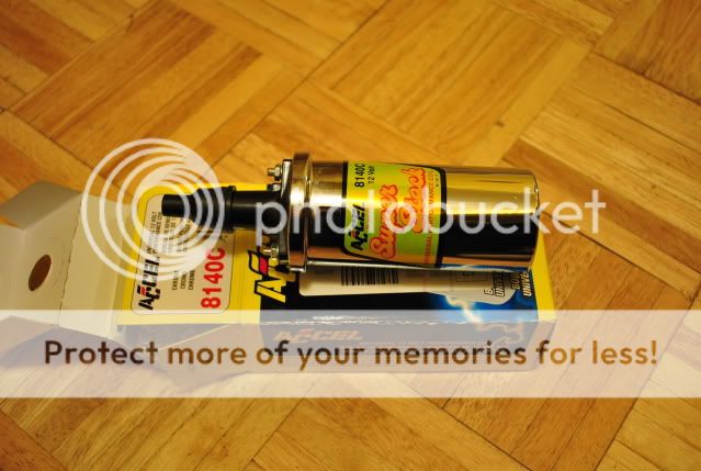

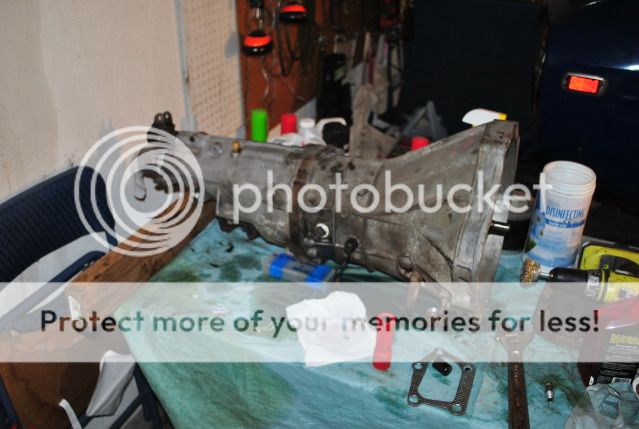

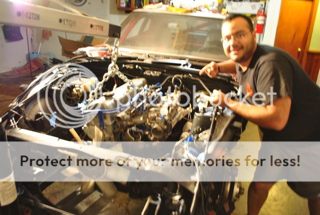

Got the stage 1 clutch and oem flywheel in, along with the gaskets and ignition coil. Still missing the 280zx brake master cylinder, which should come next week.

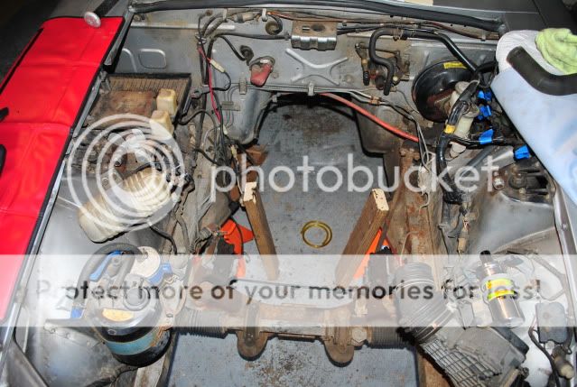

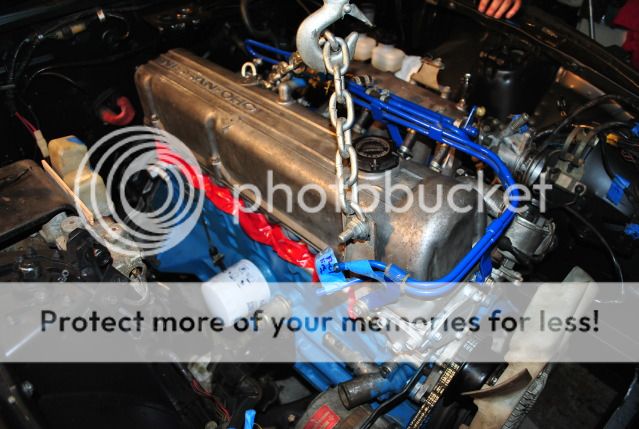

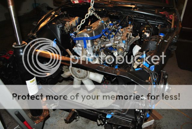

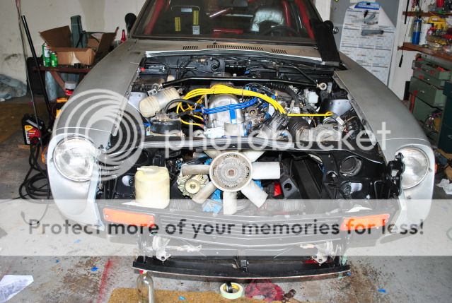

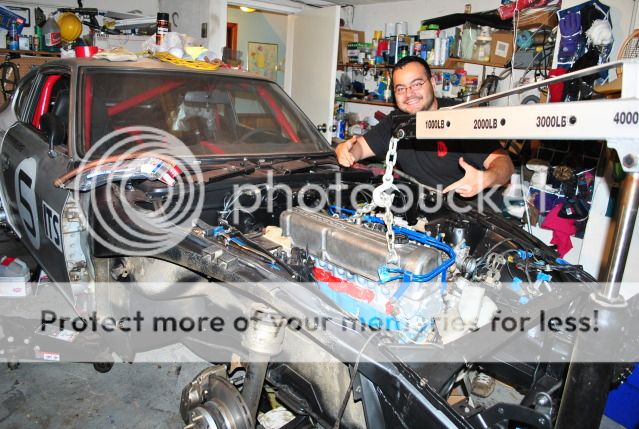

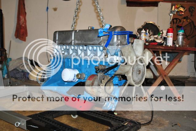

Today Me and my father pulled the motor, it wasnt soo bad, but putting it back in fully dressed with the tranny will not be easy. We have to drop the car roll it out, then roll it in and rejack it....sigh*.
Cleaned up the block since it was out, and now its pretty clean. All I need are a few fuel line hoses, vaccum lines, radiator plug and it should be good to go. Still need a battery but its coming along.
Im not going to paint my block, currently im concerned for my engine bay and the undercoating issue. Any suggestions?
I saw the duplicolor undercoating and after a few months it will wear out, unless you do several coats. Im not looking to spend a fortune but I would like to have it prepared for the day I do the full on restoration. (which might be a few years down the line)
I have been reading up on, 3M, wurth and a few other cans. I am liking 3M because its around $10 a can as opposed to $20 or the duplicolor at $3.
The engine bay really just the frame rails are starting to chip away paint and I just want to stop it before it rusts.

Well its been awhile but with the motor out I have decided what I wanted to do and that was to paint the bay semi flat black. I used probably 4 cans and it came out pretty dam well. Of course being a rattle can paint job it doesnt have the same quality compared to professionally painted. I just sanded down the rusty spots in the bay and painted it. The tough cookie was getting into those hard to reach area's like where the master cylinder is and the clutch master clyinder is. I did the best I could and came out pretty well' date=' I do have some drips but I will fix that later on by sanding it and painting it again. I did use a primer that eliminates rust, so lets see how true that is lol.

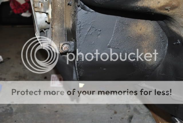

While painting I went out and brought undercoating. I used 3M underseal as well as rubberized undercoating and for the price ~$10 per can they are well worth it. I basically spayed on the well known area's to rust and some time when the car runs I will under coat the undercarriage. I undercoated my gas tank and it practically looks brand new!
I have since worked on the intake manifold and replaced all the hoses. (that was a b!tch but I got them all replaced), then I brought a header to eliminate the spacer issue when I bolt it back on.

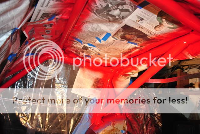

The roll cage received an experimental color, went with red! So I think im going to paint the whole cage red because it is really nice. Meaning down the line I will replace my blue seats for red.

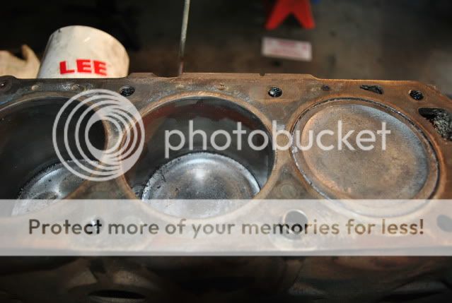

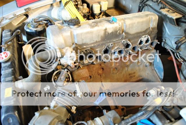

Well tearing the motor down I come to find that the head was nice but the cylinder walls are some what rusted. So I think im going to buy a master rebuild kit for about $600 and rebuild the motor and just poloish up the block. Being my first time doing any of this it should be fun learning. y goal at this point is remain in budget and just have a nice peppy z. My long term goal is to have a 1jz in the z and keep it at a moderate 400hp, which is more than enough. Im just looking to get the L28 running for a good while and have my fun with it.

^ Took care of that nasty rust spot! I grinded it down, and it looked like swiss cheese! At the moment I just coated the crap out of it and it looks much better. Down the line I will weld it up properly but for now it will be more than fine.
^ Another angle. This is the rustest part of my z, and the one frame rail that was scrapped. (isnt rotting through the body just the bottom part) So that is taken care of the body is in amazing condition! I am very happy with that.
^ Coated the gas tank as well and it looks awesome! Almost new!

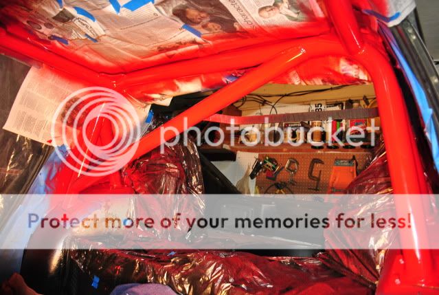

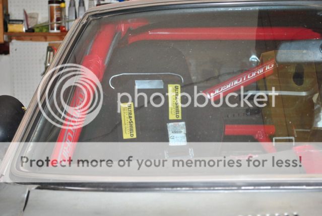

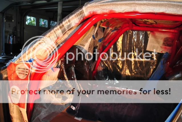

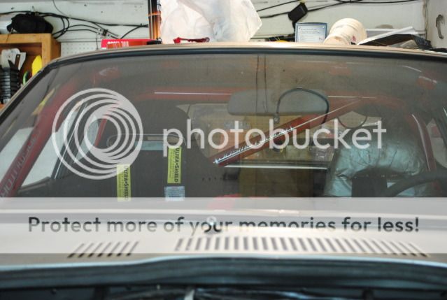

Painted my cage, its REALLY hard with it still in the car. So hard I have drips galore lol. I dont care though, as long as it doesnt rust again. Im going to sand it and give it another coat and then clean up everything else. Since part of the interior is now red lol. Some area's of the cage are ON the body of the car, I cant even get a thin piece of paper between the body and the cage. This was a nice cage but man did they do a tight job.
These guys are still waiting to be united with their best bud mr.L28 T___T. Hopefully I get the motor in January, as by then I'll have the brakes all done, and the gas tank back up. All I need is a hose for the gas tank and a master cylinder from a 79-81 280zx. I can get one but its almost impossible to get another or even a rebuild kit!
This is how she sits now, waiting...

Working on all the bushing I did the Front control arms, radius rod (found that it was already upgraded to a ball and socket upgrade so only needed to use one poly bushing), I did the mustache bar, trans mount and im waiting to see if I should do the sway bar end links. Since I have a different set up might not even use it. The whole bushing install went smoothly but its tiresome!
Some pics of the mustache bar
[img']http://i604.photobucket.com/albums/tt124/makaofox/280z%20pics/IMG00059-20120219-1751.jpg[/img]
and then when I cleaned it up:
Im thinking about getting a diff mount the GM one, I heard they were like $20.
Prepared some of the parts I took out and painted them.
I got a 5sp from a local guy and its pretty nice, I brought brass bushings for it:
^ $5 for though and one fits like a glove and this
Is the nylon piece, mine looked worn so I replaced it for $15.
After installing the bushing and the nylon piece I put it on the trans and DEAR LORD the transformation is night and day! I cant drive the z yet but I know she will feel good while shifting, none of that typical sloppiness.

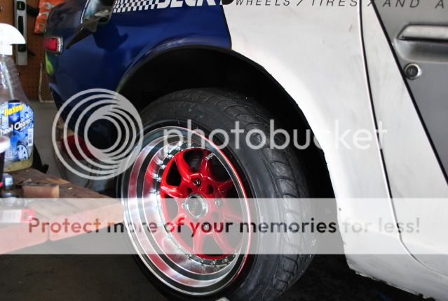

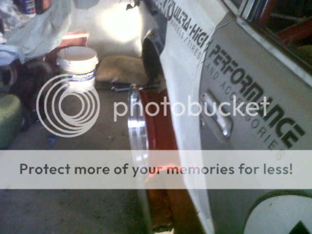

What she looks like with the spacers and wheels. Plan on getting xxr 002 15x9 all around to hold me over. I might sell these panasports.
All thats left at this moment is adjust my MC (wilwood 1in mc) bleed the brakes, add fluid to the diff and tranny, and drop in the motor.

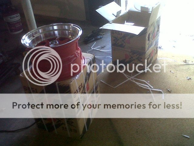

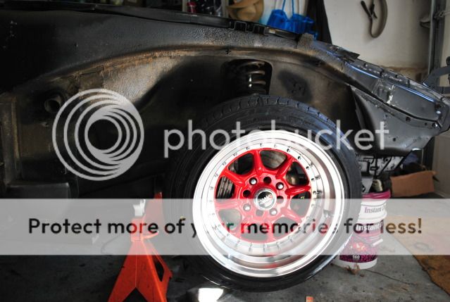

I Ordered a crap load of stuff!
Wheels: XXR 002 in red 15x9 all around, 0+ offset.
Tires: FALKEN ZIEX ZE-512 205/50/15 all around (has a nice stretch too them, nothing crazy)
zg fender flares
bre style spoiler
front spacers: 15mm

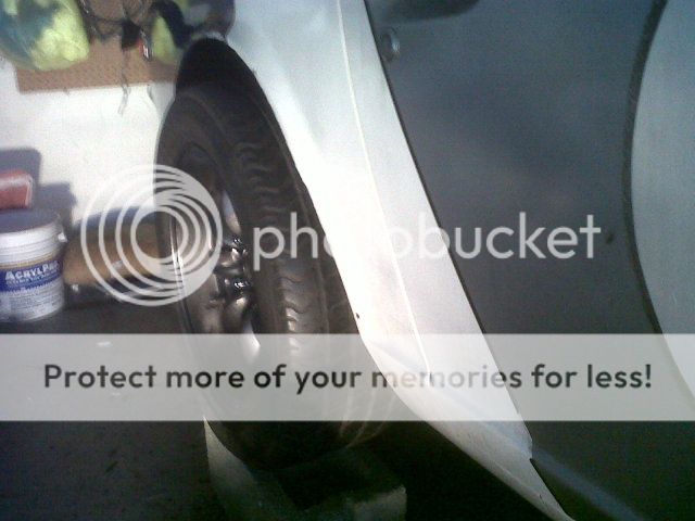

Rolled all 4 fenders and what a PAIN in the toosh that was! Paint chipped even though the heat gun was applied properly. Its ok and then a chunk fell off because it had bondo. Im not mad, just painted it black for now to prevent it from rusting.
Now onto the pics!
[img']http://i604.photobucket.com/albums/tt124/makaofox/280z%20pics/DSC_0514.jpg[/img]
^ Tires new that I ordered from ebay. Not a bad deal.
^ Looks SO much better than what I had thought, it really compliments the cage.

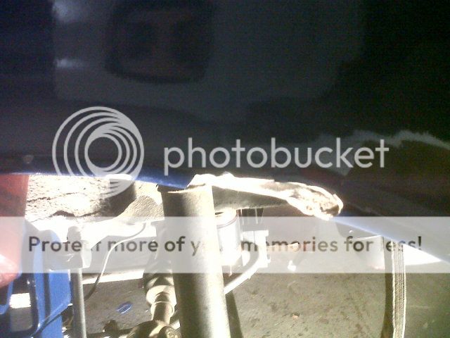

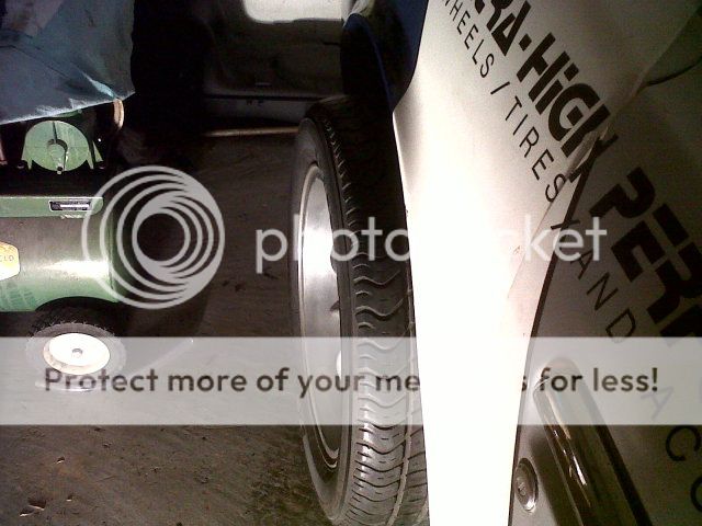

^ Thats the reason why I need a 15mm spacer lol! 15 is a bit excessive but I need something with studs. It should push it out a nice bit and will look great with the zg flares.
^ The area where the bondo came off. Looks like the tire ripped into it and totally Fed it up lol. They did good covering it up.
^ Cant wait till she is on the ground!

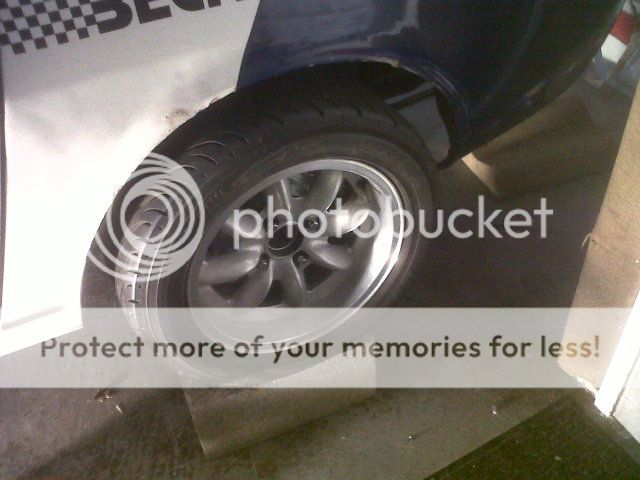

Here are some of the old panasports, still trying to sell them. I had a few bites.
I loved the old wheels but compared to the panasports the xxr's are so much nicer and surprisingly so much lighter! 16lbs each!!

Put some foam on the roll cage as I KNOW I will be hitting it a few times lol.

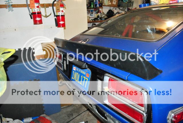

Then my air dam, spoiler and zg flares came in. Mocked up the flares and spoiler today.
[img']http://i604.photobucket.com/albums/tt124/makaofox/280z%20pics/IMG00094-20120328-1308.jpg[/img]
240z xenon urethane airdam. Didnt have the fenders bolted up but it came with all the hardware, so thats going to be a blast to try and fit. I think ill have to reinforce the bottom too as it looks to me in high speed it will be flimsy. So I might just make an aluminum splitter just to prevent it from flexing. Still on the lookout for a decent pair of 240z turn signals. I think im going to keep the 280z grill and turn signals for awhile not sure yet. Here is a pic to help you see what I mean..
Mocked up the spoiler that was easy, doesnt fit 100% but I dont expect it too. Not sure if I should give it that space from the edge of the hatch or get it right up against the hatch? Opinions??
^ Gap or no gap?
Got 4 zg flares from ebay made from fiber glass. They dont fit 100% either and I didnt expect them too but they look nice. I think im going to paint them black, along with the spoiler. I still need the rubber welting. it came with the hardware to bolt it up. I think they will look great with the wheels but I dont want to do the flares just yet. I think Im going to wait until the winter to do them.
^ They are taped and I already maked the area of which to drill. I still need to mark where to cut and then I would have to weld them back together. Again I taped it but I think I will hold off on doing them, not sure 100%. It depends how the motor goes in and how anxious I am to drive lol.

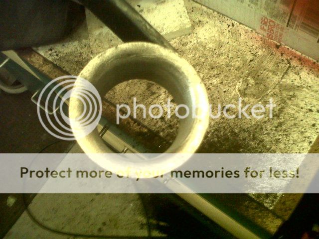

In the mean time me and my buddy wanted to do something to make the car stiffer. So We welded a strut tower bar in the far to look like this:
And here is our result, its still not done, need to grind it down reweld a smother bead and paint it.

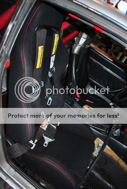

I have a question about my seatbelt position. Is this an OK SAFE set up? To mee it looks safe and it came like this when I brought it.
Last but not least ordered me a red ZCCNV shirt :D To add to my z collection.
LOL! Yea sorry about the long read. I was doing all this work since october. But thanks man :)
I guess in the 80's the positioning of the seatbelts didnt matter? I plan on moving them to the strutbar. Now im going to have 4 holes in the chassis to plug up, but atleast I know if anything were to happen I would be safe.

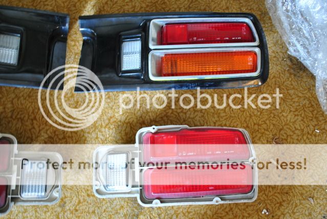

I brought some euro tail lights for the z and installed them today. I love the euro tails, they give it a bit more of a modern touch :) Enjoy:
v stockies are for sale $200 + 12 shipping.
What I added better pic:
euro tail also for sale, not the best condition:

Welp got my motor yesterday 6/1 and after a 6month long wait, I was eager to swap it in that day. Pretty much it was straight forward, with all the goofing around and lolz we had still only took us 12hrs to do. Now all that is left is to get a starter, perhaps and alternator because I would assume it would be stot as well and maybe (but im really hoping not) a distributor. If it turns out my alt is bad I think im going to upgrade to the 86-94 maxima 90amp alternators, just to have that extra 30amp coverage.
Now today just have to wire it up, bleed the brakes and then see what breaks lol.
Oh warning and I learned my lesson: Do not fill the trans BEFORE you install her, she WILL leak all over the place! I learned the hard way thinking 'Oh should be so much easier since its out the car' NOPE! All I did was make a huge mess 4x! Had to put serveral gloves to save myself from slipping and dying -___-. Lesson well learned its easier just to do it and suffer under the car lol.
ANOTHER LESSON: THE MOTOR MOUNTS HAVE A SPECIFIC LOCATION. The driver side with the intake and exhaust manifold has the longer mount while the passanger side with the spark plugs has the shorter mount. DO NOT CONFUSE THEM. Lucky we caught it early on and didnt suffer to much, but it was a pain to switch them.
peekchure time!:
^ My friend jon's 2012 speed3, fully bolted and big turbo. Pretty did it all at my house lol. Thing is a pain in the ass, I like the z better.
^ we were scared the headers would get in the way of the trans, but it cleared. I love the headers, still dont have an exhaust though.
^ 5speed trans.
^ Both mated together.
^ The mounts DONT MIX THEM UP. As you can see the difference.
^ Almost seated!
^ Shes staying that way! Open headers! :burnout:
^ Shes in!
^ Jon is happy its in, after a 6 month long wait for this dam motor lol.
^ Now to finish it up and get it running soon for the June 17th Nissan meet here in middletown,nj :thumbsup:

^ Stock steering wheel, eww. Hope to change that some day. For now its good and isnt broken or warped.
^ Love my seats. Oh i still have to put in the driver side. I have just been busy with other parts of the car. Hope to get that in this weekend.
Love my red cage lol.

^ Thanks! And so did I :( But the design of the panasports wouldnt fit over the larger calipers. The XXR have more of a flatter design and even then they BARELY fit. The panasports had no chance of fitting. But I am still happy and I sold them to a fellow z member in california, who is putting them on his 240z. So to me its a win win :)
