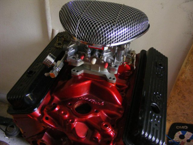

daflyinghawaiin Posted May 24, 2012 Share Posted May 24, 2012 ALOHA GANG! IM VERY NEW HERE AND HAVE BEEN SEARCHING FOR DAYS TO FIND ANSWERS TO MY QUESTIONS. I HAVE RECENTLY AQUIRED A 1983 280ZX FROM LAS VEGAS. SHE IS IN SIN CITY Z CLUB AS THE WINDOW STICKER SAYS. HOWEVER..I AM HAVING A LOT OF DIFFICULTY FINDING THE RIGHT SPOT I SHOULD SAY FOR THE ENGINE TO RUN RIGHT. I GOT IT FROM MIKE A FRIEND HERE IN HAWAII THAT HAD HER SHIPPED OVER WHEN HE MOVED HERE FROM VEGAS. THEN SHE SAT FOR 4 YEARS. IM NOT A TURBO GUY AND NOT A "REAL" IMPORT GUY AS WELL. BUT IVE ALWAYS WANTED ONE OF THESE AND NOW I HAVE HER! SHE IS FEATURED IN ONE OF THE MOTORSPORT MAGAZINES YEARS AGO. SHE IS ALSO IN OTHER WEBSITES THAT I HAVE NOT HAD THE TIME TO RESEARCH YET. SO.....MY QUESTION IS THIS. I HAVE ACCESS TO A FEW SBC ENGINES AS I AM A CHEVY GUY. AS WELL AS TRANSMISSIONS TOO, TH300 TH400 700R4 AND SO ON. HOWEVER...I WOULD LIKE TO KNOW IF THERE IS A BELLHOUSING ADAPTER PLATE TO MOUNT A MILDLY BUILT SBC 350 TO THE STOCK 5 SPEED TRANS IN THE 83 280ZX? IF NOT...WHERE CAN I START TO FIND THE PARTS I NEED? I CAN FABRICATE AND WELD TOO SO IM NOT TOTALLY MINDLESS HERE BUT IM NOT AN IMPORT GUY TILL NOW! I LOVE THIS CAR! WANTED ONE SINCE THE OL DAYS IN HIGH SCHOOL IN THE 80'S. OR IF SOMEONE CAN HELP ME TO GET THIS BUGGER RUNNING RIGHT THAT WOULD ROCK TOO! SHE HAS A FRESH ENGINE BUT ITS BEEN SITTING LIKE I MENTIONED. TURBO RUNS AND BUILDS PRESSURE...WASTEGATE IS ENORMOUS! SCARES THE CRAP OUT OF SOME PEOPLE. BUT IT RUNS GOOD WHEN COLD THEN REACHES ROUGHLY 180 DEGREES AND SPUTTERS OUT AND EITHER IT IS FLOODING OR SOMETHING CLOSE. I CAN SMELL GAS WHICH MAKES ME THINK FUEL LINES HEATING AND CRACKS START SUCKING AIR SO FUEL PUMP KEEPS PUMPING! I HOPE IM CLOSE. BUT..THIS CAR NEEDS HELP AND I WOULD LIKE TO KEEP IT ORIGINAL AS POSSIBLE...BUT, I AM ALSO WILLING TO DROP A SBC IN IT. SO...PLEASE FEEL FREE TO HELP A HAWAIIAN IN NEED! HEHEHEHE! MAHALO, DAFLY Quote Link to comment Share on other sites More sharing options...

emeraldlion Posted May 24, 2012 Share Posted May 24, 2012 I would look at getting the inline 6 running well before attempting the whole v8 swap. Like NewZ said, please turn caps off first. Try searching the FAQ section and turbo sections. Sounds like the airflow meter could be bad or need adjusting, inappropriate fuel pressure, bad lines, all the above. Try to work the bugs out before running it too much. If you have a fuel issue and for some reason run into a lean situation it could make mean you would be swapping for that 350 sooner than you had hoped. If I had already had a turbo swapped car I probably would have stuck with the turbo 6. I was looking at a swap either way, and chose to go the sbc route. Quote Link to comment Share on other sites More sharing options...

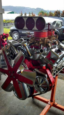

daflyinghawaiin Posted August 7, 2013 Author Share Posted August 7, 2013 I do have several transmissions to choose from with the conversion. I have access to th350 and th400 also have several 700r4 as well. i have been contemplating the 700r4 due to the overdrive in 4th gear for long runs. But, i think it will need a lockout true? Have 350sbc with a mild cam and stock heads. Also have a 406 stroker that is just nasty! ran 9 sec runs in a vette before i pulled it for the conversion. thanmks again< BOLO Quote Link to comment Share on other sites More sharing options...
daflyinghawaiin Posted August 7, 2013 Author Share Posted August 7, 2013 (edited) Some tell me that there is a place to get the mounts besides jtr. I would love to see them if at all possible please? I also did some s10 conversions so i have some extra engine mounts for that. I think it is very close to what i may need for the swap? Please inform. The engine in the car is supposed to be a freshly rebuilt motor. But it will not start and run completely. When i first got it it started and idled ok. But later after stored in the garage it did not start again. So it sat. Now i either need to go through the entire engine system which i really am not in my comfort zone as im a chevy guy. So im kind of in need of some serious tutoring. BOLO Edited August 7, 2013 by daflyinghawaiin Quote Link to comment Share on other sites More sharing options...
