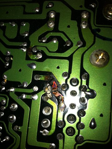

bsmuwk Posted August 19, 2012 Author Share Posted August 19, 2012 opened ECU, had a burned joint on the board. resoldered, car runs. life is good. Quote Link to comment Share on other sites More sharing options...
MazerRackham Posted August 19, 2012 Share Posted August 19, 2012 opened ECU, had a burned joint on the board. resoldered, car runs. life is good. Lol. Don't you love it when everybody is like dude that's totally not the problem, and lo and behold that was the problem. Excellent job fixing it! Hope you took a picture of the problem joint so we all know what the symptoms and solutions are! Quote Link to comment Share on other sites More sharing options...
NewZed Posted August 19, 2012 Share Posted August 19, 2012 opened ECU, had a burned joint on the board. resoldered, car runs. life is good. Which one and what does "burned joint" mean? Did you have a short between two components in the ECU or an open circuit? Pass on a little good information for the next guy. Quote Link to comment Share on other sites More sharing options...
bsmuwk Posted August 21, 2012 Author Share Posted August 21, 2012 Lol. Don't you love it when everybody is like dude that's totally not the problem, and lo and behold that was the problem. Excellent job fixing it! Hope you took a picture of the problem joint so we all know what the symptoms and solutions are! It's just one of those deals I suppose. Nothing to say but, "Go Figure" lol i have a picture of the little joint. i'll put it up here as soon as i get it off of my phone. Which one and what does "burned joint" mean? Did you have a short between two components in the ECU or an open circuit? Pass on a little good information for the next guy. my definitions might be slightly skewed from the norm, but on backside of the motherboard a burnt joint between the two components was my issue. maybe a picture will suffice better than my poor descriptions. all in all, just looking for spare ecus to keep around Quote Link to comment Share on other sites More sharing options...
